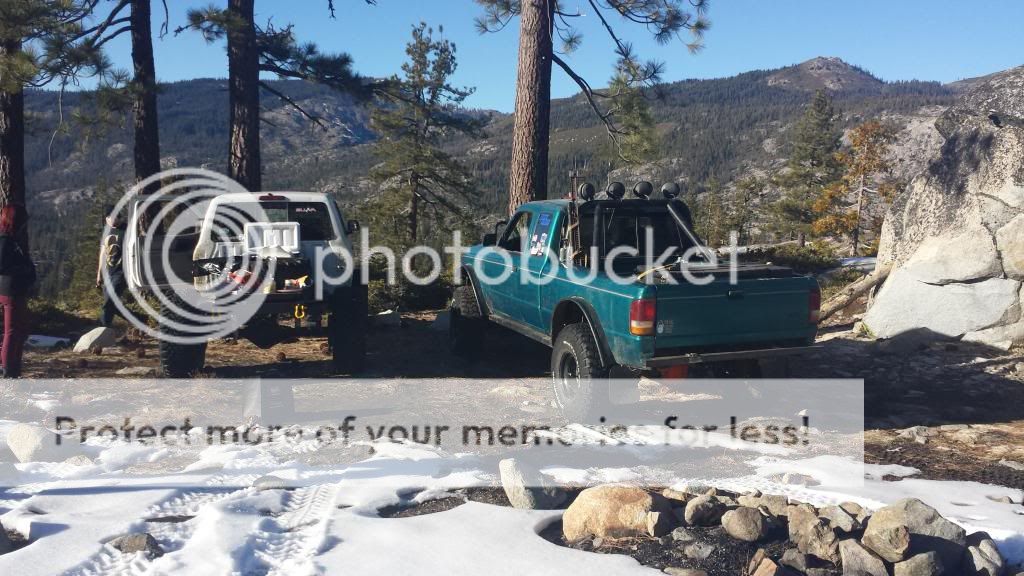

I was very satisfied with how she performed. I skipped a few really rough sections because this was more or less my first real trail since the SAS. I hit the sliders a few times and landed it pretty hard on both the link mounts and the radius arms themselves more than a couple times. The radius arms held up great without any bending. The gears were almost perfect and got me through a lot of places I struggled before and figured I would have struggled more now even with the SAS. I hardly ever wanted for a lower gear, but a lower gear couldn't have hurt. Sometimes I could have done with some better shock control, but all in all it was pretty stable as well. The only real damage I did was I bent the lip of one rim when my front tire slipped off it. It still holds air though so I'm not horribly worried about it. My truck finally looks used.
beautiful scenery:

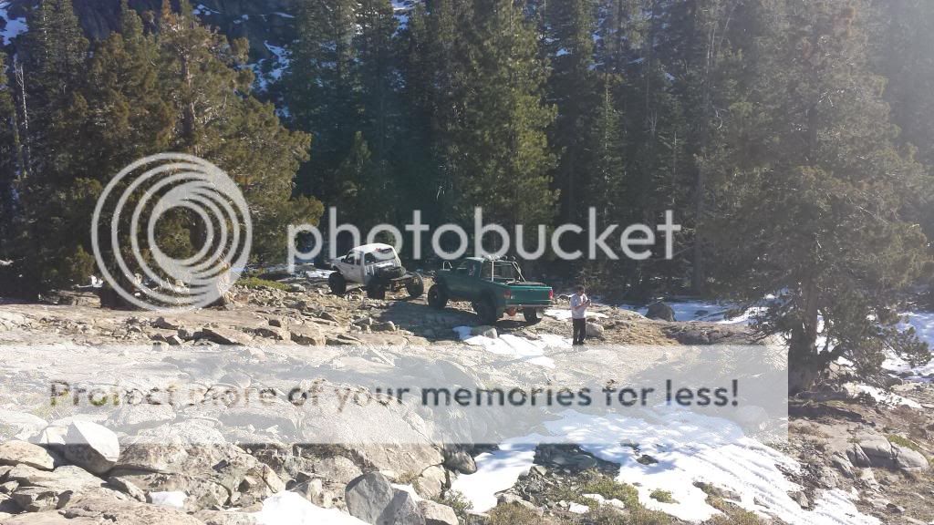

I only got a couple videos, and they were in kind of random spots, not necessarily the most difficult spots.

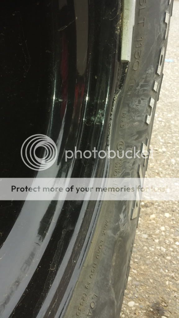

Ive been doing some miscellaneous stuff on my truck and keeping my eye out for damages from last weekends wheeling. Pretty much everything under my truck is scraped/gouged up, but pretty much just that. Nothing is bent or broken, except for my passenger side front rim which I bent the lip of at Fordyce:

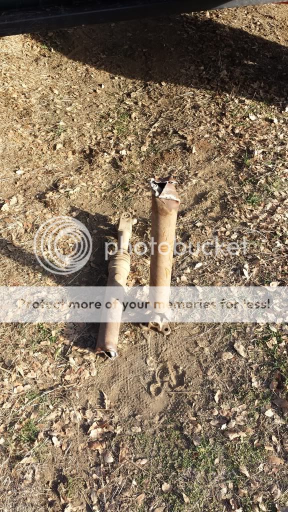

and obviously my driveshaft that I broke.

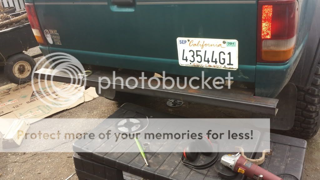

Here's another picture of my rear bumper that I whipped up the night before I went wheeling:
dhkonrad's 93 ford ranger
Its 2x6 .120 wall that I had lying over from my sliders. Nothing awesome, but it has a way better departure angle than the stock one. I want to make some minor changes, but Ill probably do them later on.

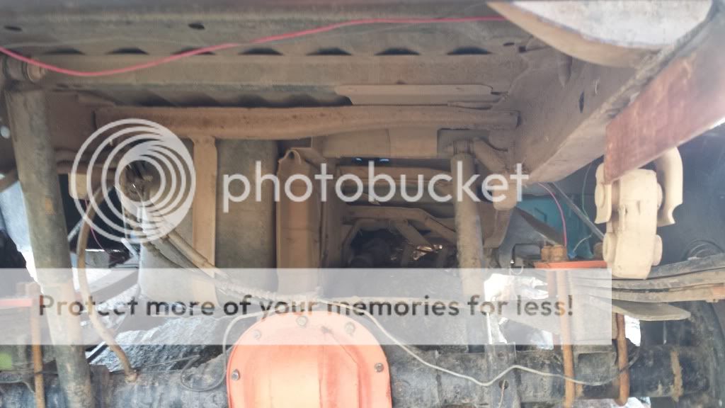

Since I broke my driveshaft, I figured now would be a perfect time to upgrade to a one piece

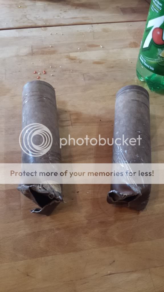

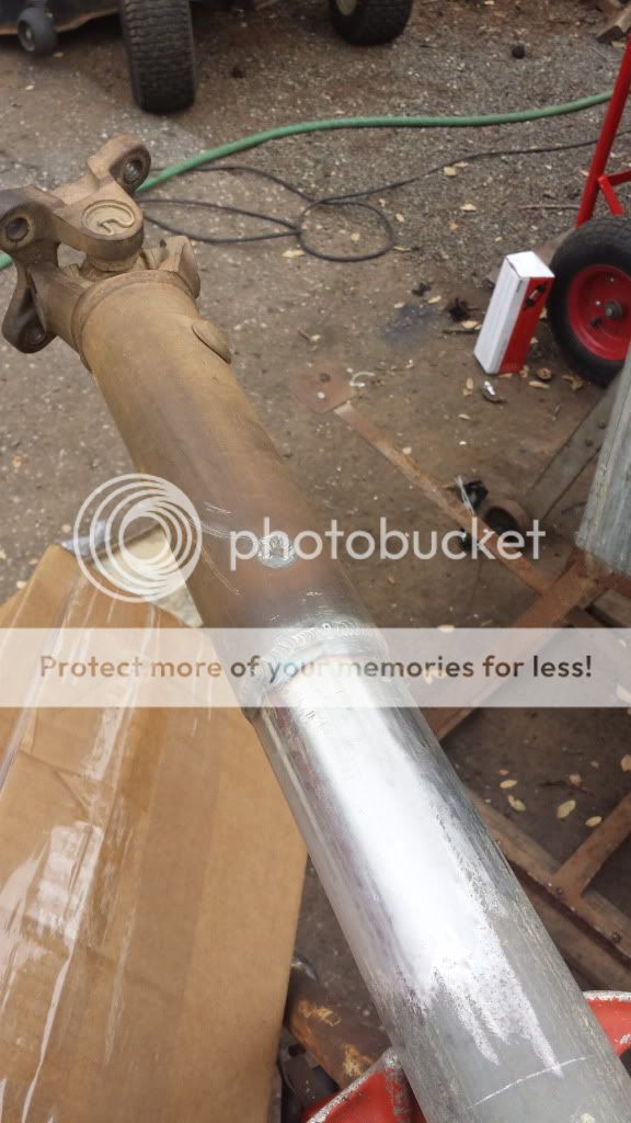

Also, I figured it couldn't hurt to have a spare/trail shaft, so I cup up my broken one and made another one.
I cut out all the parts that were bent/dented

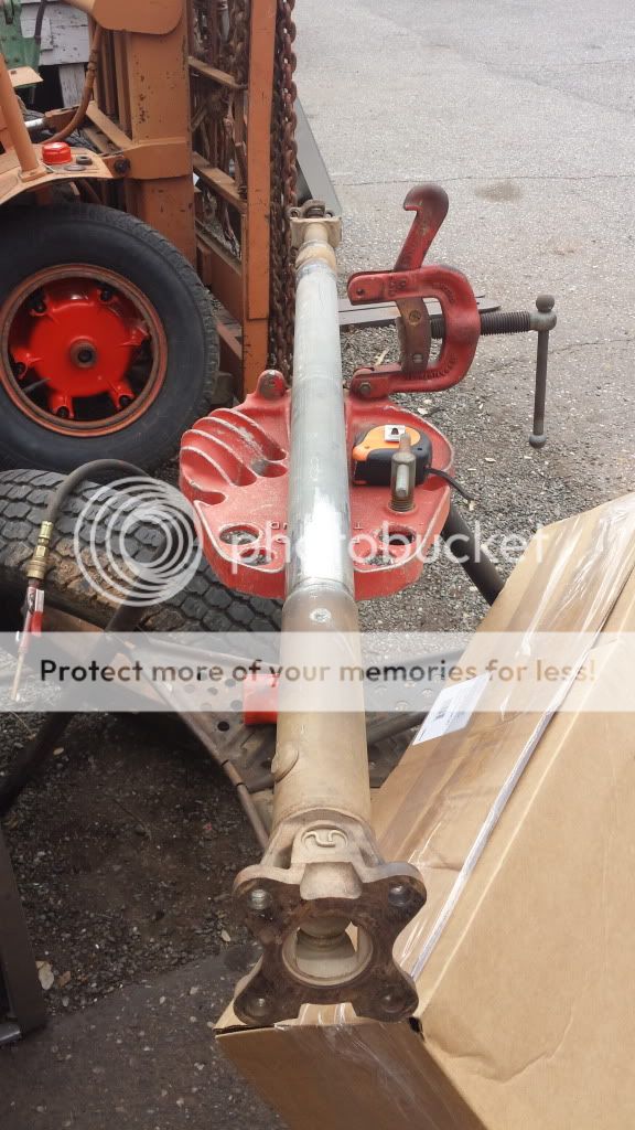

then took a piece of pipe that was almost the perfect size, just a little too big and sanded it down until I could use a deadblow to beat the pipe into the ends of the driveshaft and welded up where the pipe goes in and as an extra precaution I plug welded it.

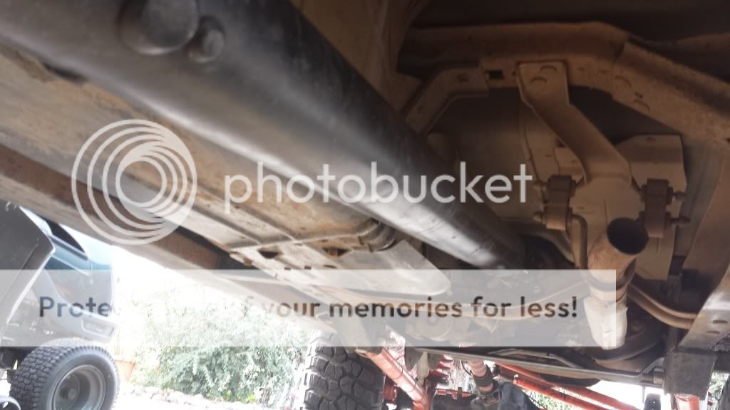

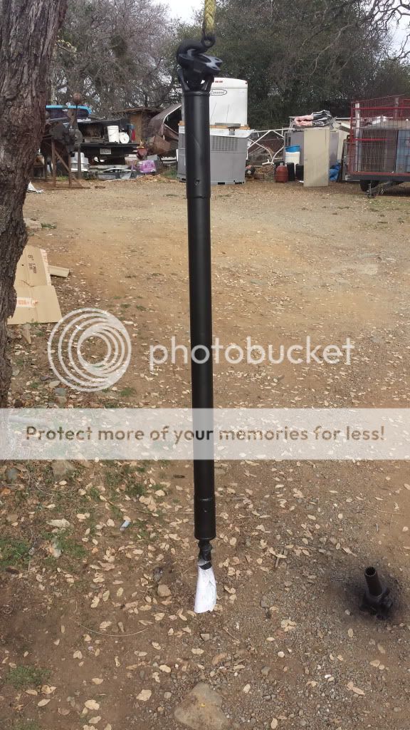

slapped a coat of paint on it and viola
seems pretty straight and should be way stronger than a stock shaft, so ill probably use it as a trail shaft and just swap it in when I get to a trail so I don't beat up my DD shaft.
Personally i would have stood the rear bumper up on its edge and recessed it in like a roll pan. Less protection to the corners but it would look better to me.
