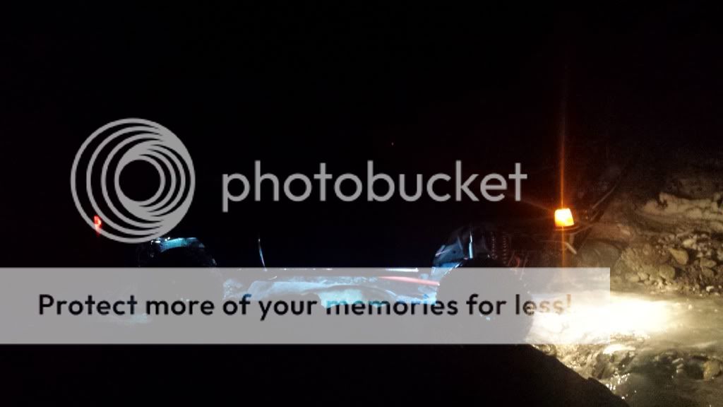

Did a night run night before last. I am loving my truck!

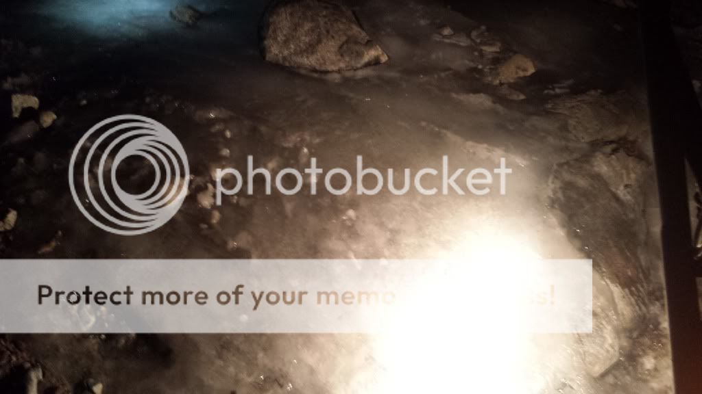

Since it was dark I didn't get too many pictures, but it was a blast. Stupid amount of ice though
This is how most of the hills looked
not just ice, but 5" thick ice. It was hard to walk on the trail, let alove drive on it.
I really only struggled on one section, but it was a long section and probably took .5-1 hour to get through it. I am in desperate need of at least one locker, and I need to take a hundred feet or so of cable off my winch because I kept maxing it out way too easy.

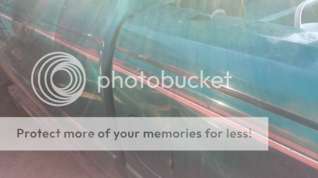

did sustain my first body damage though :'(
not bad, but there nonetheless

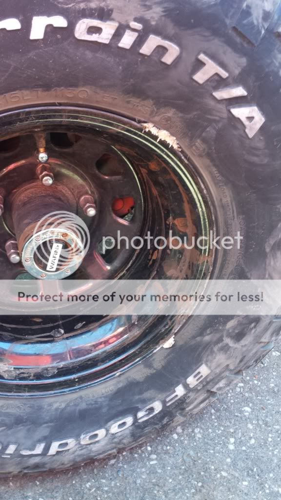

also managed to get wood in the bead somehow :dunno:

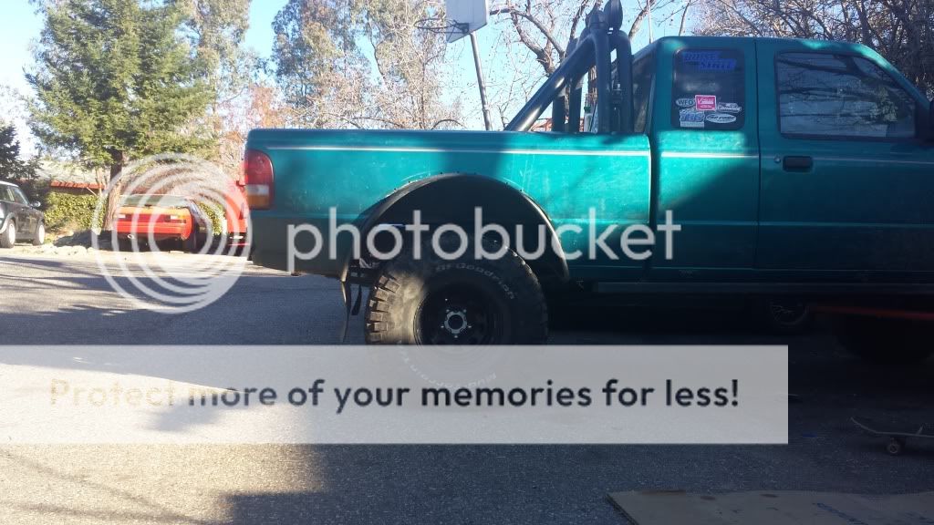

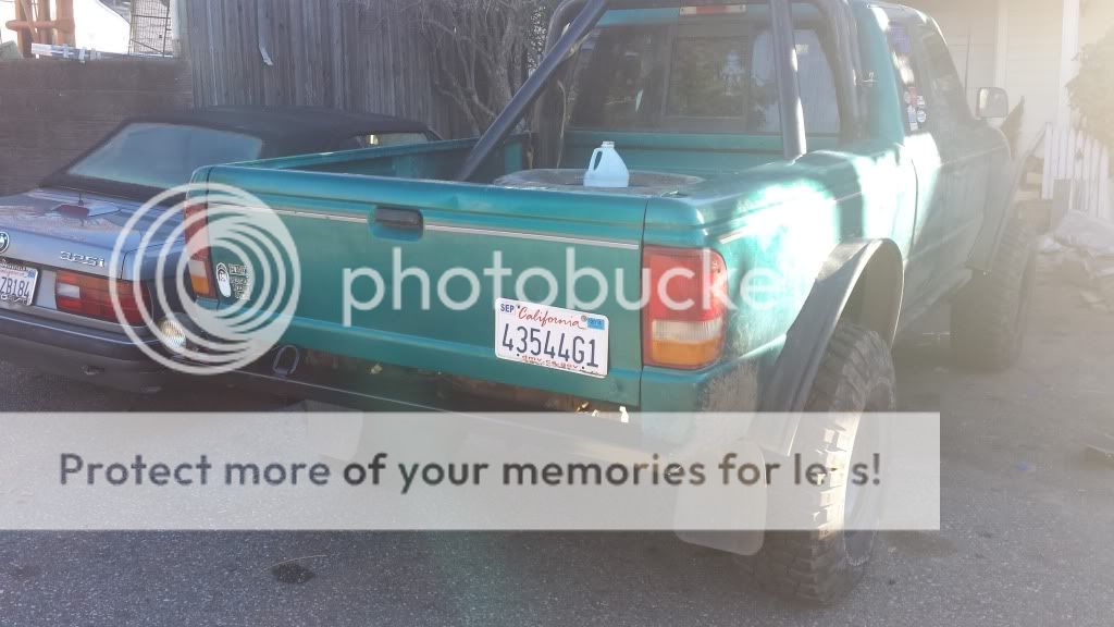

Also slapped a coat of paint on my rear bumper finally.
I just used some gloss tractor paint I had lying around because I can brush it on and not mask. I have always painted everything in flat, but I kind of like the gloss, I'm not gonna lie. I may have to start repainting black parts on my truck...
Sent from my SCH-I545 using Tapatalk
