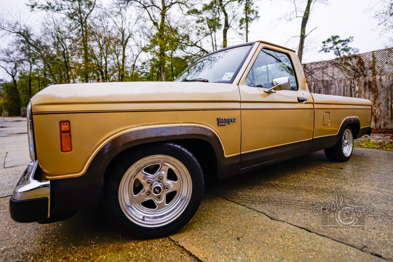

So my Ranger I believe has 3.73 gears. I’ve got a FM132 and 2.9. The truck has a good bit of torque under 45 mph. I cruise on the highway at about 2500-2700 rpms, ~ 60-65 mph. I don’t care about low end torque at all. I’d like to be able to cruise at least 75 but wouldn’t mind 80-90 mph. (All suspension is new, it’s very low and handles great). Tires are 225/55-15. 8 inch wide, Billet Welds. I need to be under 2500 for long drives. I am planning to drive cross country this summer and need a solution.

Not sure if you looked. But the tire size he mentiined is only 24.7" diameter. I think he'd be ok with a gear change on those Hot-Wheels tires.
I dunno bout that .... These hot wheels look pretty beefy...
I think I buggered up my conversion
24.7 sounds about right, they don’t look like the wheels he sent.
