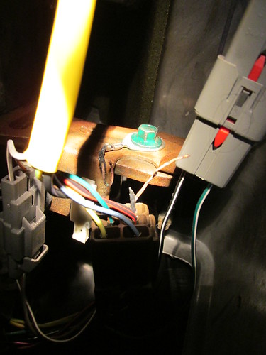

Said I'd try to put up some pictures, so here we go.
This one is the wire that burned through under the dash:
Dead Battery - Jump Start - White Smoke!
So the bolt right in the middle of the picture is where this ground/fusible link connects to the dash support frame. The wire goes to the left, then down, then back up (in the picture). The other end is coming out of the connector at the bottom-middle. You can see what's left of the insulation sticking straight out of the connector, and what's left of the wire heading to the right. The yellow wrap goes around all of the wires heading up to the ignition switch, except the two on the right, which are part of the anti-theft system.
This one shows some of the damage to that anti-theft system wire. It looks like that all the way up to the ignition switch, but doesn't seem to have burned through anywhere.
