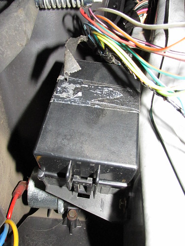

This one has the parking light relay. To find it, you want to lay on your back on the floor mat, with your head hitting the gas pedal, and look up and toward the cable for the gas pedal. The spring at the very top of this picture is at the top of the gas pedal. The box itself is a rectangle, but notice that the back of the thing is narrower on the left and gets wider to the right. That's the only way you can match up with the diagram for the relays inside.
