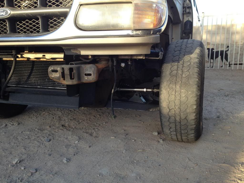

Since we will be doing a custom engine cage, we will not be reusing the DBR shock tower.

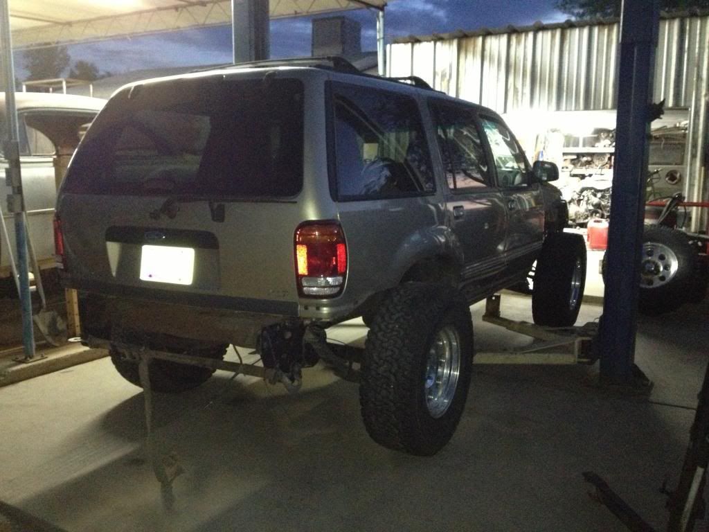

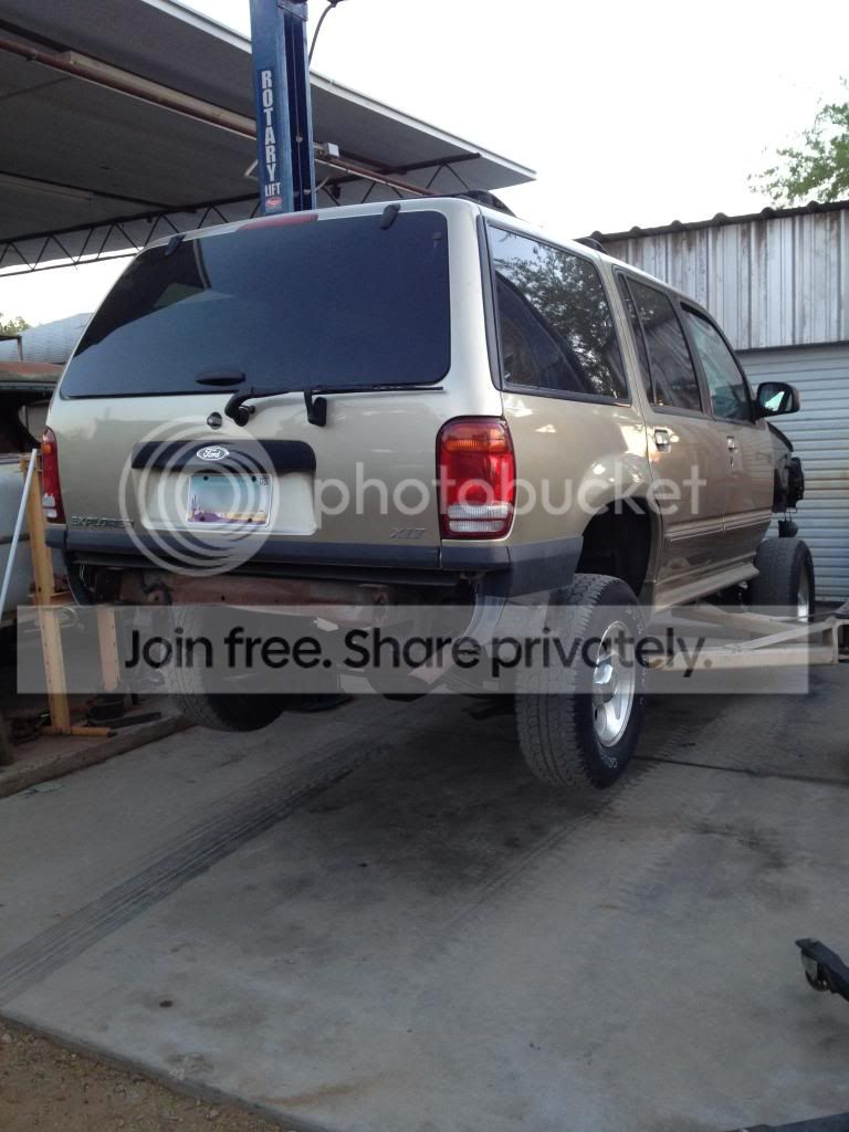

Explorer finally made it to the lift in preparation for the rear suspension tear down/64 kit mock up. Unfortunately the fabricator just left on a week long Moab jeep trip, so I will need to wait a bit longer to see any more progress.

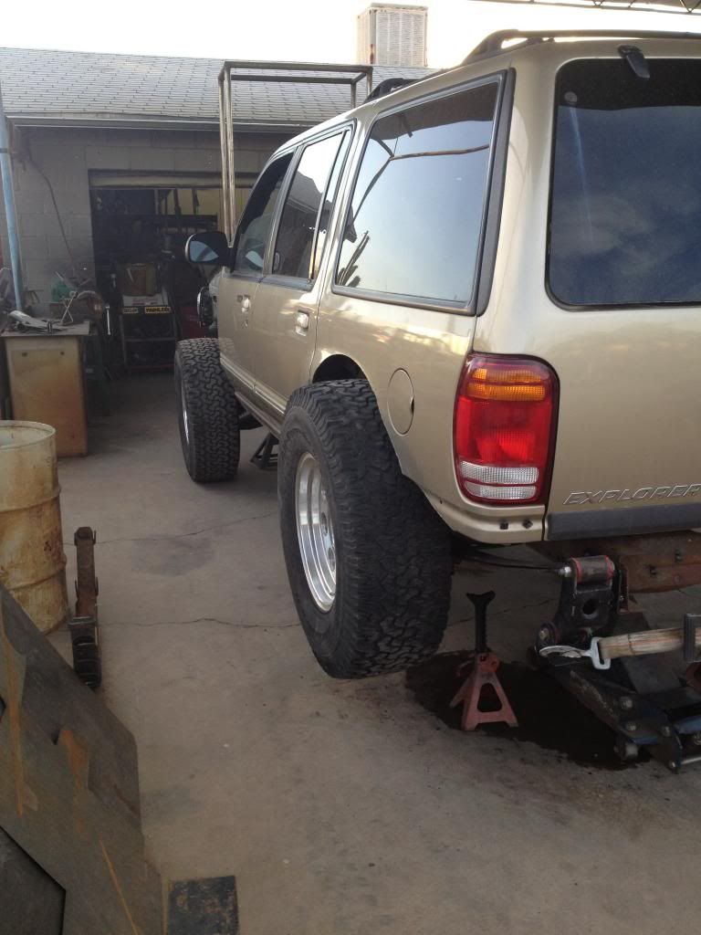

Fabricator is back from Moab. Giant 64 kit is mocked up and the Explorer is sitting on 35's for the first time. The hangers are only tacked in right now, the leaf pack still needs to get broken down so that the axle can be fully cycled. It is amazing what a difference a wider stance and 35" tires will make. Pretty excited to say the least.

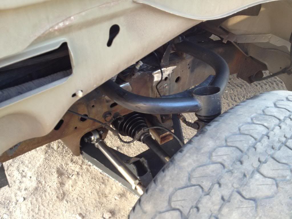

Gussets added to upper arm mount, and bypass shock mount added to lower arm (sorry for the blurry picture)
