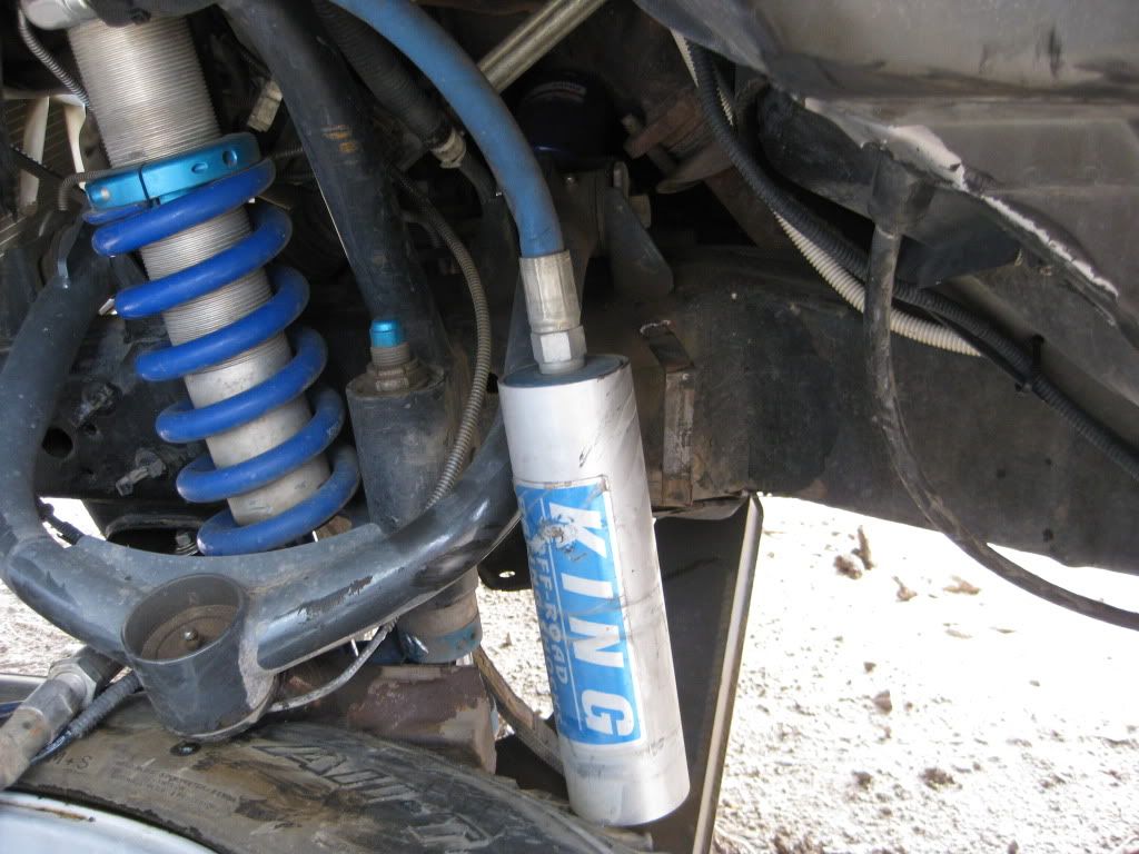

Here is a picture of my truck pre October 2010:
DBR/Giant 64 Ranger to Explorer
Specs:
2000 Ranger XLT 4X4. 3.0 V6
Dixon Brothers Racing (DBR) LT Kit
8" King Remote Reservoir Coil Overs
2"X2.5" King Hydraulic Bump Stops
Heim Steering
Giant 64 Long Travel Leaf Spring Kit
ADS 16" Triple Bypass Shocks
Ford F150 9.75 Axle w/ 4:88 Gears and Posi
Fiberwerxs 6" Fenders and Bedsides
6 315/70R17(35") BFG AT's
MasterCraft Baja RS Seats
ICOM Race Radio

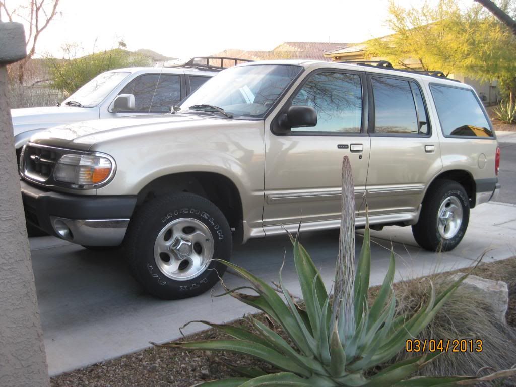

and, last but not least, the donor vehicle:
Specs:
1999 Explorer XLT 4X4, 4.0 SOHC
199K on original engine and transmission - still runs strong
Hopefully, I will begin to remove the interior this week and fabrication will begin within two weeks.

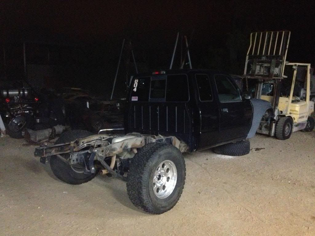

Moved what remains of the Ranger to the same location as the Explorer. Pack rats had made a substantial nest under the hood. It took over 1/2 an hour to clean all of the cholla and crap out of the engine compartment before it could be moved.
The plan for the following week is take measurements off of the Ranger to figure out how to adapt the 64 kit to the Explorer, and continue with the removal of the interior and front body panels.
