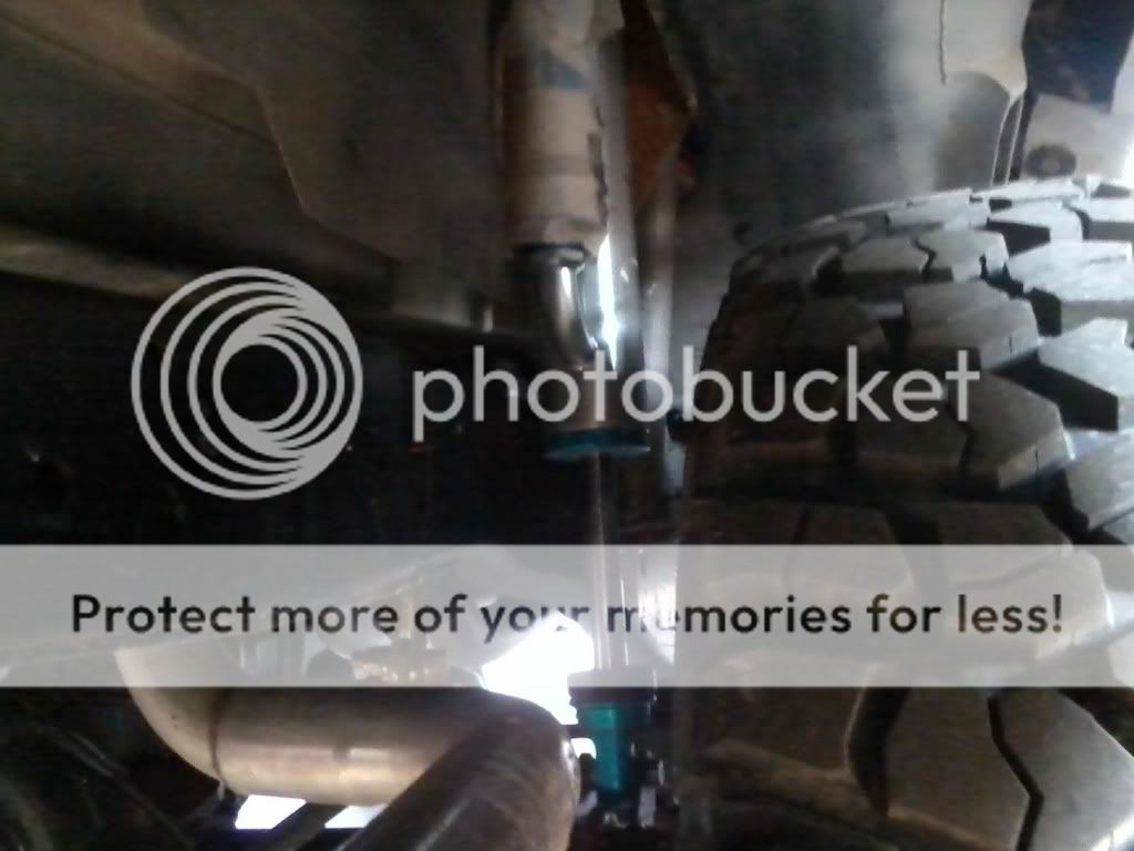

I have 4:56s and 33s. I have my shocks outside the frame running wheel adapters to 5on5.5. I haven't played with the bypass, but would recommend a rear sway bar if you are going to do alot of street. For furture reference, the xfer swap isn't to bad. If you run 4:88s it will hold its owns. The 4.0 isn't a bitch motor.

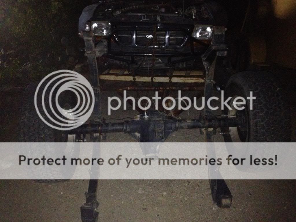

Rear axle, and springs removed from the Ranger

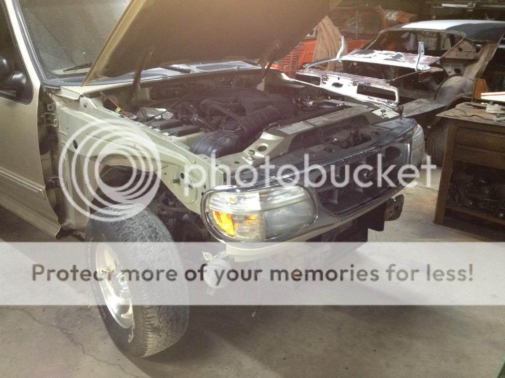

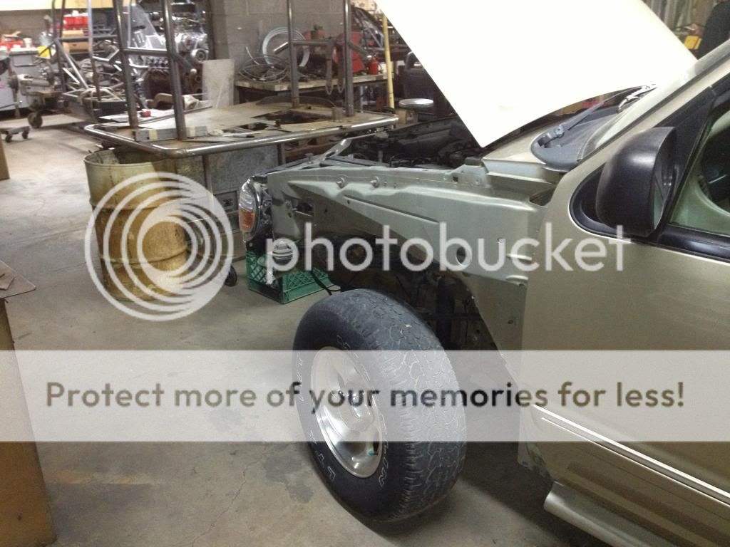

Front bumper, fenders and fender wells removed
