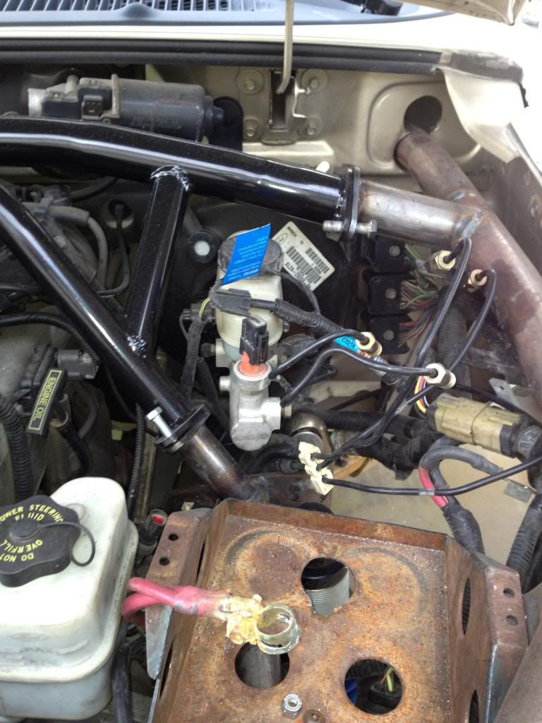

Engine cage cross brace is now removable and stock ABS is removed.

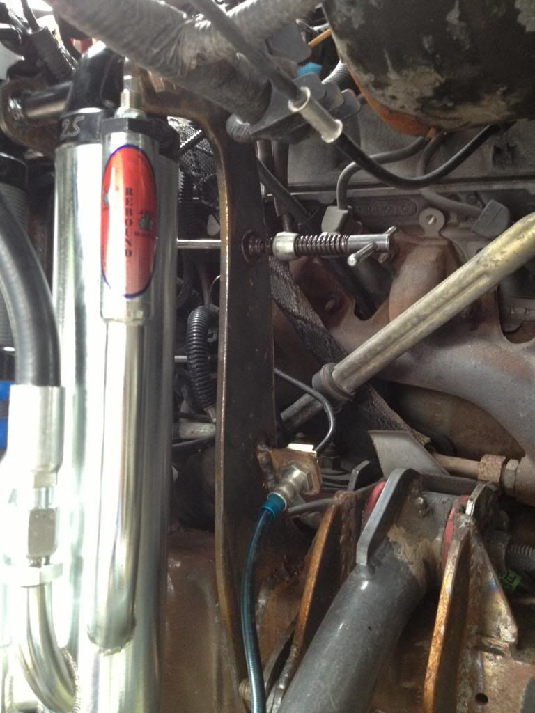

Double shear support for the front bypass added:

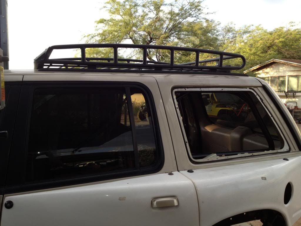

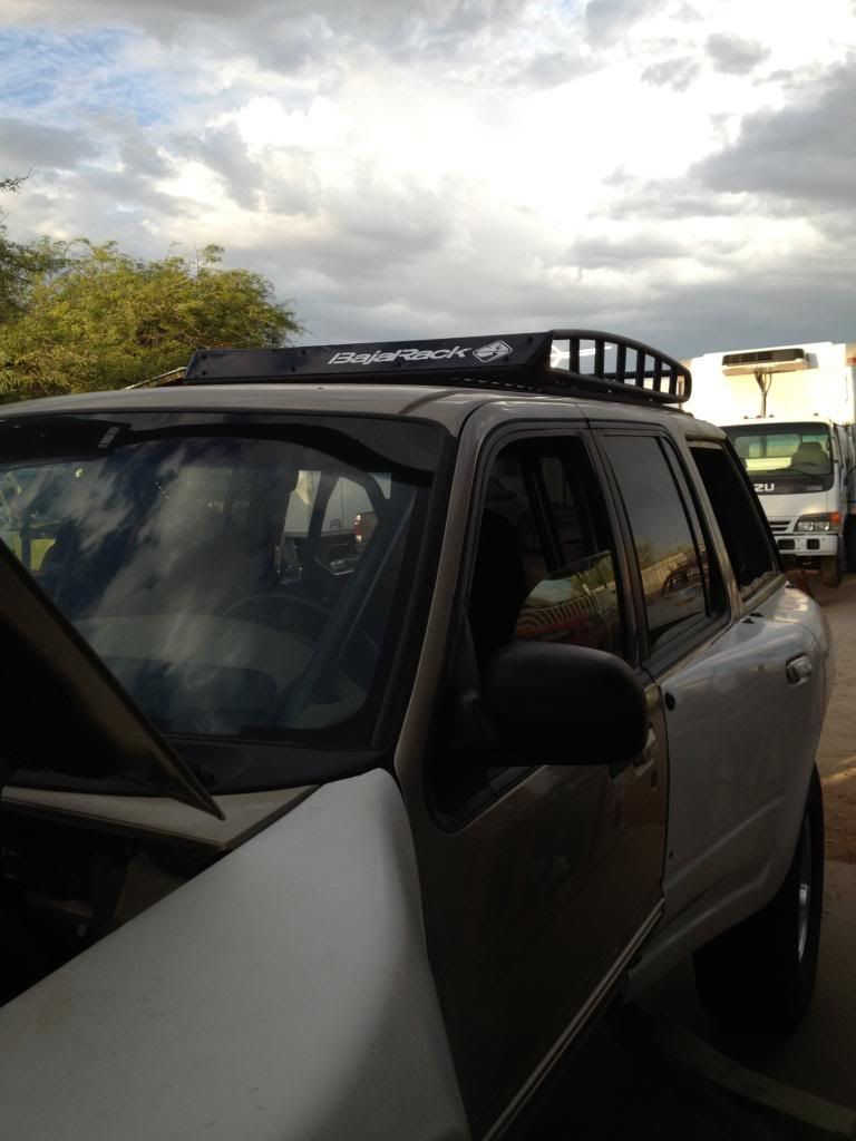

Checking to see if my 3rd Gen 4Runner Baja Rack will work up top:

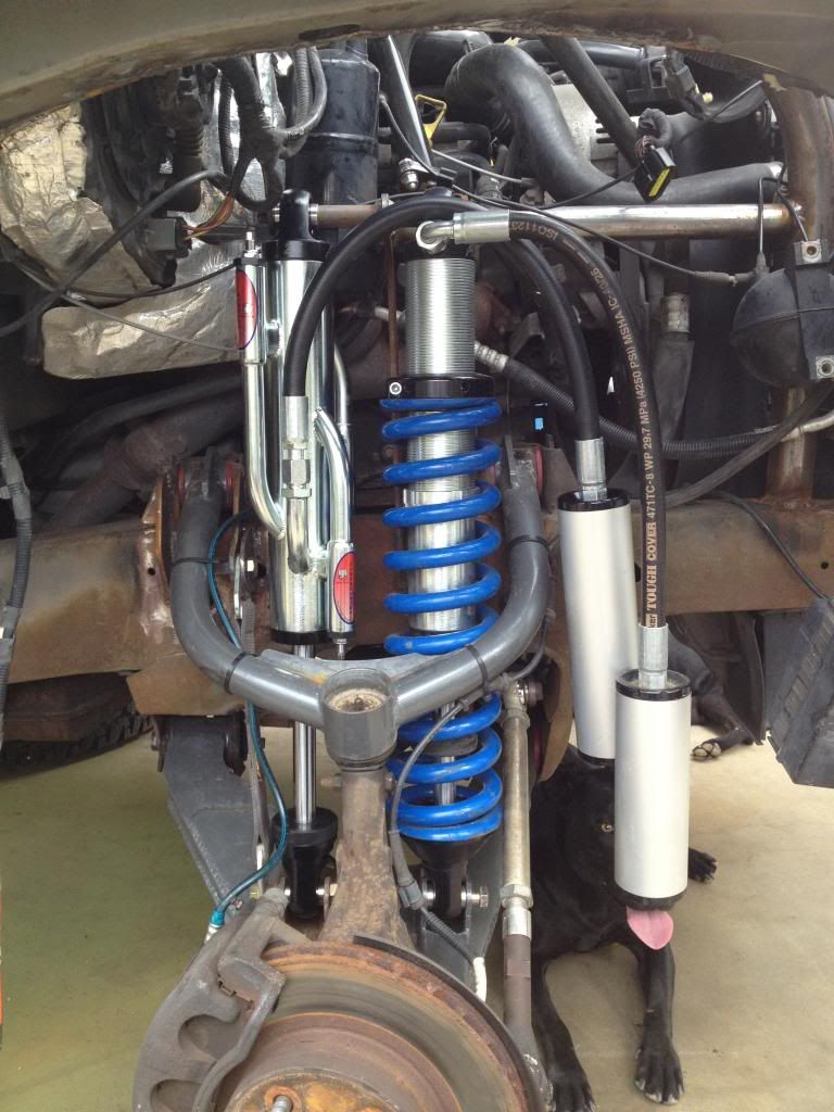

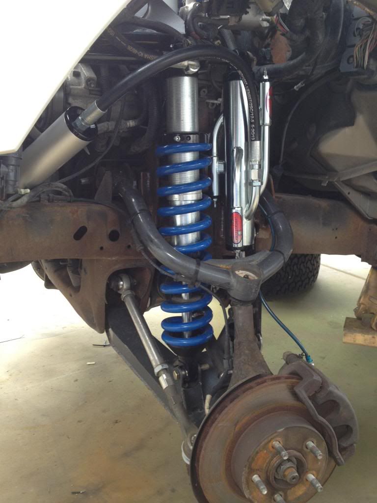

Picked up the bypasses from ADS and had them mounted up:
Added brake and limit strap mounts:

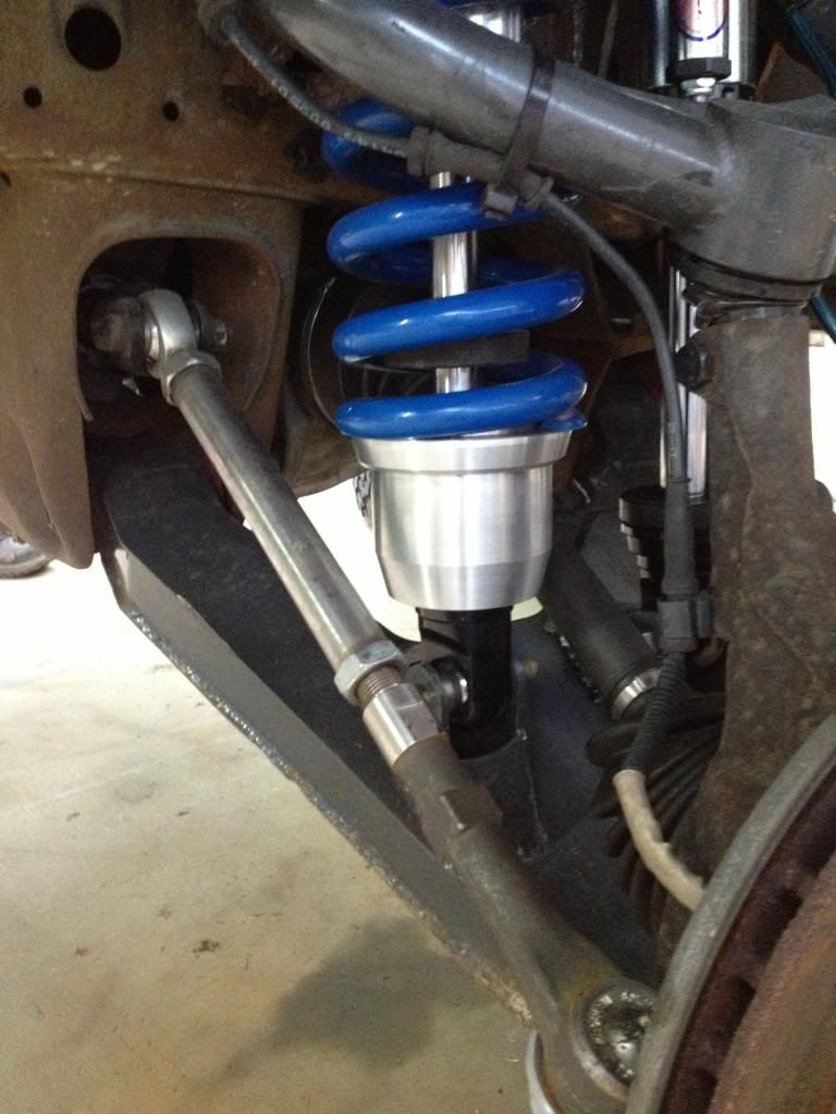

Tie rod was hitting the spring pocket, so a custom one was in order. This will get powder coated black. This was done by hand on a lathe, and no I did not do it. Pretty impressive though:

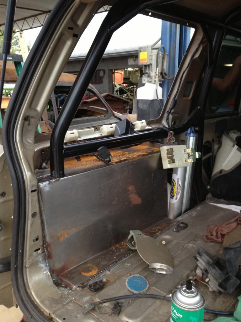

Closing up the cargo area. The sheet metal will step up and fully enclose the shock tower. Raw metal and summer monsoon storms don't mix:

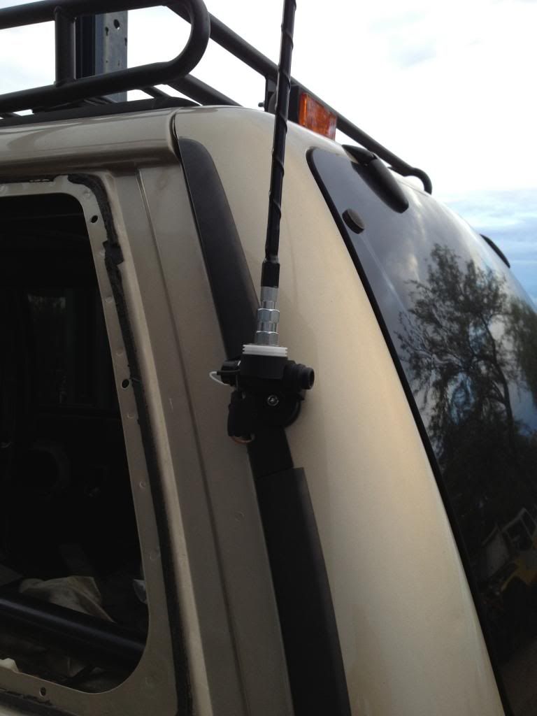

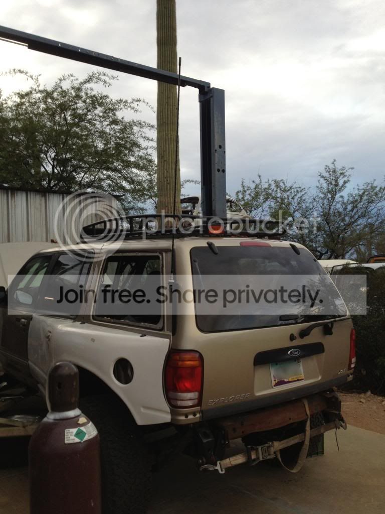

Added a mount and wiring for a CB antenna. Race radio wiring and antenna mount already added through the roof. I am thinking about stepping down to a 3' antenna. The 4' seems super tall:

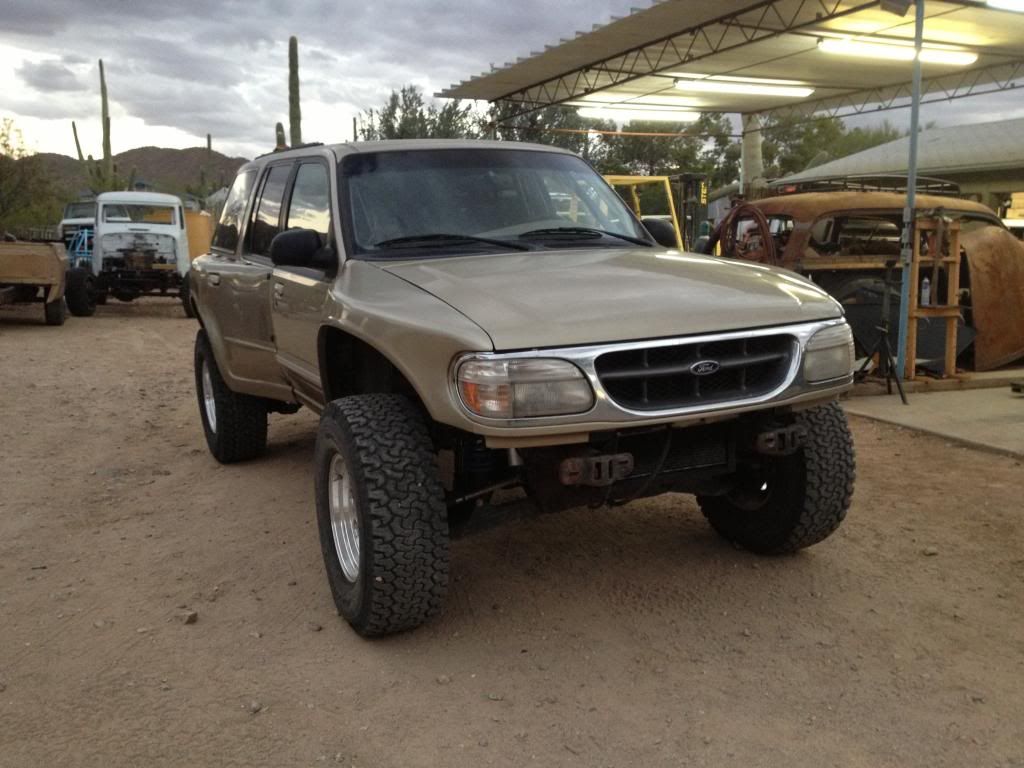

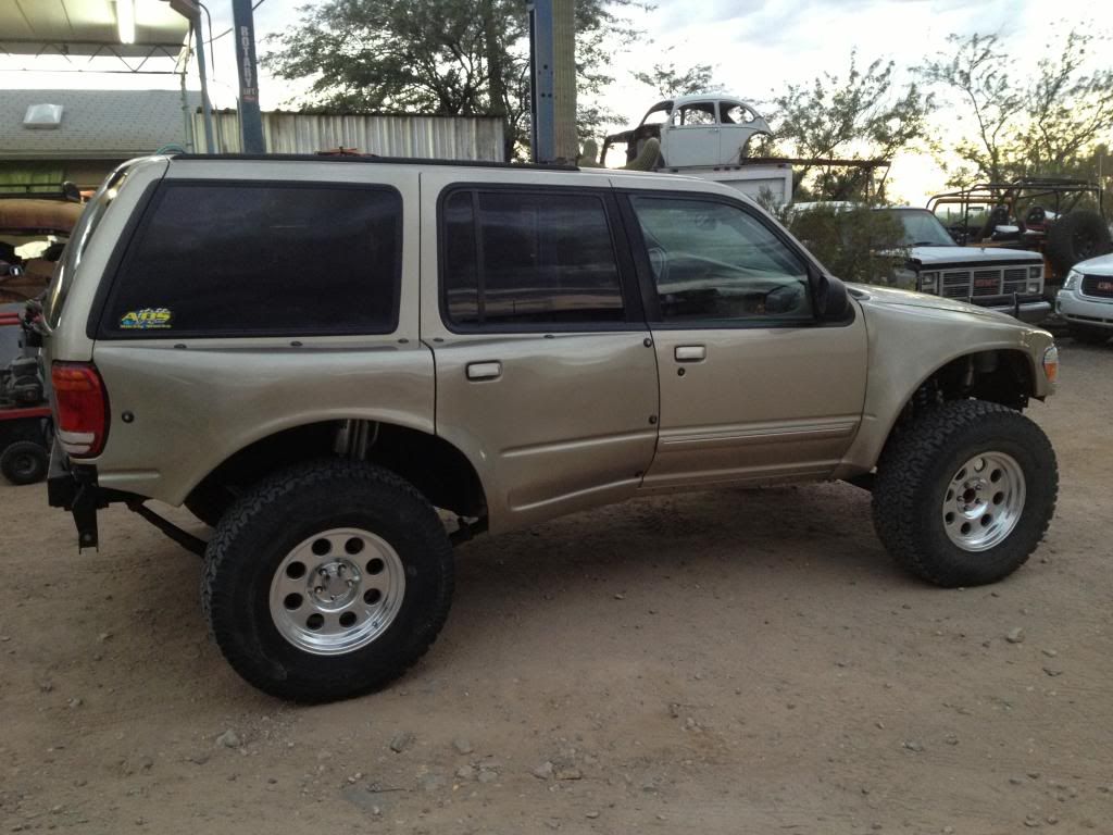

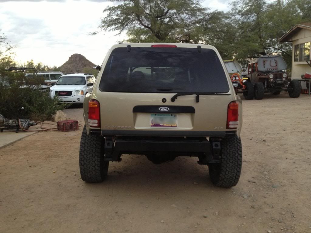

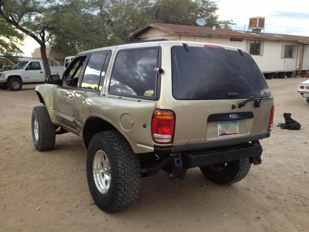

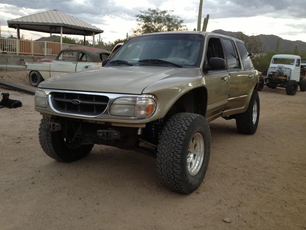

Picked up the Explorer today. My job over the weekend will be to replace the interior and wire my radios and accessories. Here are some pictures from when I picked it up tonight. Oh... did I mention that it is painted?

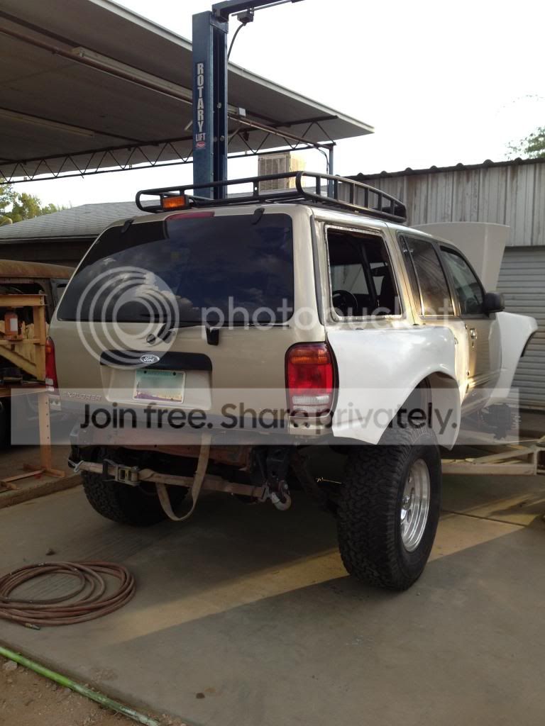

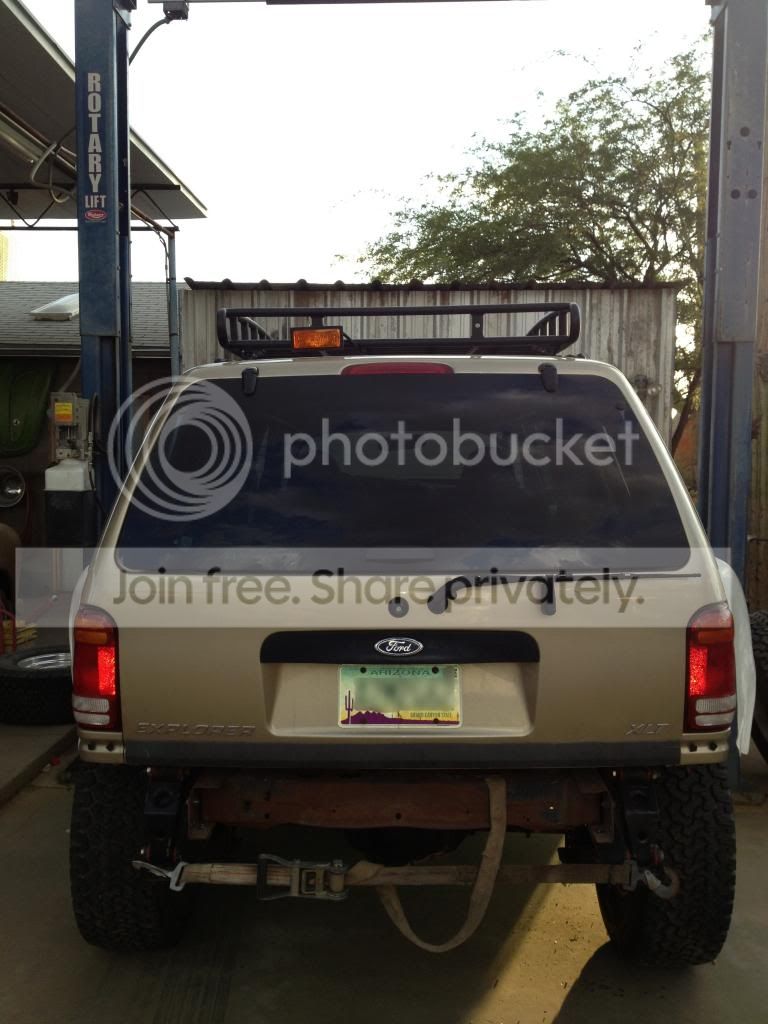

Next week it will get it's final touches for now, a front bumper and a mounted Baja Rack. By next Friday it should be ready to roll to CA for the Offroad Expo!

Looks awesome man. Any driveability issues on or off road with the wider track width?
