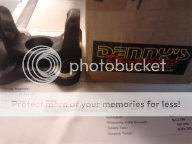

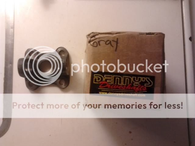

Got the 1310 drive shaft flange for the small pattern, 2.5 bolt size.

I figure since I was getting down to the final few weeks, people having the parts and saying they did was getting to close to the day of the swap so ordered it.
I need to find out what my cap sizes are and order the conversion ujoint. I think they are 1 1/16 but not sure so will look up how to measure them and go from there.
Im also debating on a greaseable ujoint or getting a non greaseable. May get the greaseable.

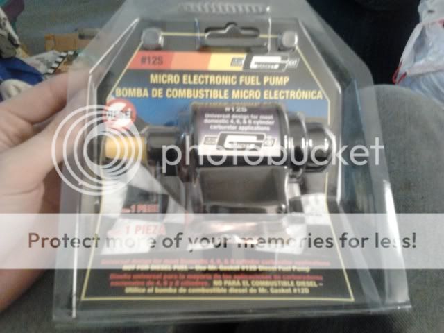

Well picked up the pump for the engine.
