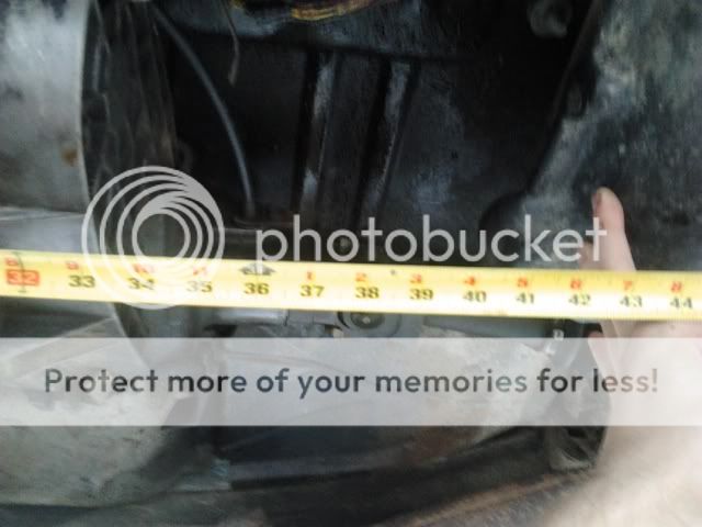

Alright doing some measuring I am able to use my current crossmember, well hook it up to the fullsize trans and I may be able to mount it to the current location it is on the frame if the engine will allow it with the mounts I plan to use. The front driveshaft output will be close to the crossmember but with a double cardon joint I should be good.
The new trans in the truck will put me at 36inches from the bellhousing on the current engine setup and also measuring from where the trans mounts to now and wanting to keep it where it is. I will also have plenty of clearance with the gas tank too.
Heres a picture to help out with what I said. You can see the 36 inch mark where the rear of the transfercase will sit, or at least in that area.

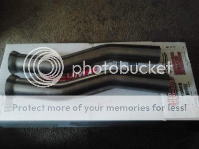

Alright more goodies came in the mail.

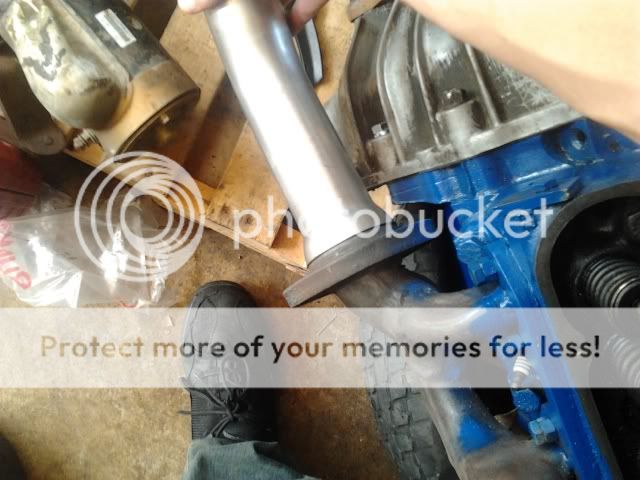

Fits like a charm, just ordered the flange to be able to bolt her on. Yes there will have to be a bit of cutting and custom work but I will go down that road when the engine is in the truck. Driveshaft will happen at the sametime too.
