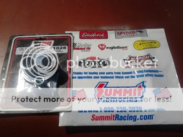

Order the oil filter relocation bracket. Almost ordered an HEI dizzy but held off till the bills get paid that should be arriving soon.
Got the oil relocation bracket.

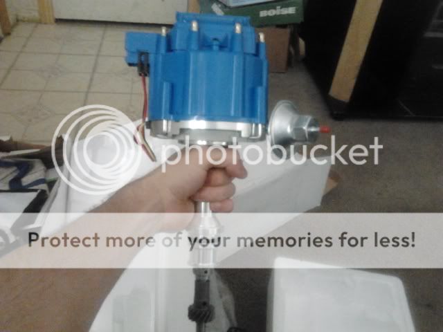

The dizzy came in the mail today....

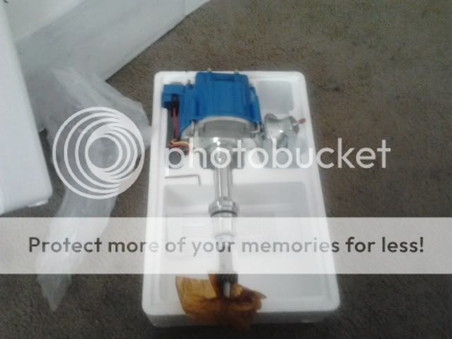

Along with this too....
dangerranger1983 build
Now I need to find a place to stick it on the truck. But I dont have the heart to take the other one off though so I will have to figure out what to do.
