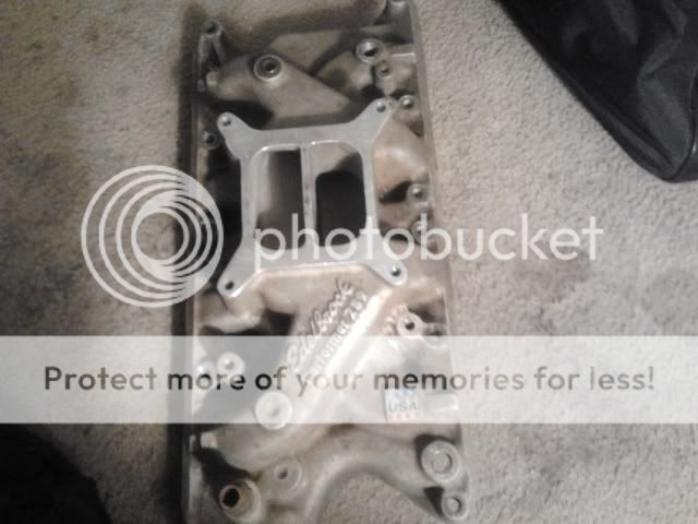

Just bought a Edelbrock Performer 289 off craigslist for a total of $74.25 with shipping. Just needs cleaned up but no biggy. Just learned that it was on an 88 5.0 HO. Its the guys 66 mustang restomod. He is converting it to fuel injection. (his exact words).

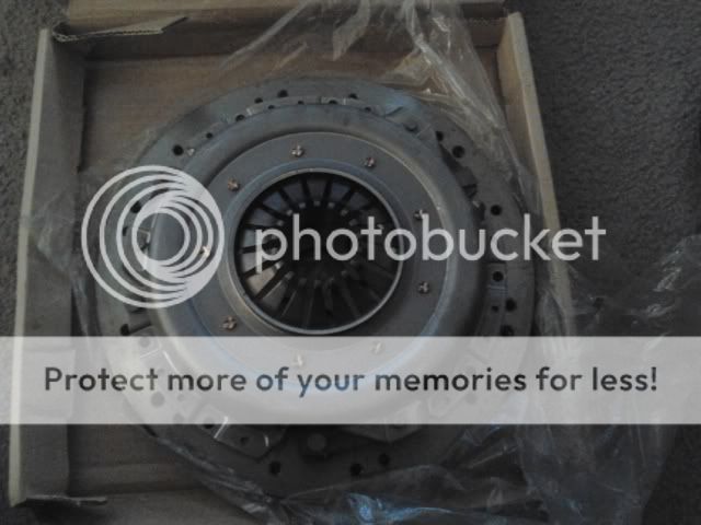

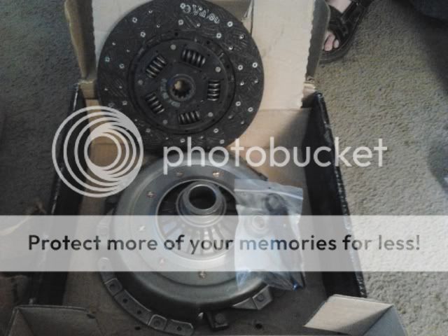

Got the clutch in yesturday but finally got to getting pics of it.
10 inch clutch for an 84 f150

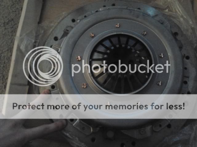

Fits on the flywheel that is made for from what I looked up 84-91 f150's. Has two sets of holes drilled for both 10 and 11 inch clutches.
All of the 6 holes line up perfectly, heres two that I am pointing too.

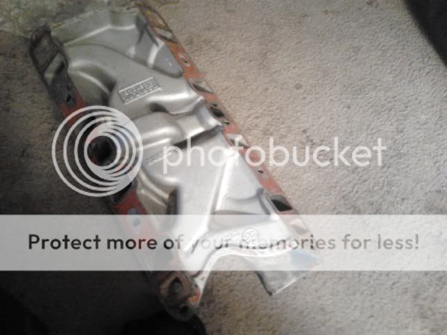

Intake came in the mail yesturday!!!!!!!!!!!!!!!!!
Just needs a good cleaning and thats on todays todo list. Nut for half price of a new one, Im not going to complain.
It doesnt have the rear water passage cross over but shouldnt hurt to much.

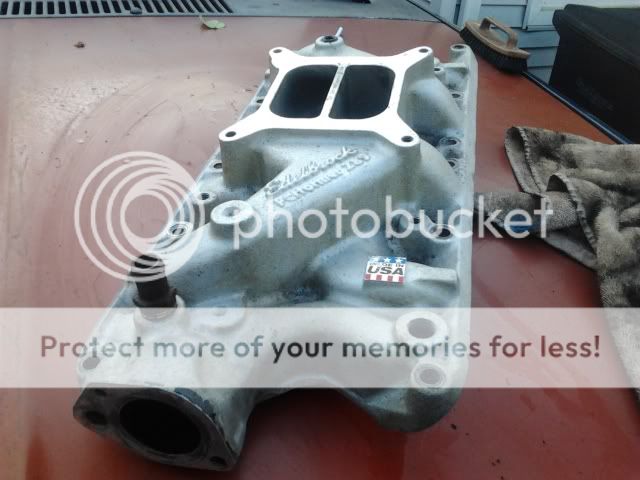

Now I just need to figure out how to get that hose barb fitting out of it, kinda looks like it is rusted in. I dont know what kind of sealant was used on it either, but its coming off.

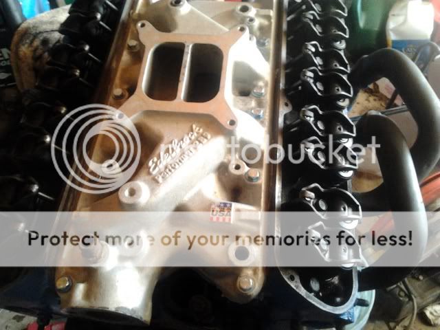

Got the intake cleaned off and 95% of the gasket stuff that was used by the P.O.
And a tease picture of how things are to come real soon.

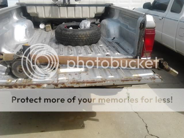

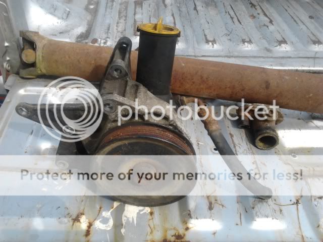

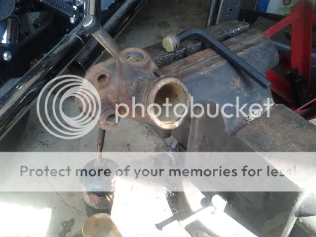

Went to the JY today and scored great. Got everything for $60, half of what I thought that I would pay. Rear driveshaft was $25, powersteering pump was $25 and the water neck, $10.
Good thing about this water neck, has the spot already tapped for a sensor, trick is now getting the screw out.
Great story behind getting this. Popped the hood on the car and my cousin took 4 bolts off. Well I went to take the rest off and one was being a pain in my ass. Half way taking it off the owners son who was with us BSing and whatnot said theres the snake. Mind you I was sitting under the hood in the engine bay a foot away from the snake. I didnt take the time to look, I literally flew from under the hood turn around and saw the rest of it slither into the fender. After 5 minutes of thinking about not getting the pump, we decided we got this far and just get it, I needed it anyways so got it. Also my hip hurts too, somehow I managed to twist it flying from under the hood, big shocker there.

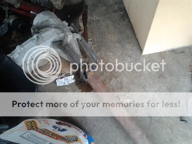

As for the driveshaft, went to look at a stock pile they had and found one that was too long, as I was needing anyways, and it had the 1310 joints, figured I am going to have to use a conversion joint on this anyways so got it. Well after going to get the water neck I looked inside of the truck that I was getting it from and saw that it had its shafts already pulled. Measured it and it was 56 inches, same length as what my current ranger one is and the swap is going to need a shorter one so decided to grab it instead plus it has the 1330 joints on it, still going to have to use a 1330 to 1310 joint for the rear end. Well it has a slip yoke on it, looked similar to what I already had so got home went to test fit it and slides right over the output shaft, perfect match. The fluid below is from when I took the slip yoke out today to go compair it at the JY.
Well not much got done but did get the screw out of the water neck with some help.

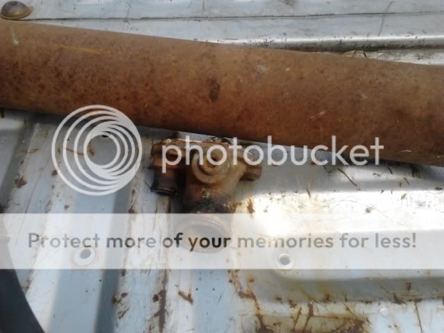

I ordered a driveshaft ujoint flange that runs the 1310 joint and bolts to the small pinion flange (2.5 inch) that I have whicj means I dont have swap out the pinon flange. I will use this with a 1330 to 1310 ujoint and should be good other then shortening the shaft.
Next I will have to measure my caps and get the conversion joint that has the cap size and should be good.

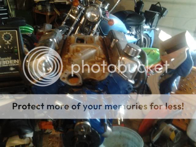

It was pulled out of an 83, i dont know if it is the stock engine for that year, i am going to go and search for some casting numbers on it to date it. I has an after market cam, edelbrock performer intake and a edelbrock 4 barrel carb. He sold it to me for $215.79.
