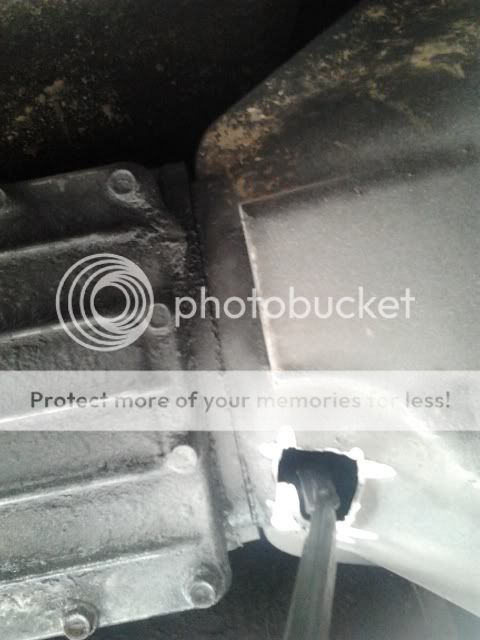

Got the hole cut in the bell housing and got it fixed. Going to put JB Weld on the threads later as a better thread locker. Everything works as it should again, clutch works great, etc...
When I had cut the hole, I was able to at first hand screw the bolt in then had to use a wrench but it didnt wiggle at all or want to pull out, it just wants to vibrate loose.
As promised pics...

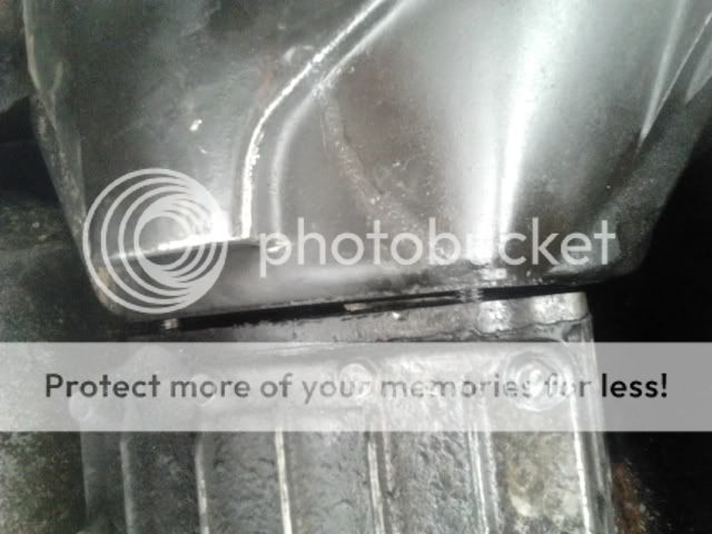

What I was dealing with again...

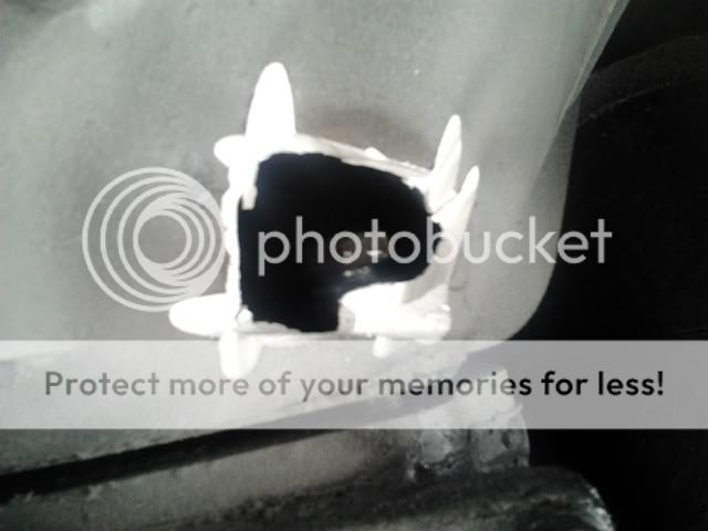

Got the angle grinder out and cut a hole and got it right on the first try. Note how far it had vibrated out in just a couple of days.
Got teh wrench on it and tightened her back up and it pulled the trans to the bellhousing which also made the clutch stuff line up as it should and make contact with the clutch fingers (cant see that but thats what the problem was).
Keeping an 11/16 wrench in the truck from now till the 302 swap.

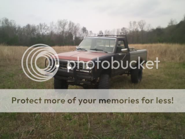

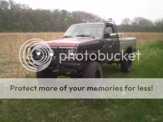

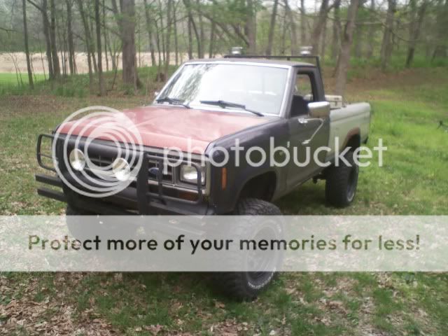

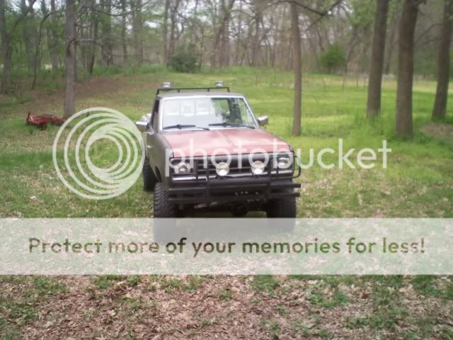

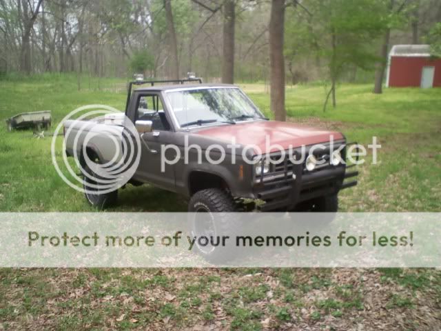

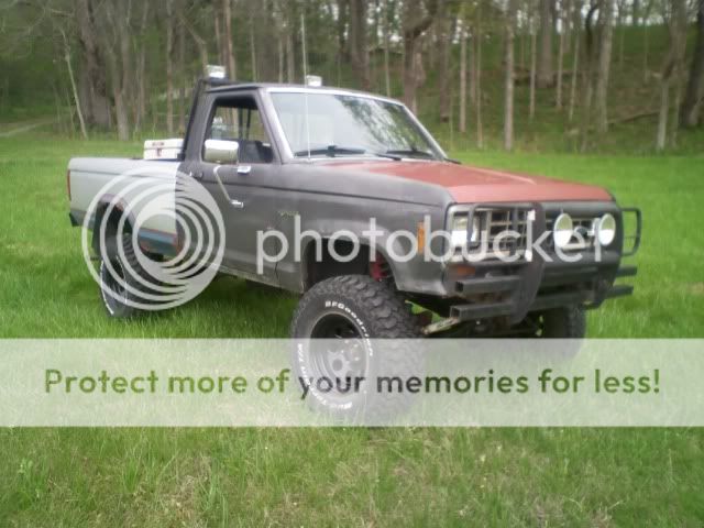

Well no progress other then hopefully get an intake and a dizzy off a member off here for a good deal so went out and took some pics.

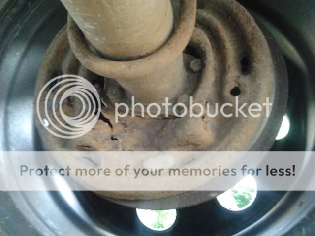

Ordered a dipstick for the engine, should be in tomorrow. Also yesturday hit the brakes on my truck for a sudden stop and also to test them and now my rear brakes are making the typical rubbing sound when driving. The sound doesnt get louder as i drive or when I brake but has a slight pause/noise/pause/noise when driving and from what I can hear a constant sound at higher speeds. When I brake, it doesnt pull to any side nor when driving and my hands off the wheel. Also made a clunck sound too, hopefully one of the rear brake setups didnt let go on me and now all of the stuff is inside the drums making the sounds I hear.
Well found the problem. Guess I need to get this fixed ASAP.
Time for an Ex 8.8 swap
I hope to do a quick fix and get a new backing plate hopefully tomorrow from the JY.
Yes it is. I will have to pull an axle shaft to replace the backing plate and I really don't want to do that. So now I start decided what to do. The rubbing sound is the drum rubbing the backing plate. Now if I wanted to do a quick fix then I would cut a slot in a new backing plate to go over the axle shaft to avoid pulling an axle, may just end up doing that.

Well third time is the final straw for getting towed. Also third time I have had the same bolt backing out problem.
Bolts have stripped out their holes in the trans for the bellhousing to stay attached and for the clutch to work so it looks like a month or so of no driving and walking to everywhere while I tackle my 302 swap.
Now its down to crunch time. Now I have to do anything I can to get it back on the road with the engine under the hood.

Problem with opening up a hole in the trans to tighten them was aluminum threading doesnt like to have steel bolts going being threaded/re-tightened through them alot and over time, something has to give. Plus I dont have access to the top bolts either. I will say there are no bolts holding anything anymore, I found one in the bell housing, one under the truck that fell through my hole, my current one that wont hold torque anymore and the forth...who knows where it is now.
My theory is as the engine torques, so does the trans and whatnot and over time this torques the bolts slowly but surely enough that they are able to get loose enough to start vibrating out and whatnot.
