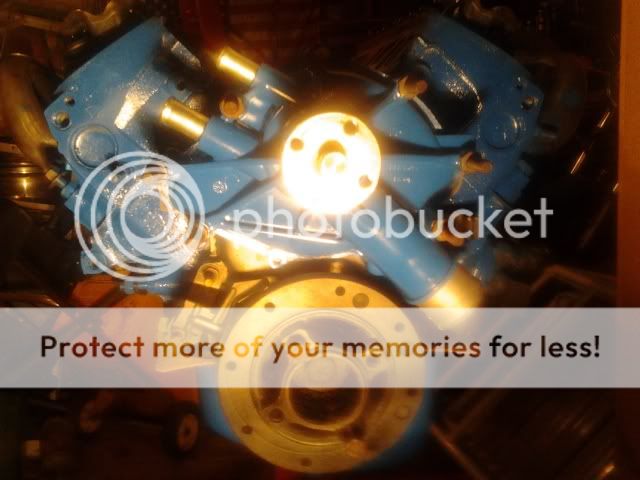

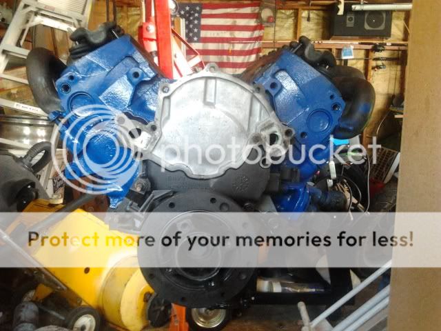

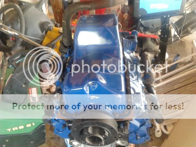

Got the harmonic balancer back on her, thats all I had time to do before i have to go to work.
Next thing to buy, water pump, AA oil adaptor. Still on the look out for the other parts listed in my WTB thread.
Saw this on the blazers, at least to pre 95 ones, they have a remote oil filter mount and wonder if they will work for a 302 or if the filters arent big enough (Im not sure what size they use). I will need to look more into that and also getting another starter too.

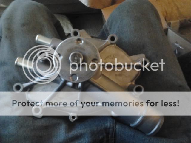

Water pump time.
Rebuilt one with LLT warrenty.

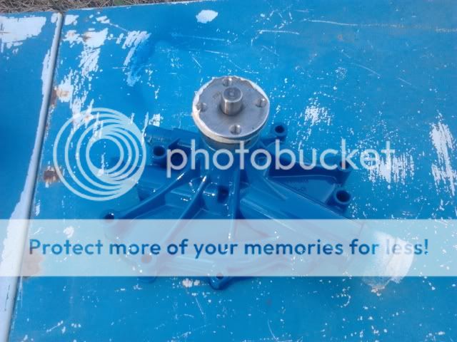

Painted...dont think this voids the warrenty.

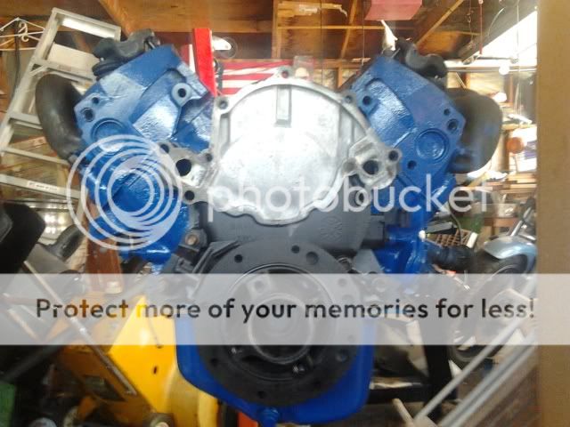

And one the engine.
Since progress will be slowing on the engine due to all the rest of the stuff need is the most expensive and also saving up for the ranger meet coming up too.

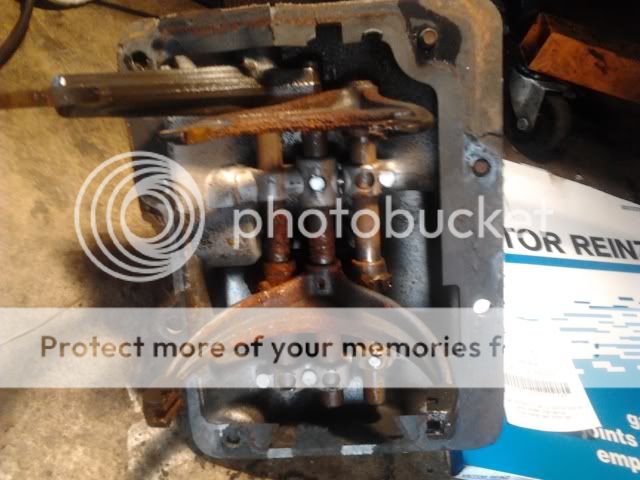

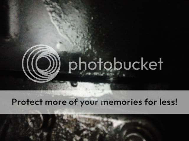

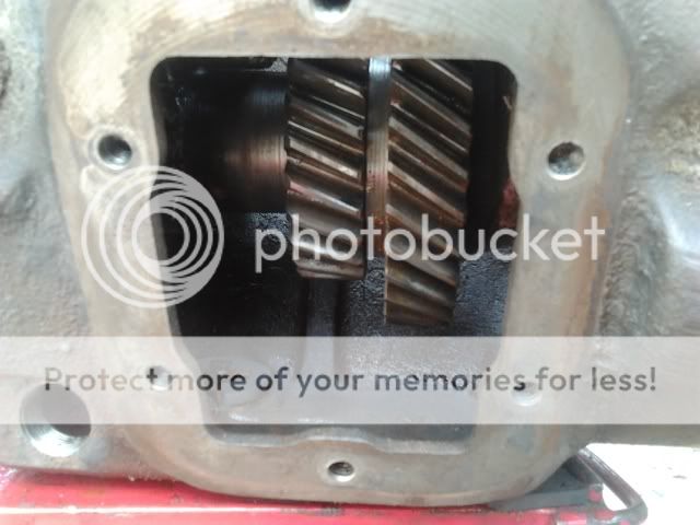

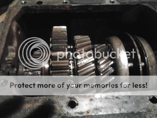

So I decided to take the top of the trans off and this is what I found...

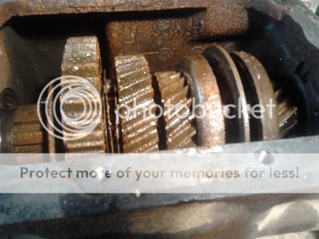

These all look to be in good condition.
Had no fluid in it due to it leaking out of the PTO cover since the gasket went on it and/or the drian plug backed out.

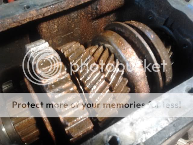

Plans are to separate the trans from the transfercase when doing the instal but wanted to take the top off to see everything in it before seperating them. Now I have to figure out how to clean up the inside of this.
That's a lot of surface rust.
Sent from my HTC EVO using Tapatalk
She did sit in a barn for awhile and out of the weather too. Everything does turn free and smooth though so that is a good sign that everything will be fine.
Alot of what you are seeing is water/oil fluid on the surface of the gears but it wipes right off.

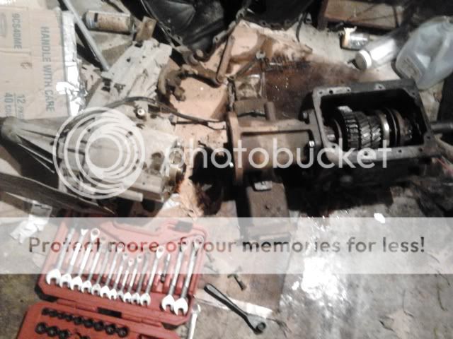

Got the trans cleaned out most of the way.
And also got the trans seperated from the transfercase.

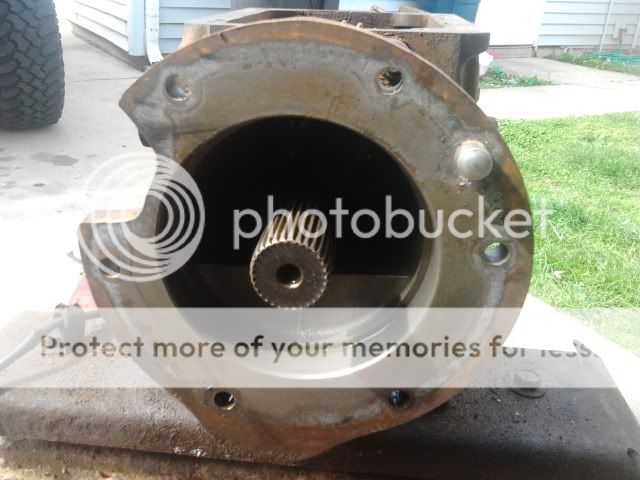

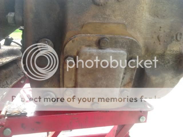

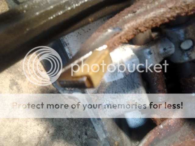

PTO cover off and cleaned out. Didnt know about the magnet that was in them. Didnt have much metal on it but had a layer that covered it along with all the nasty sh!t that was in the trans too, but thats now clean too.
Got the PTO cover back on took the picture and forgot to put the tag back on it so did that right after I took the picture. From what the tag says the trans was made June 7th, 1984 and is, not that I already didnt know, an np435.
And got the gasket mainly cleaned off where the transfercase meets the trans. I will say these have a huge output shaft on them, dont see me snapping one anytime soon.
And will also have to find that gasket too, my trans gasket kit didnt come with one.
