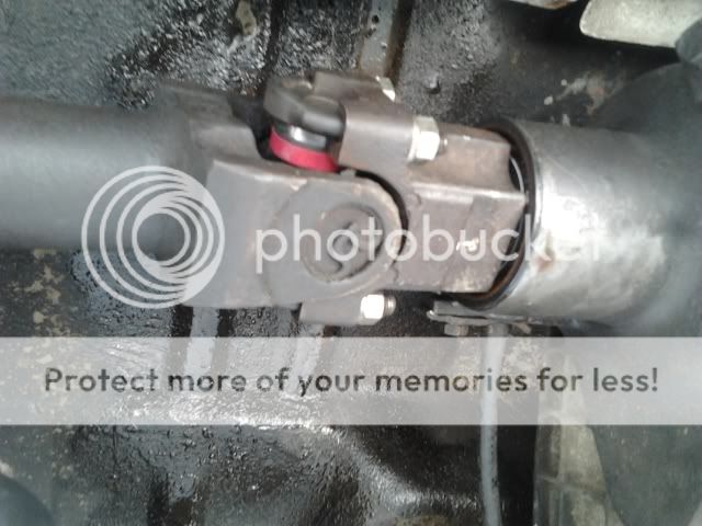

She back to 4wd. No more just front wheel drive.
I also found out before I got this fixed is I can do front wheel drive burn outs.

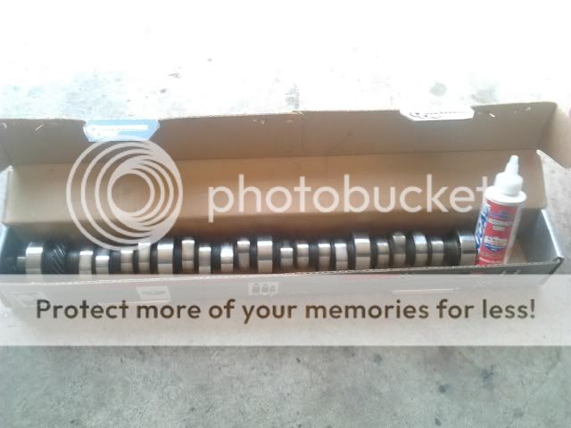

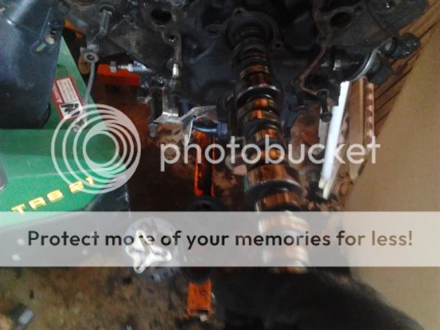

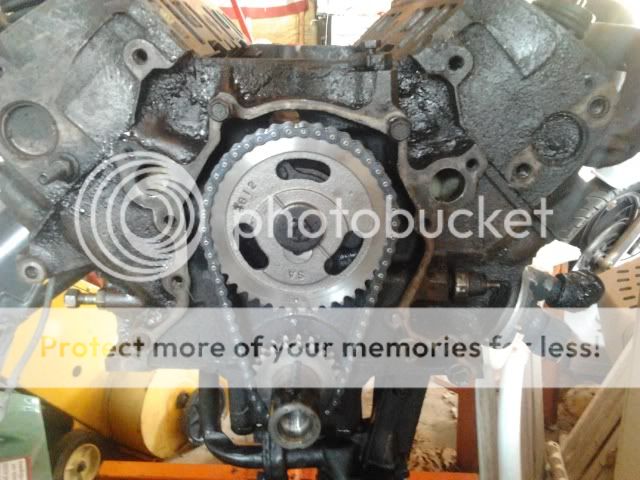

Got the HO cam in.
Old cam being taken out.
HO cam with assembly lube that was used on all the parts taken off for the cam instal.

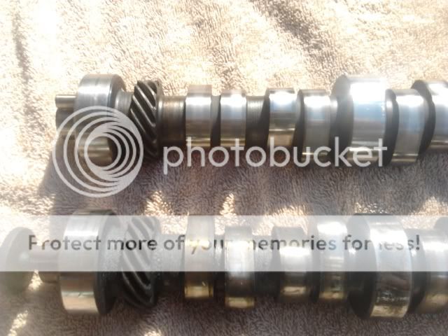

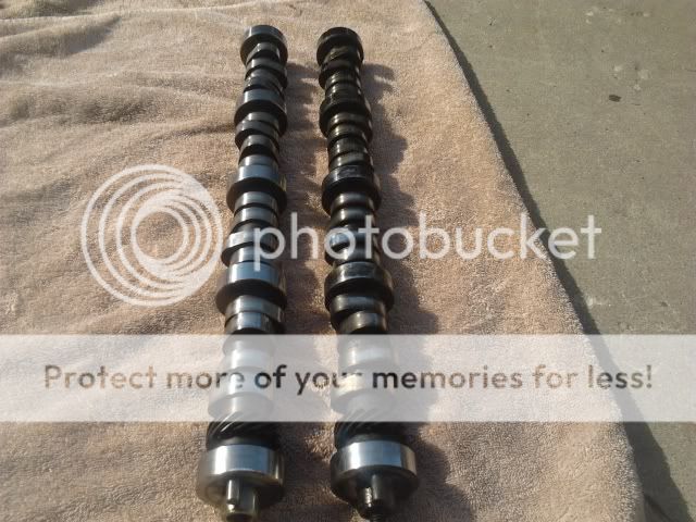

Compairing the HO with the Non HO.

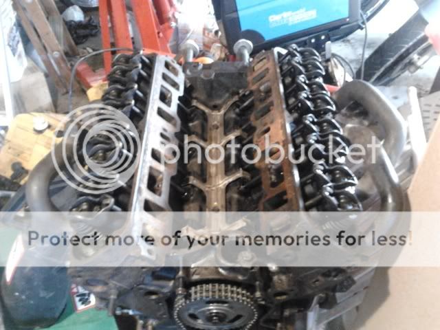

HO cam in.

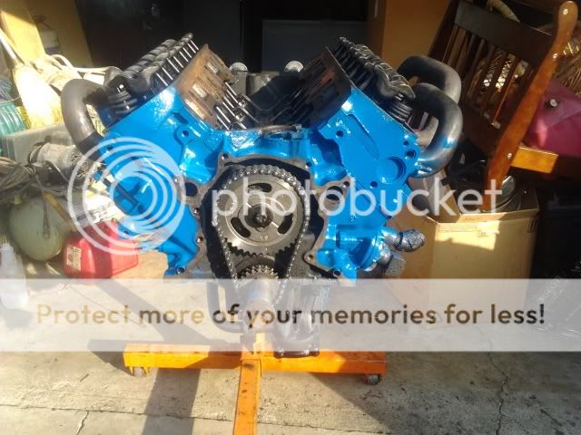

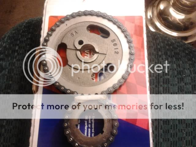

New timing set.

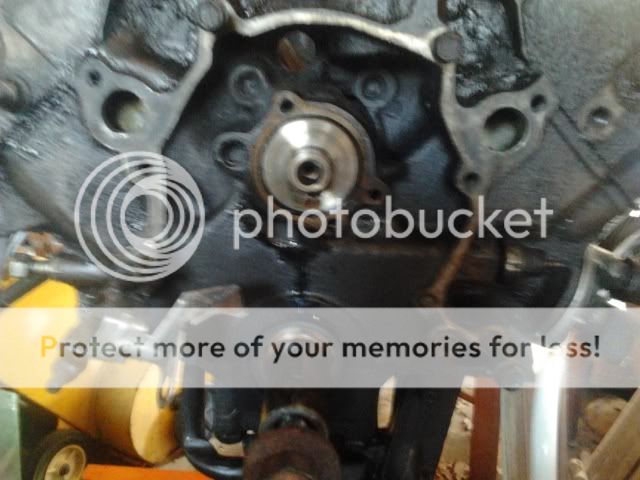

All back together.
is just me, or does it look as of some of the lobes are in different places ???
Robert
posted from my laptop while sitting on the roof of my house
Also I rotated it a few times and nothing made contact, i.e piston and valve, so all is good to go.
The lobes will be in different places. The HO cam has a different firing order then the Non HO cams.

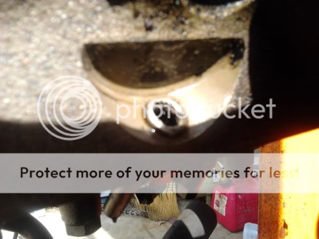

Also need to figure out how to get the old dipstick tube out so that I can put a new one in it.
Next is to take off the exhaust manifolds and do the last detail cleaning with a toothbrush.
use a hammer on the bottom side of the tube and tap it out (tap not bang), if that don't work, then use a drill.

Got the dipstick tube out, now to find one. The one given to me doesnt look like it may work.

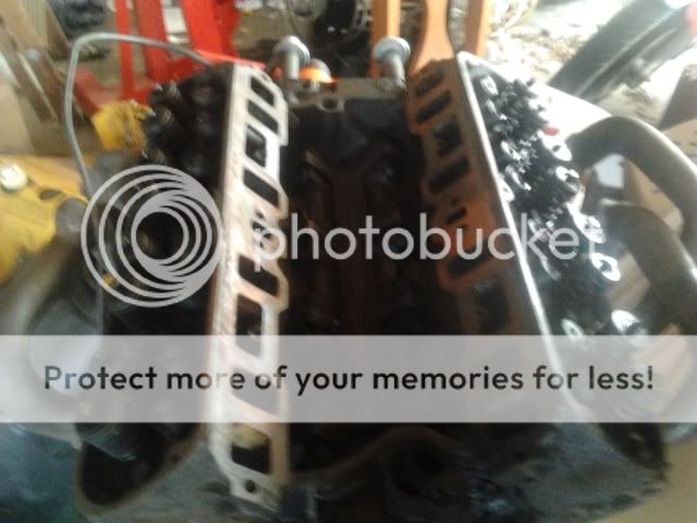

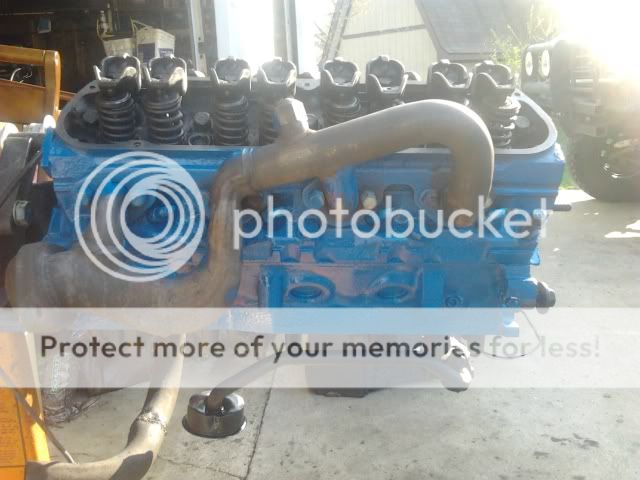

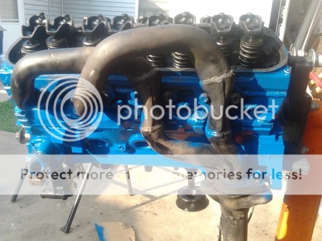

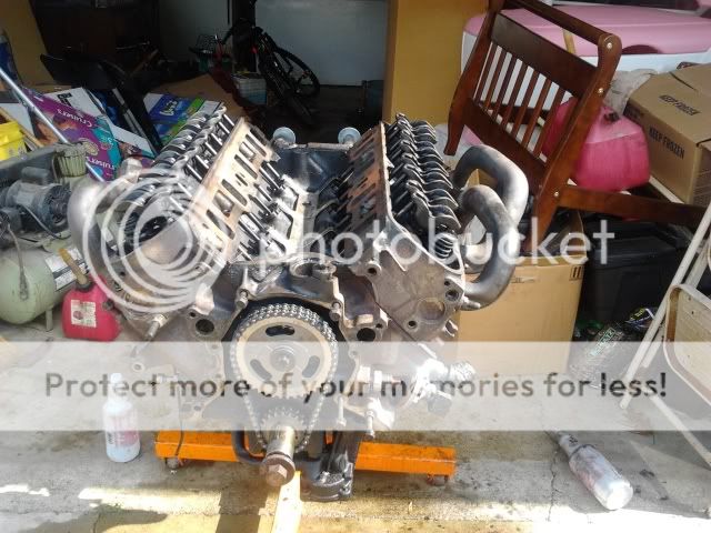

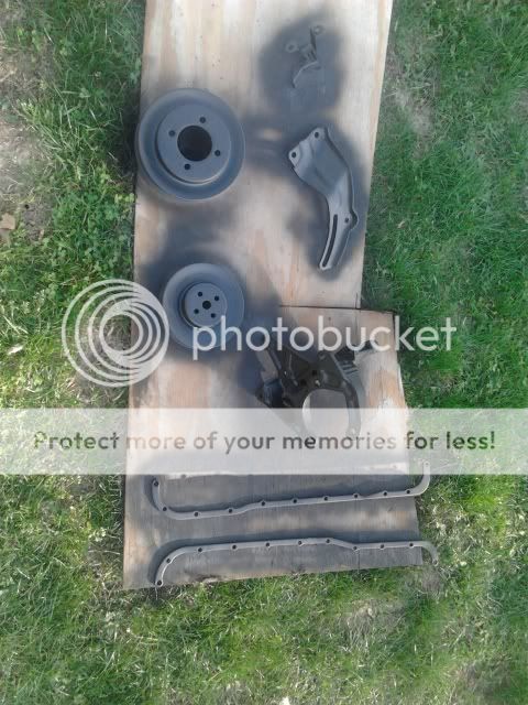

Okay picture time of what I did today.

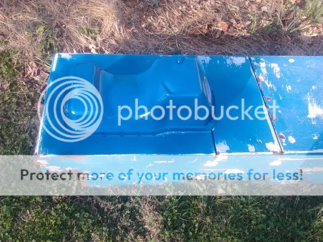

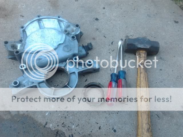

Also got the seal out of the timing cover too. Im torn as to what color to paint it.
