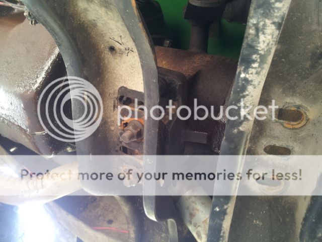

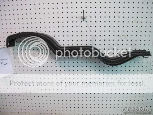

This is the one that I have and that I need.
If for some reason I can get a stock xmember then I will see about making one out of 2x4 steel that is 1/4 thick.
Another idea that I might end up doing.

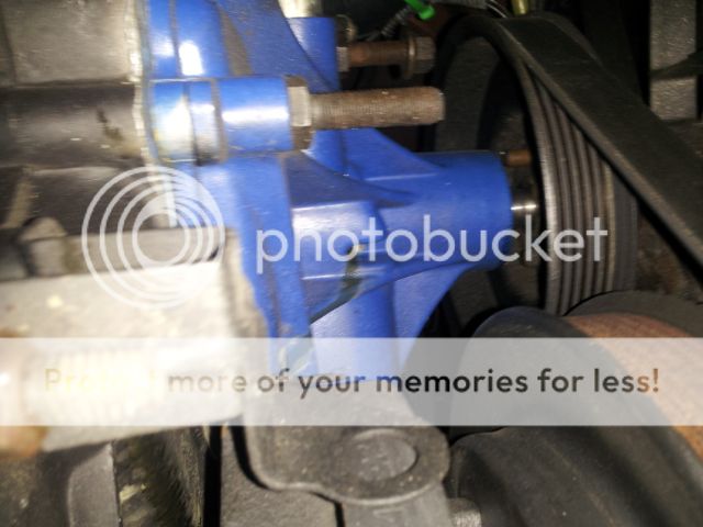

Checked the rad fluid earlier today and noticed it was down. Well saw a very small spot under the truck and it's coming from a the hole that comes in the pump. ..
New pump too, no reason for it to be leaking either. :annoyed:
Sent from my rooted SPH-D710 using Tapatalk 2
Did you buy it from AutoZone?
Sent from my HTC VLE_U using Tapatalk 2
Yup, has a LLT warrenty but dont know if its void due to being painted.
Anybody know what the purpose of the hole is if any? Can it be filled in with a sealant?

I just did the water pump on my 22re today and saw a hole on it too... i have no clue why they are there...
they are there to let you know its water pump and jelly time:D
put some leak stop in.

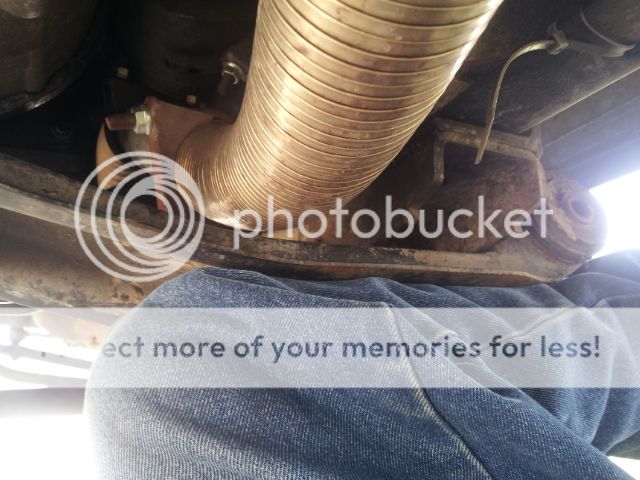

The drawback is not being able to put a drive shaft in do to clearance issues with the transmission crossmember. I don't want to mount a diagonally I plan on making it straight it's just a matter of how but I think I have an idea. Originally I did not want to mount to my frame mounts for my long arms but it seems like that's the only option I have.

That hole is a weep hole, it's to let you know the pump is going bad.
I did have a friend that put a grease zerk in it to grease the pump, of course he was 87 when he pass on.
Robert
posted with a non-rooted prayer, and ice cream.
If I have to replace the pump im finding a cast iron one, not going to dick around with the aluminum ones.

I can make it work at an angle its just attaching to the long arms mounts and unattaching is the biggest thing I have to think about plus making a monuting spot on the arm mounts. I can get some 1/4 inch plate, angle it and weld to the crossmember so the trans can mount to it.
If the weather is nice tomorrow I will test fit my first idea a few different ways and go from there. I dont want to use the factory mounts on the new cross memeber so they will be cut off.
