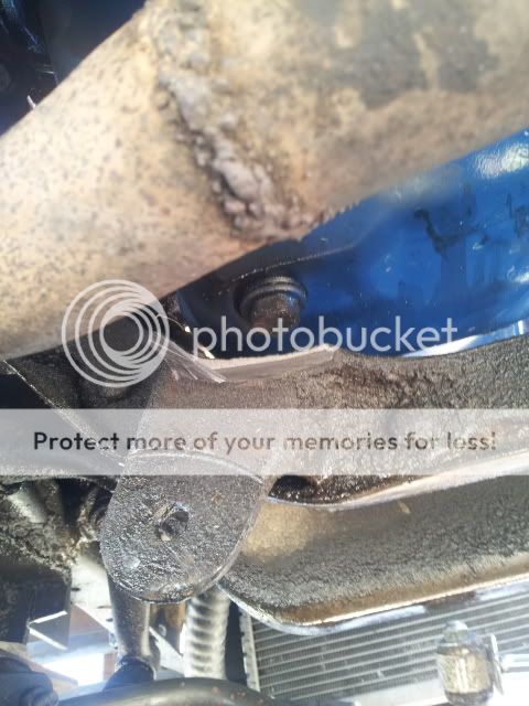

Since one of my ranger buddies has a garage that my truck might be able to fit into, heres next sundays job so that i can change the oil.

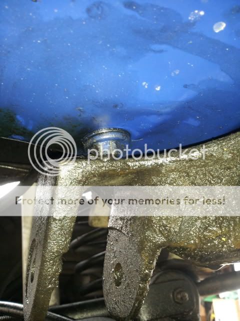

Engine has settled onto it since the engine swap.
What bracket is that, could you just grind away enough to get it out for oil changings?

isn't one of the brackets that the old ttb was mounted too????

sawzall or hack saw:icon_thumby:
i always cut the corner of the pan and flip it there and have it rewelded. well these days i could weld it myself but back when i started doing this shit i had to have it done.
The was the passengerside TTB bracket. If I had taken the 5 min to cut it off before putting my engine in I wouldnt have this problem now :annoyed:
Going to a buddies next sunday who has a garage and some sawzaws so that I can work indoors and get it cut off enough to get the plug out.

Bracket cut about ¾ of the way through then a few love taps of the hammer to both sides and she came right off.

There ya go! Get that booger out of the way!
It's out of the way enough now. I will say the truck was down a quart or so of oil but also i did have oil in the lines of the relocator and in the engine, oil cling on that it didn't have when i put the engine in. Also need to check the trans fluid too. Was 26797534 times easier and less messy then changing the oil from my old 2.8
