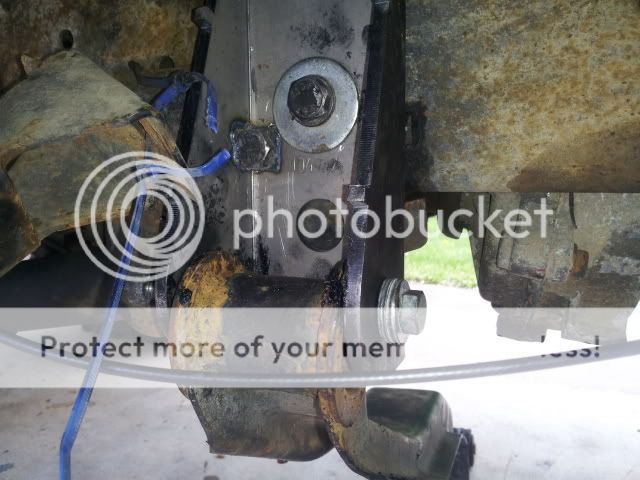

Anyways got started on my xmember, got the frame bracket modded and mounted. Still have a ways to go but some progress is better then none.

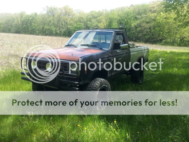

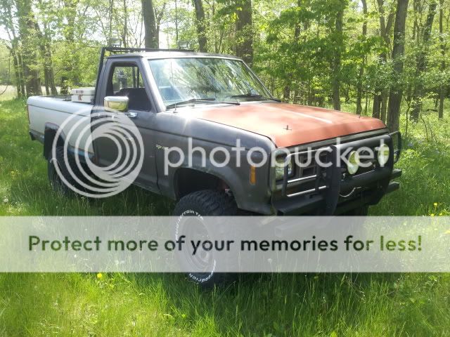

Went out to mushroom hunt today along with taking the truck out for a good drive and some pics.

I really like this truck.
Keep it up
Thanks.
When I first was building this truck I was going for a mudder/trailer driver that I cutoff beat on and what not but as time went on building her, putting money into her, etc... I realized I didn't want to be breaking stuff, abusing her but just want a reliable DD that I can go have fun with and all do everyday personal needs.
Getting her back to 4wd will be my last major project for awhile and then I will be focusing on the small maintenance things on her.
Right now I'm reaching that stage where I don't want to work on her as much but I just want to enjoy what I have worked on for so long.
