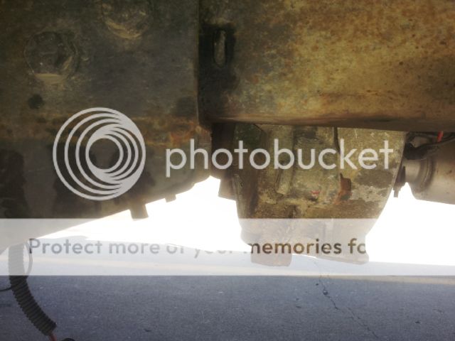

Here's the limited space I'm an taking about...

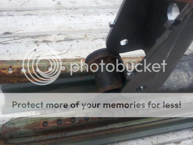

I need to quit being lazy and get measuring on a couple of things along with the weather corporating. I have some leaf spring mounts that I got years ago before my SAS from ballistic fab that I'm going to use for the outside frame mount cross member that I got for one side, the other will be cut at the limit of the arm mount, go up, then into the top part of the bottom of the rail and bolted, basically where the pictures of where I showed it on the arm mounts is where it's going to be.

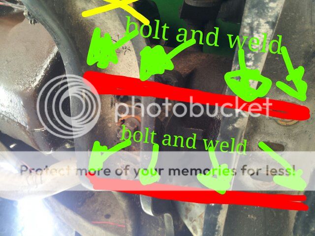

Okay..bare with me. Yes they are ugly, did it on my phone but the finished product will look better then my kindergartener drawing skills..
Okay this picture says it all. The yellow X at the top its the down hump in the way that will be cut out.
dangerranger1983 build

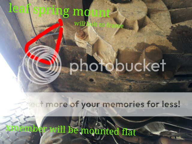

This one is the driver side. I will bolt the leaf spring hanger to the long arm bolts on the frame, hopefully it will be wide enough. Also the xmember well be mounted flat, not angled as shown.

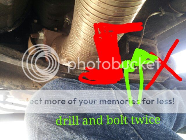

Now this side I will cut the eye mount off and make as what is shown in red. Fab up the red part to attatch to the bottom of the xmember, run up the side of the long arm mount, then turn to mount on the top of the bottom frame rail which will be bolted only do I can remove it from the truck. It's being made that way due to the current one is an inside frame mount and if I did one on the same side as an outside mount an one inside, might make it a bit hard to remove and/or install again.

:icon_thumby: yeah, i can see that...
that should take a beating and come back for more:icon_hornsup:

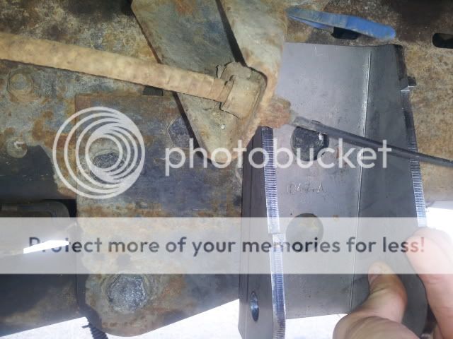

Okay dug out my leaf mind and went to the truck to see how things are going to mount on it and the xmember.
Will have to cut a spot out for one blot in the leaf mount and still a couple others.
The mount isn't wide enough but nothing says the xmember bushings can't see what an angle grinder can do to them for a bit of clearance.
