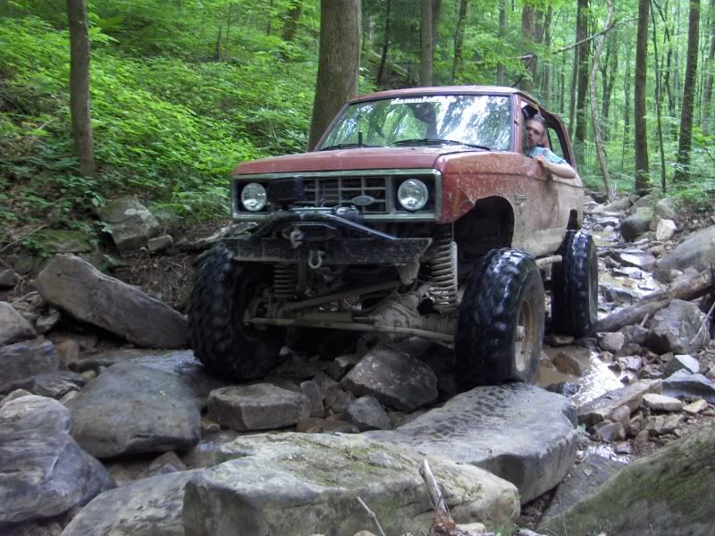

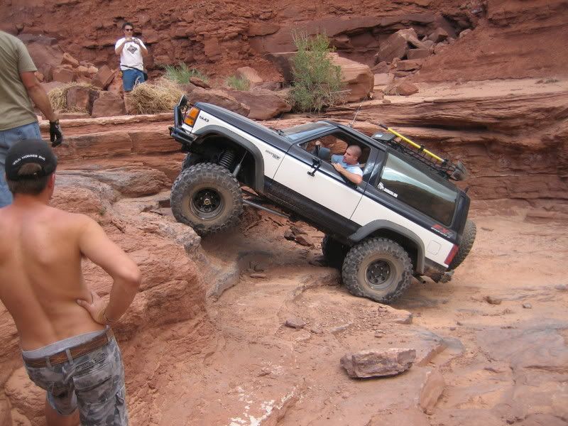

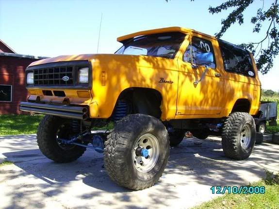

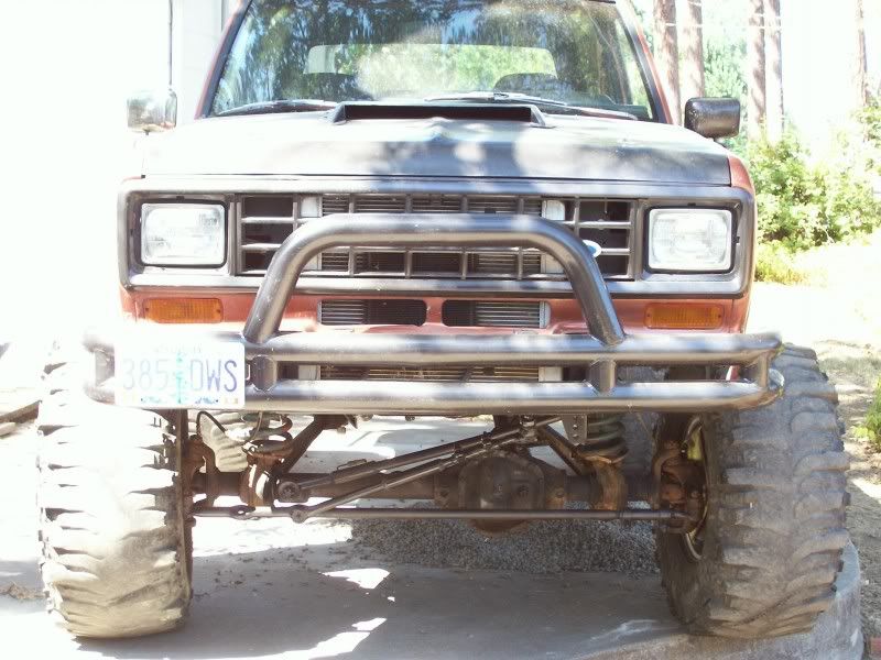

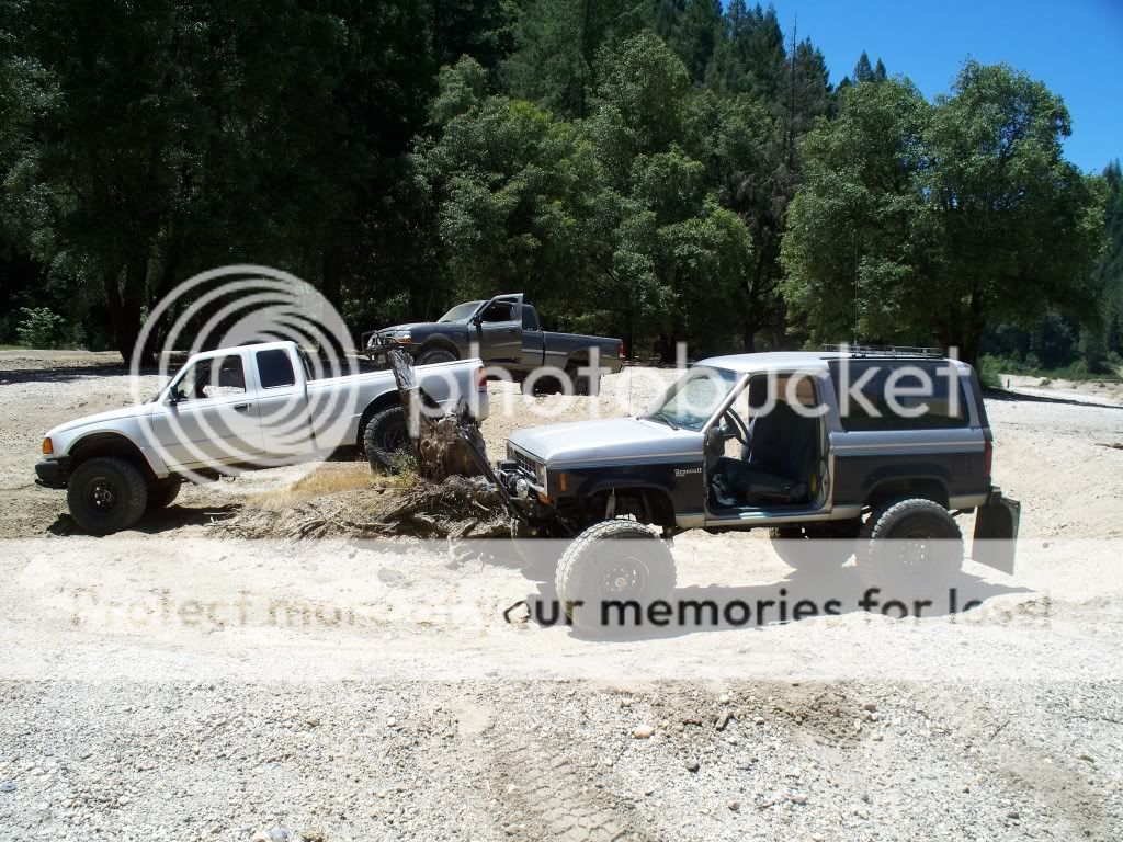

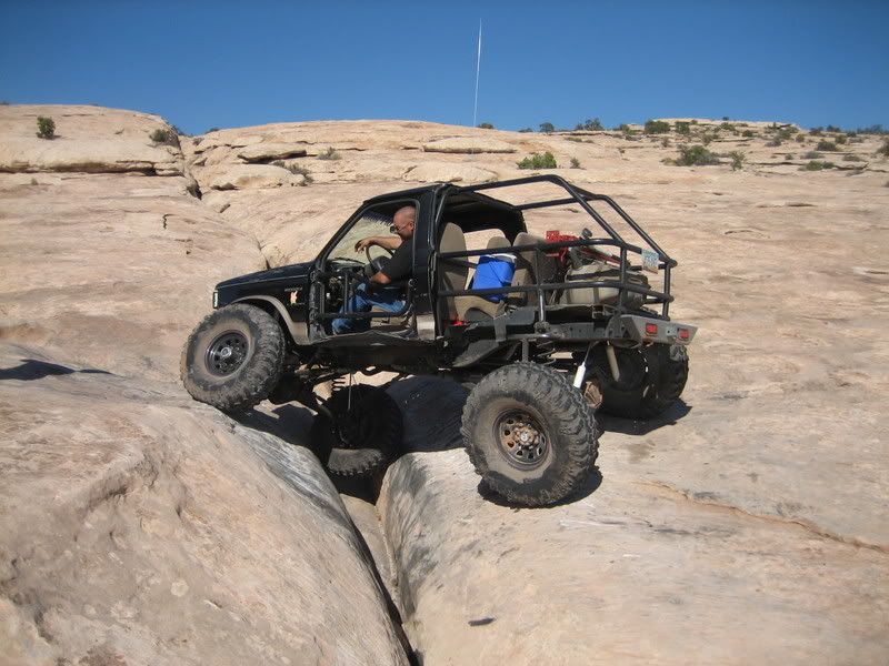

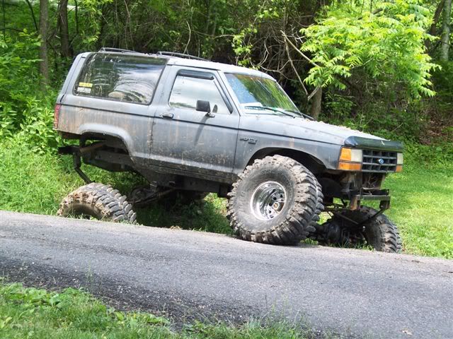

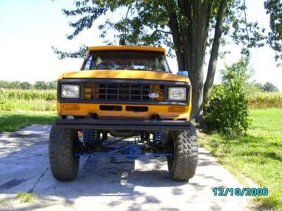

Here are a bunch of full width SAS BII's I cataloged a little while back. Enjoy.:D A few more have popped up since then too.
Well good luck with that. There aren't that many FW SAS BII's out there and there are even fewer on 33"s. If they are available then run them, or sell them and get something bigger.
