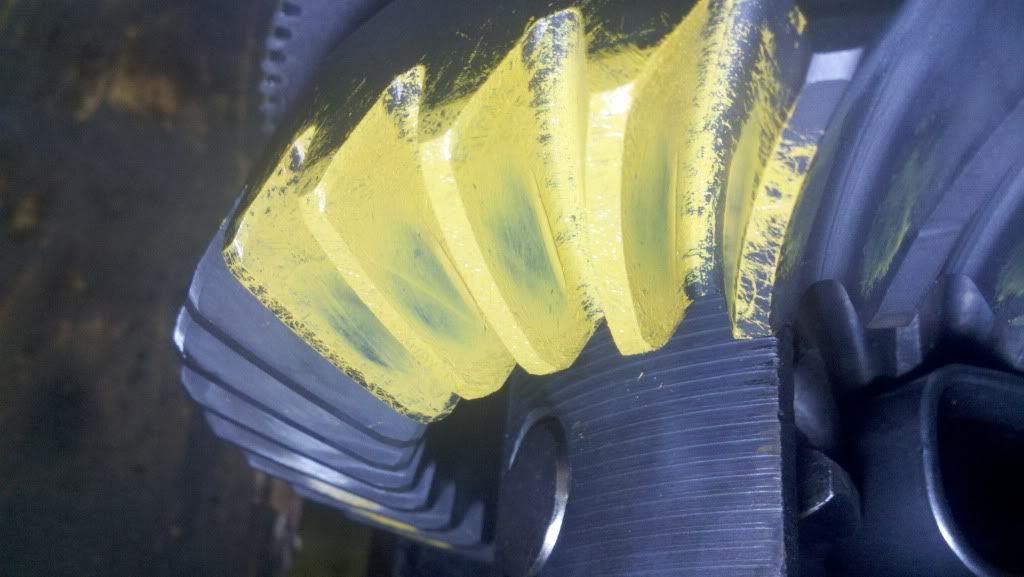

How does this new 8.8 pattern look?
This is with the pinion .002" deeper.
Sent from my DROIDX using Tapatalk 2
I emailed the UPS label to you. Actually, it's a link to the label you can print out and stick on your package for UPS.
Looks like you need a bit more pressure on it.
Try turning the diff using a wrench on a ring gear bolt while putting light resistance on the pinion, this usually gives a more readable pattern than if you're turning it by the pinion gear.

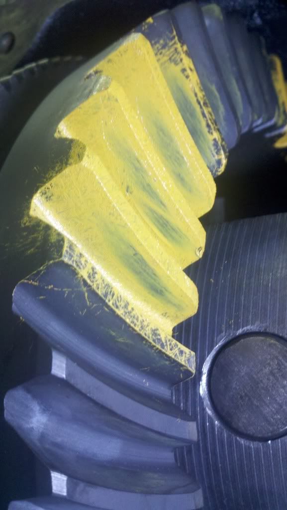

Are these pics better?

Whats your backlash at?
I'd run that no issue.
I'm with Sasquatch. If your backlash is in spec I'd start buttoning her up.
.011"-.013"
Its in spec. Thank you all.

Agreed, looks good to me also.
I assume that "nick" or something right at the toe of one tooth is just the setup grease? (not the tooth itself)?
