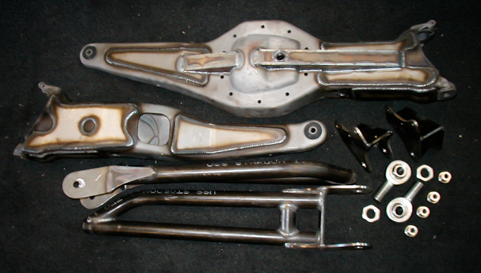

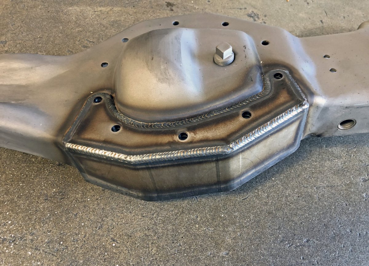

I’ve been looking for some weld on beam armor for my D35 but no one makes it as a kit. Anyone wanna make some $ to fab some up from 3/16 plate for me? I don’t have a metal break so I can’t bend it.
I’d like to have bottom plates for both beams, a plate for the front lower half of the diff and a plate across the front of both beams that goes from knuckle to pivot bushing.
I attached pictures to show what I want. I can get the weld on diff armor from solo motor sports but if someone is willing to fab up this armor, I’ll buy it from them instead.

That armor plating for the driver's side beam looks pretty easy to make. I should figure out how to draw that and cut it.

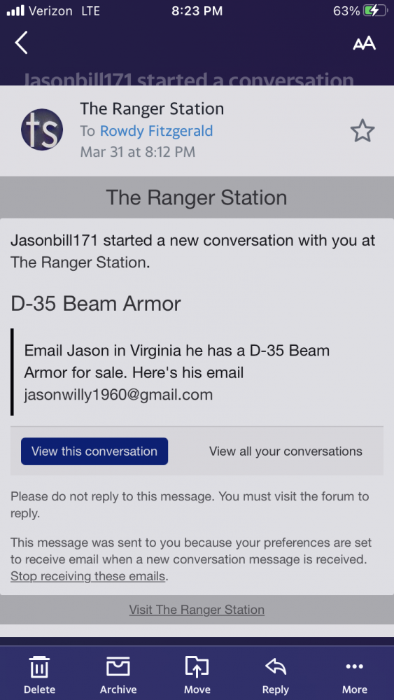

So I had a scammer hit me up on here trying to sell me D35 armor. His name was Jason something. He referred me to another guy named Jason (jasonwilly1960@gmail.com) They both had bad english, like as if english is their second language. I believe it was the same scammer. He stole a picture of Plumbcrazy’s home made diff armor then tried to get me to buy it for $200. I was already suspecting it was a scammer so I searched for D35 armor and found the exact picture in Plumb’s thread.
This was the scammer.
