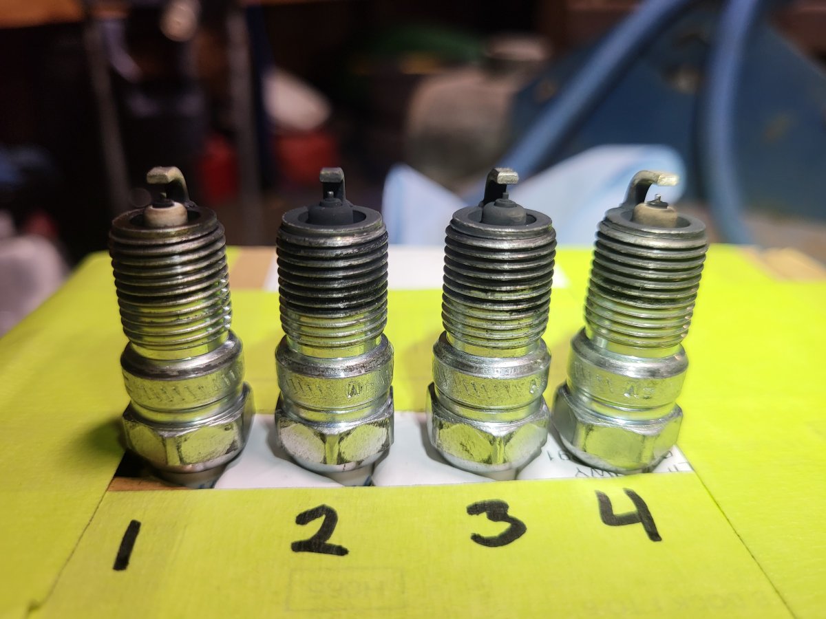

1990 Ford Ranger 2.3 5spd. I have lots of exhaust popping and sometimes the engine will POP POP POP and die when you open the throttle. I took the plugs out and #2 and #3 appear to be fouling. I've read from someone in the forum that 1&4 injectors are grounded together and 2&3 are grounded together from the ECM. My thought is the ecm driver for these injectors isnt quite right. What else would cause these cylinders to run rich? My compression is great in all, 15% difference in total.

Possibly. Either those plugs are not burning hot enough or mistimed. Or the injectors are staying open way too long and fuel is going into the exhaust.

I think you're right. Injectors 2 & 3 are grounded together and both cylinders share the secondary coil on the coil pack. So, the ignition module could be partially faulty (somehow), or the crank sensor is for some reason sending off time signals. I will check the crank sensor, but whatever part it is, they are not cheap!
Crank sensor is common to all cylinders. Probably not that. DO check the tone ring on the crankshaft for missing/broken teeth.
