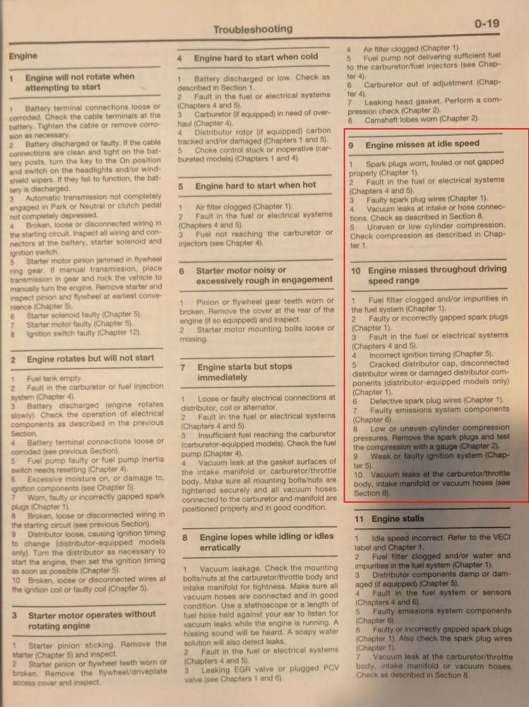

Another question to make you ponder.... Does it miss only at idle, or at all rpms... that gives you some different angles to troubleshoot.
(Haynes)
