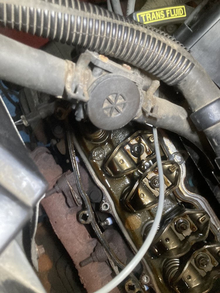

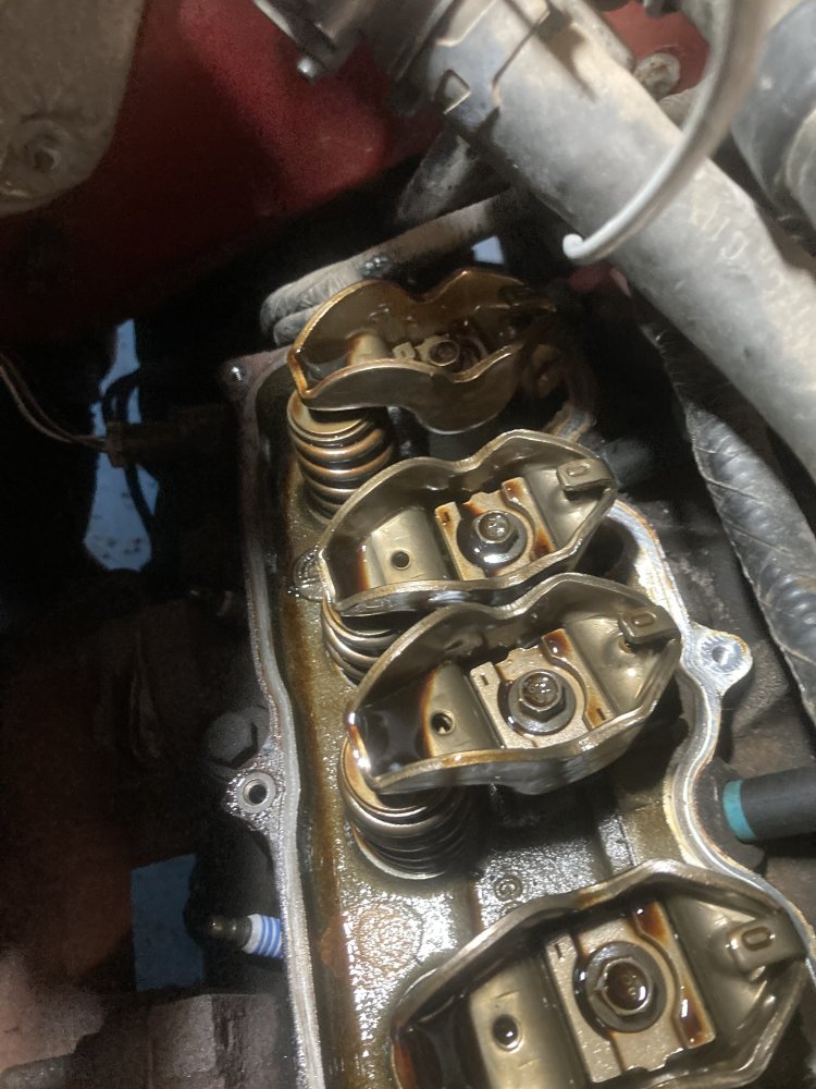

Ok I pulled the valve cover today and found something very interesting the return spring for the exhaust for 3 has snapped and I believe that’s causing my issue now I must ask what to replace obviously the spring and valve cover gasket but should I replace anything else?

keep digging.
check the pushrod for that rocker arm.
is it still in place???? is it bent? are the ends chewed up? it's hollow, oil flows thru it to lube the rockers.
the valve train is not adjustable. the parts are manufactured to fit properly so long as nothing is broken.
you simply bolt the rocker back on and tighten it down. the push rods should tighten up during the last turn, or two, of the rocker bolts.
that's the pre-load/lash.
have the valves ( camshaft cycle ) in a closed position when tightening them.
before you try to remove the spring retainer the valve must be secured so it won't drop down into the cylinder.
service manuals and others use compressed air thru the spark plug hole to keep the valves closed while servicing the spring.
that works, but I prefer to fill the cylinder with rope then rotate the crank to force the rope against the valves.
you can then leave the project for however long you need to.
it would be a good idea to look thru the pushrod hole to verify the lifter alignment bracket ( AKA dog-bone ) is still in place.

ok yeah the pushrod is still straight as an arrow and undamaged should i still replace it i know i have to replace the spring but should i also replace the push rod and rocker arm ?
if it's straight and the ends are not chewed up I would reuse it.
make sure its clean inside, quick squirt with anything.
check the rockers, if no damage reuse. they will have a wear pattern, 2 angled ridges from the pivots.
at this point try to pressurize the cylinder. if the valve was bent by contact with the piston it won't seal.
Roll the pushrod on a flat surface. If it's bent, it will be obvious. There are two ways to hold the valve from dropping into the cylinder. Most common is remove both rockers from that cylinder and feed compressed air into the spark plug hole. Another is pull the spark plug and feed clothesline into the cylinder, then rotate the crank by hand to compress the clothesline against the valve. I would replace that spring and then do a compression test on all six cylinders.

right that what I'm afraid of but i believe i am just going to order a new valve cover gasket and spring and replace it and see what happens but you dont know how happy i was to see that spring and when i tell you its doing nothing anymore it is not doing anything i can really move that rocker arm around in there
ok that sounds good i have another question I'm on rock auto and there are different sizes and heights of springs and i am not too sure which one to buy
You can order one of each of the 1.834 and 1.776 free height springs, they are cheap. Do you have the tool to compress the spring?
