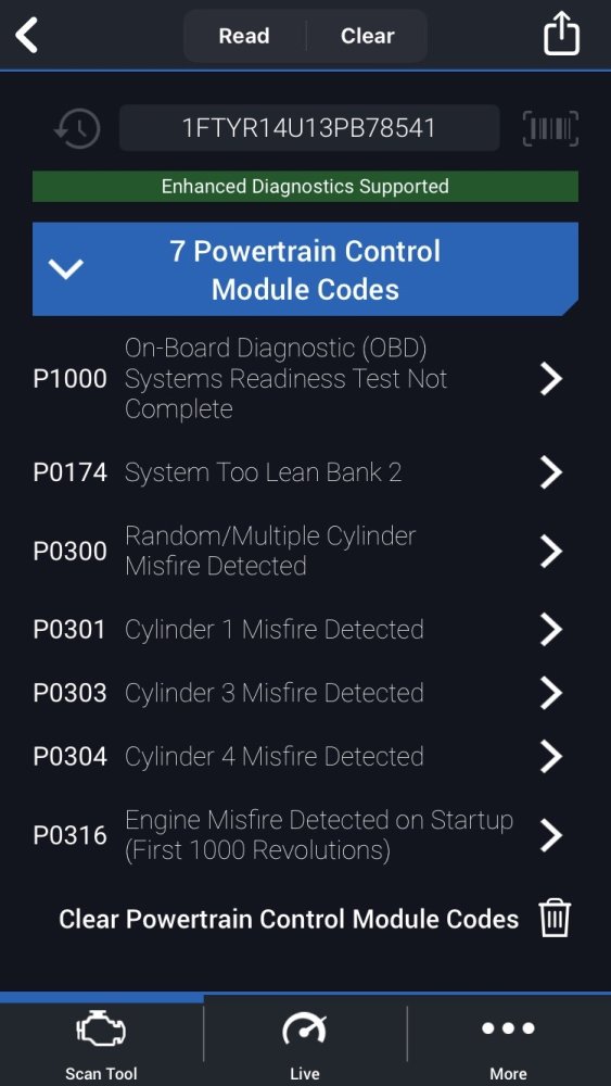

so i used my obd2 scanner and it came up with these codes (see picture) but yeah i saw all those codes and was like WHAT 3 different cylinders misfiring and i was like ahh shoot this is going to take a while so i ordered the spark plugs and all ignition stuff but in the meanwhile i tested the injectors and they were clicking away so it wasn't fuel also when it was running and you are standing next to it it smells like fuel. but yeah that all happened and after replacing all ignition stuff i did a compression test on 1 and 2 and 1 was 176 and 2 was 150 then the battery died so i stopped that um pending the rest of the cylinders but i dont think its compression because one of those codes is a too lean code which would mean two much air so i have no idea. oh also i just replaced the MAF sensor today and it did nothing but while the truck was running i swear i could hear a clicking coming from the engine so maby a lifter but that wouldn't explain all 3 cylinders i will investigate that further and do more compression testing.

Did you have the same 3 cylinders misfiring? That would be good info.
right so i scanned it 3 different times but thinking now i never reset the check engine light so maybe i should do that to see if it comes up with any other cylinders oh also the check engine light is one um and when i drive it the check engine light flashes

Just to be clear - do you have a 6 cylinder or a 4 cylinder? You mentioned checking one and two, then three and four but didn't mention five and six. Misfiring on all cylinders raises different questions than some cylinders.
ah shoot sorry ok only 1 3 and 4 are misfiring or at least thats what the codes say but 2 5 6 appear to be fine also i do not recall a loud squeaking or chirping noise but when i do tests tomorrow i will listen for that also yes i have a 3.0L 6 cylinder sorry i didn't clarify that either thats all like 101 troubleshooting .
