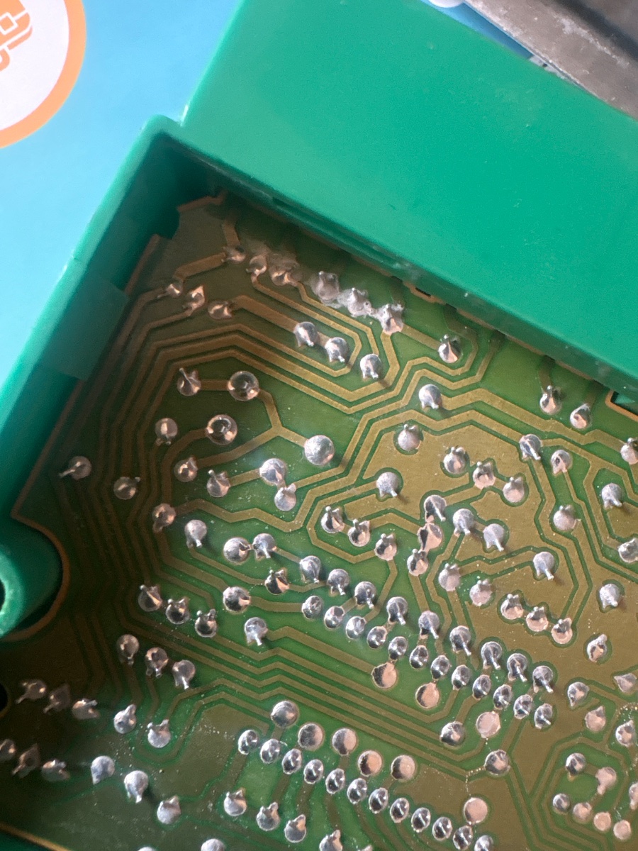

Guys I got the module out of my truck and the circuit board looks to have a little corrosion on it.

With the servo unplugged, the board is out of it, does it still rev the engine? The engine should not rev if the truck is sitting still. If it doesn't rev anymore, I think your circuit board may be suspect like you are thinking.
I tested if the engine revved by bypassing the other end of the servo so it just made sure it was mechanically working I don’t think it’s electronics working
