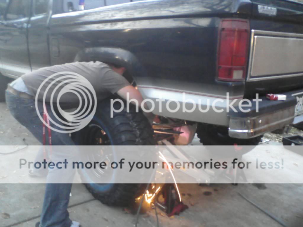

ripped out the 7.5 with the help of moose knuckle fab.

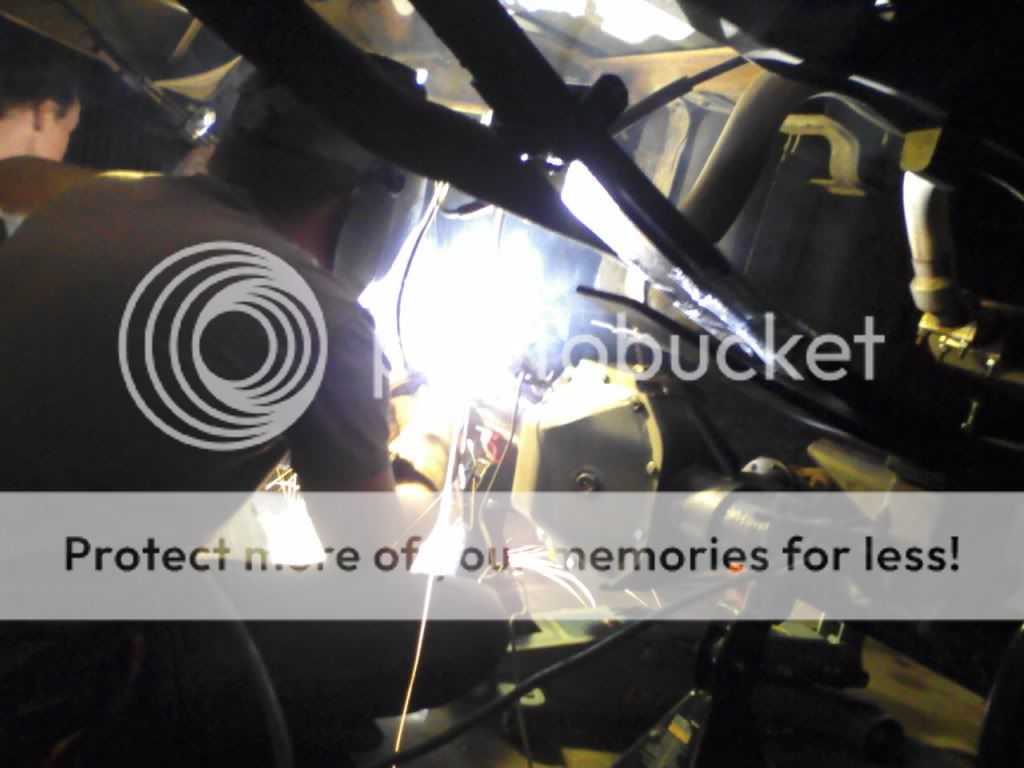

tacking up the 8.8 on its own weight.

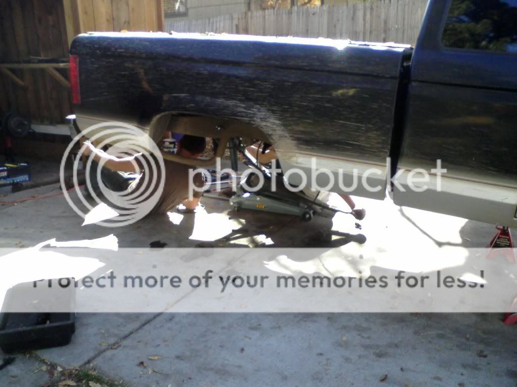

and now to do the front, ripped out the old still got a ways to go
