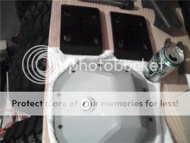

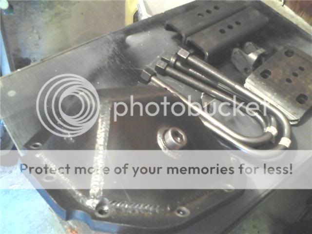

its good shit. got mine the other day and did some painting. diff cover still had some slag and metal shavings in it so I cleaned it up real good with a wire brush and some brake and carb cleaner. I also started in on the rivets to make the lift install go faster. first one took for ever but when I finally figured out an easy method they werent so bad(drill em through, shave the heads and punch em out). Had to shave a little off the fuel filter mounting plate as well for it to clear the bolt and nut on the inside of the frame for the radius arm bracket.

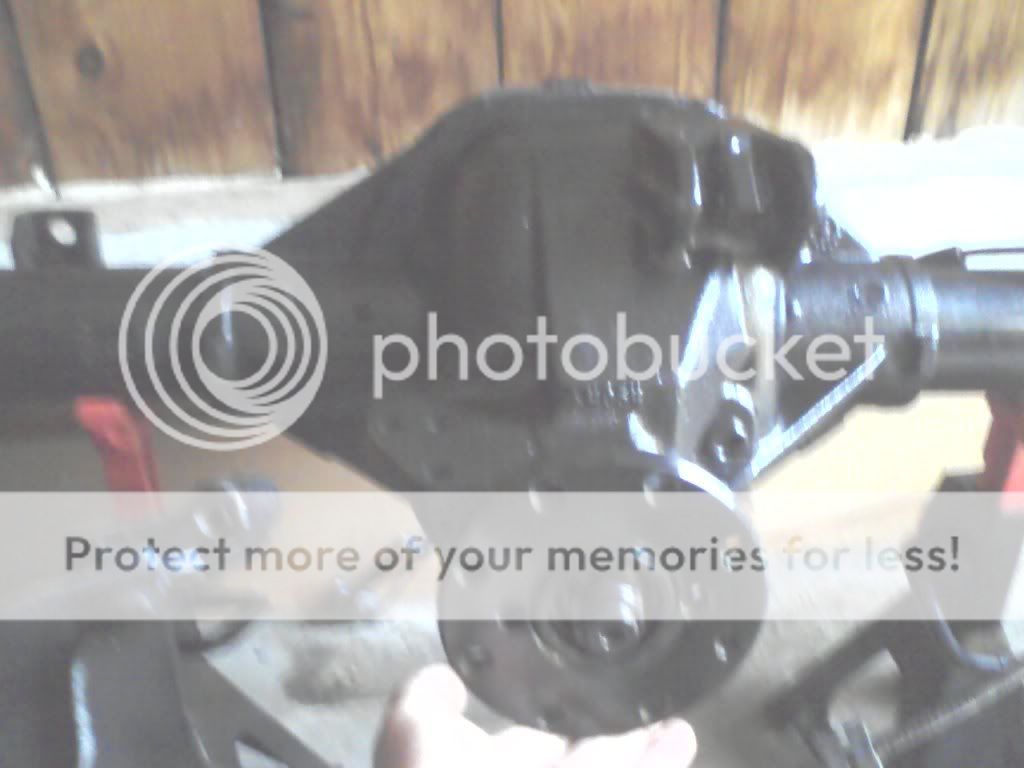

8.8 is back loaded with truetrac and 4.56's Front range driveline did a hell of a job and were about 400 cheaper than anyone else that I called. The rest of my parts are on a ups truck headed to my house as we speak.:shout:
