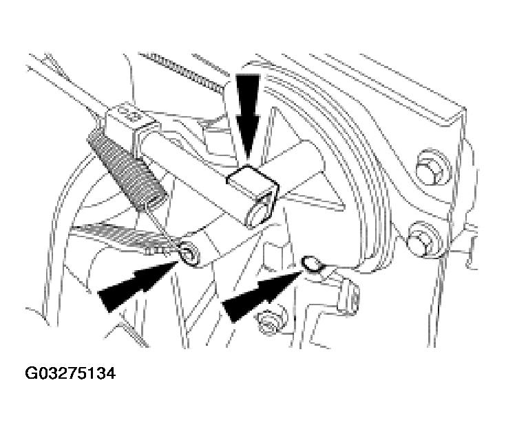

I have mis-assembled the throttle body. Examine this 3rd party copyrighted (probably)picture to help. See prev article for stackexchange source (not likely primary).
I can not crank past the accessories coming on , incl fuel gauge. It doesn't cough but intake manifold and air intake have been reassembled properly I think.
Ideas?

You got the image from here: https://mechanics.stackexchange.com...-and-idle-air-control-replacement-ford-ranger
So are you asking about the throttle cable linkage?

The image I am trying to decode what perspective it was drawn from and continues a related question I posted.

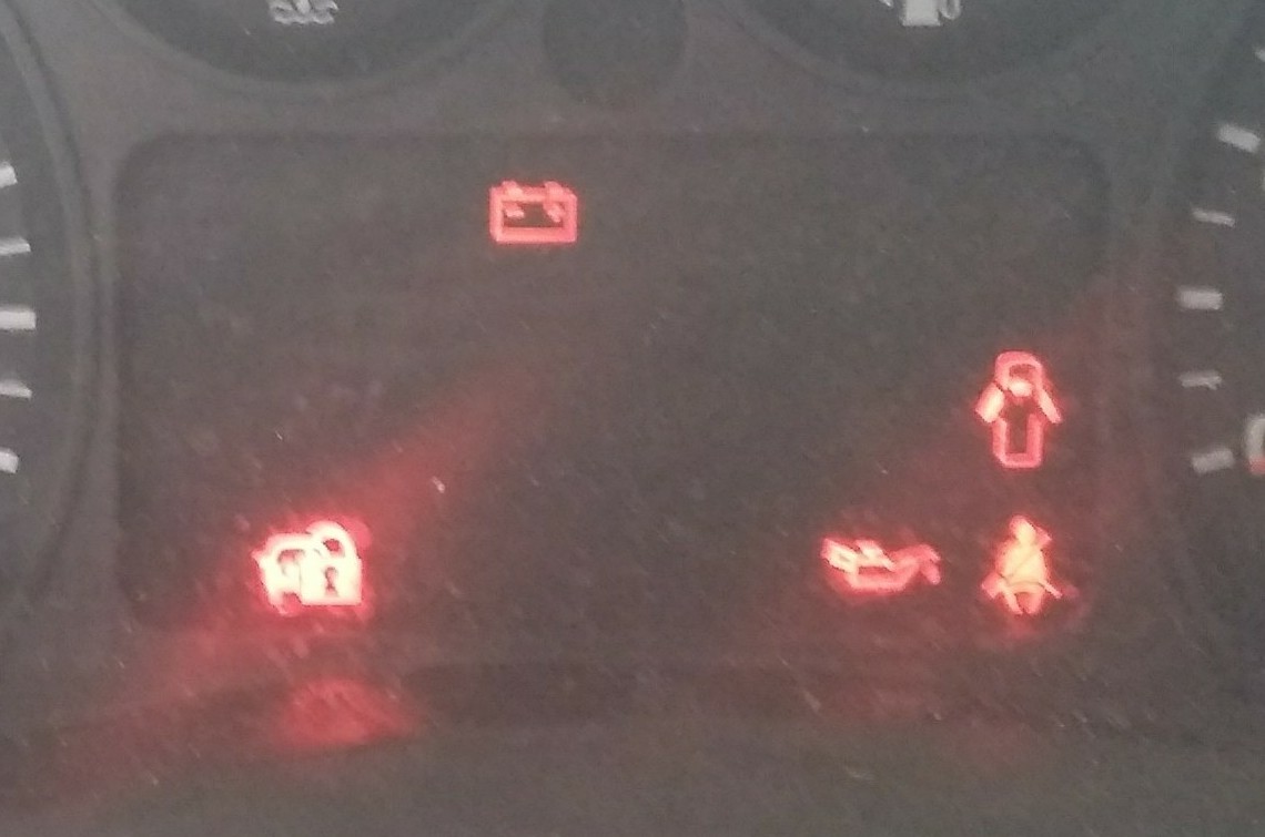

Hello,
Thx for your help so far.
Trying to start gets the cabin heater airflow to stop and control panel lites to come on including the lowest left hand light that I don't recognize(looks like a car+ lock maybe.

The picture o forgot
The picture I forgot.

The Car with Lock symbol means Immobilizer is activated, which is why engine will not start
Do you see any lights flashing?
Take out the key and lock and close the doors(leave window down just in case) then unlock the doors with key fob and then try to start engine
If that doesn't work unhook 1 battery cable for 5 minutes, then hook it back up
Unlock doors with key fob, even if they are not locked, and try to start
Removing battery cables does not reset immobilizer

Is there a Flashing Light with key on?
If immobilizer light stays on steady then leave key on, do not try to start engine, wait for at least 1 minute and then see if the immobilizer light starts to Flash a Code Number, like 1 quick flash, short pause then 5 quick flashes, then Long Pause, and it will repeat the 1 and 5 again, thats code 15
Override immobilizer codes
