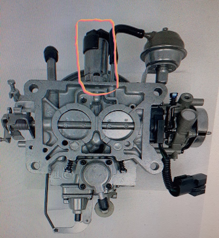

I previously mentioned the relay starting to click after the ignition key was turned off, i have identified where on the carb is also clicking (circled in photo), just don't know what it is or if it is relevant to my problem.

I believe that thing on the back of your carb is the mixture control solenoid. Why it's clicking, I don't know, my troubleshooting on feedback carbs goes far enough to remove it all and do the Duraspark swap but I'm not sure you can do that in NY if you have to pass smog.

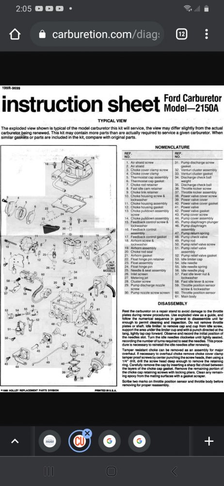

You have a 2100 or 2150 carb, have a look here: http://grantorinosport.org/bubbaf250/carb/carb02.html
Go thru ALL the pages there to see all the parts
Your carb will most likely be an "A" model, like 2150A, which means it has computer control parts, called a Feedback carb

That pic of the carb is a 2150a feedback carb. All you can do is set base timing after you disconnect the spout wire at the distributor. You will see on the harness coming out of the distributor there is a single wire connector you need to disconnect it for base timing. Once you set the timing at exactly 10dbtdc plug the spout back together and watch the timing marks. Turn the ignition off and disconnect the battery posative cable and short it to ground to reset the computer. If the feedback solenoid on the back of the carb is clicking that tells you the computer is working. The tech library has a section on the EEC-IV diagnostics you can pull the codes with a test light or code reader but being over 30 years old parts are impossible to find. The duraspark distributor is getting real rare now also for the 2.8 but it will bring the engine to life again if the computer pukes on you.
