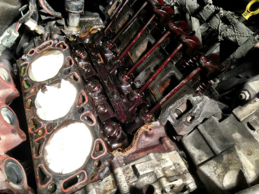

Pulled valve covers and intake, the passenger side bank look horrendous with coolant all over the area of cylinder 3. Pulled the head off, have not yet cleaned everything but no visible cracking. The head gasket was examined by myself and two friends and looks perfect. The internal condition of the motor is fair, reddish varnish, but all rods are straight and no other visible damage. Some sludge and carbon but nothing tragic for the miles.
I normally would have done through checks before disassembly, but having had similar happen on other cars I was betting everything on the head gasket having blown - I worked on the thing for about many hours to get to it, so if it was obviously bad I would have reassembled it there in the parking lot and been back on the road by the next morning after the epic effort, unfortunately not so luckly. =(

Pulled the other head and found one valve to be badly recessed into the seat. And that was on the "good" side. I am quite surprised it didn't cause a miss or a CEL on its own! Vulcan 3.0 must be a beast.

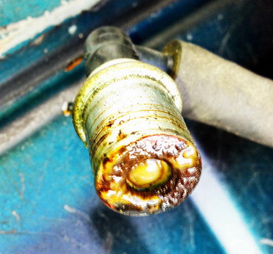

Attached are the promised photos. I am going to try to get heads into the shop on lunch.

I know you don't wanna hear this, but you simply wont know how much damage there is unless you look at the whole engine. Also the temp gauge would be slow to read hot if the engine was way low on coolant. So you may have run it hotter than what the gauge was telling you.

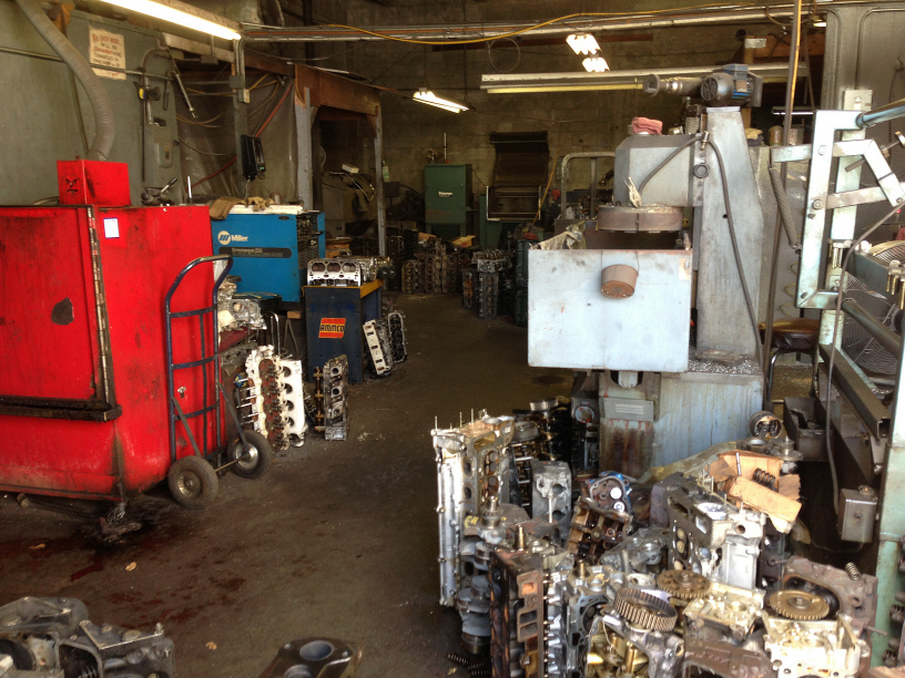

Got them both out and made the machine shop stop yesterday on my lunch. Found the expected results.
Drivers-side head (the "good" bank) has some dodgy valves with one seat in rather bad condition and 3 minor cracks near the bolt holes, which they indicated would likely not cause problems unless the head was reinstalled as-is. This side was warped to 0.004" also.
The passenger-side head (the "bad" bank) has a major crack (but not in the cylinder with the issue!), 2 minor cracks, and was warped to 0.006". After a thorough cleaning and visual inspection the machinist also showed me there was a discoloration between the water jacket outlet to the block and the chamber in affected cylinder, which might be an indication of an issue with the gasket in that place I wasn't able to see.
Based on the costs, it makes more sense to get a set of re-manufactured heads for about $400 rather than $250-$275 to get these refurbished.

There are two temp sensors on most fuel injected engines, a 2-wire sensor for the computer and a 1-wire sender for the dash board gauge.
To test if its the gauge or sending unit that is at fault, remove the 1 wire from the temp sender on the engine, turn key on, gauge should go all the way up or all the way down, now Ground that 1 wire, gauge should reverse it's position.
So if it was all the way up it will go all the way down or visa versa.
If gauge does this then replace the sender or if you used a sealing tape on the threads remove it and reinstall the sender to test, the threads of the sender need a good ground to the engine for the circuit to work.
If gauge doesn't move at all then either the wire is bad(shorted) or the gauge is bad.
