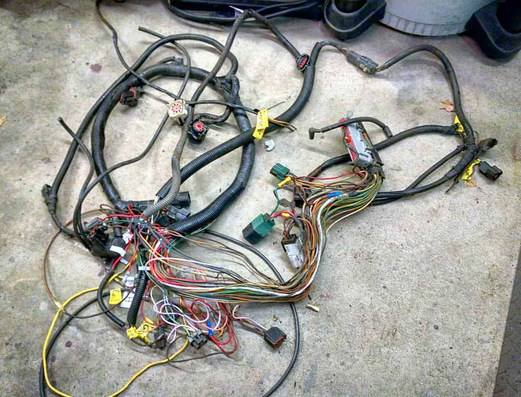

first gone was the harness
which felt awesome to get rid of.

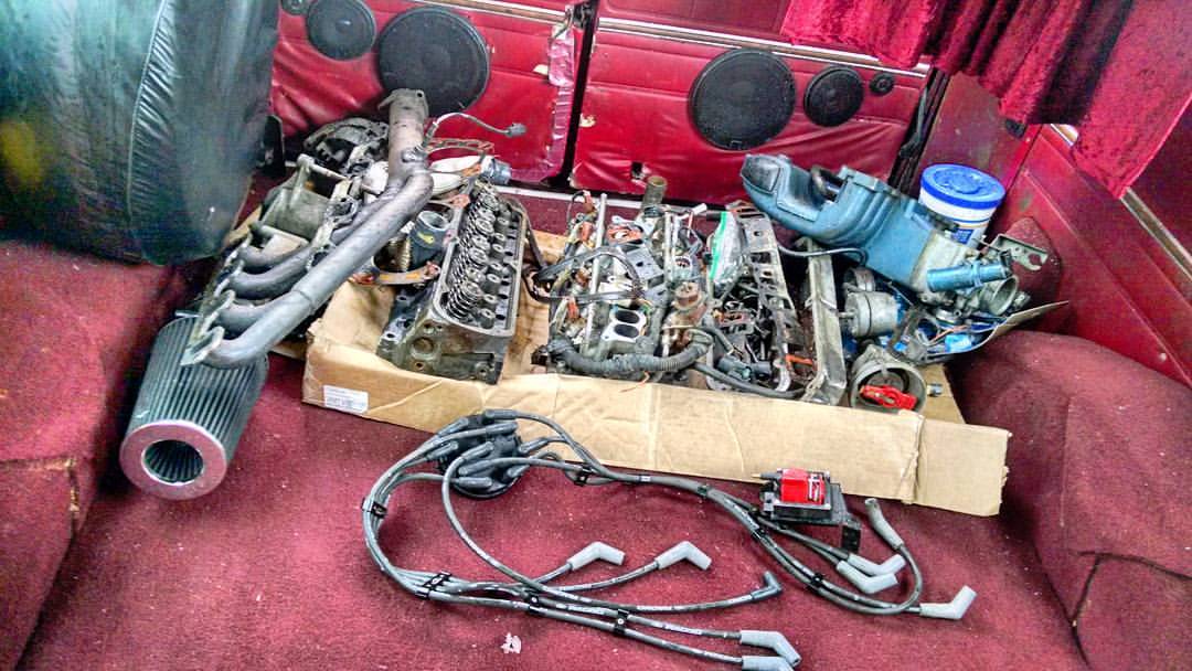

pulled the accessories, bunch of top end stuff then the intake manifold.

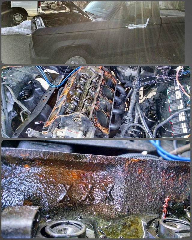

once we got the intake manifold off we discovered what looked like a TON of red permetex between the heads and the block.
so putting 2 and 2 together from months back when we found a freeze plug blown out, which issssss common with these 302s, but then there were cracks in the intake manifold where coolant flows, this was starting to look like there might be a cracked block hiding under the hood that somebody tried to bandaid.
didnt want to waste any more time or money, so we pulled the heads off to see for sure if the block was safe to keep building on.
and guess what, HUGE cracks in the block between the coolant passage ways. which someone tried to permetex up and bolt all back together.
(dinner of champions)

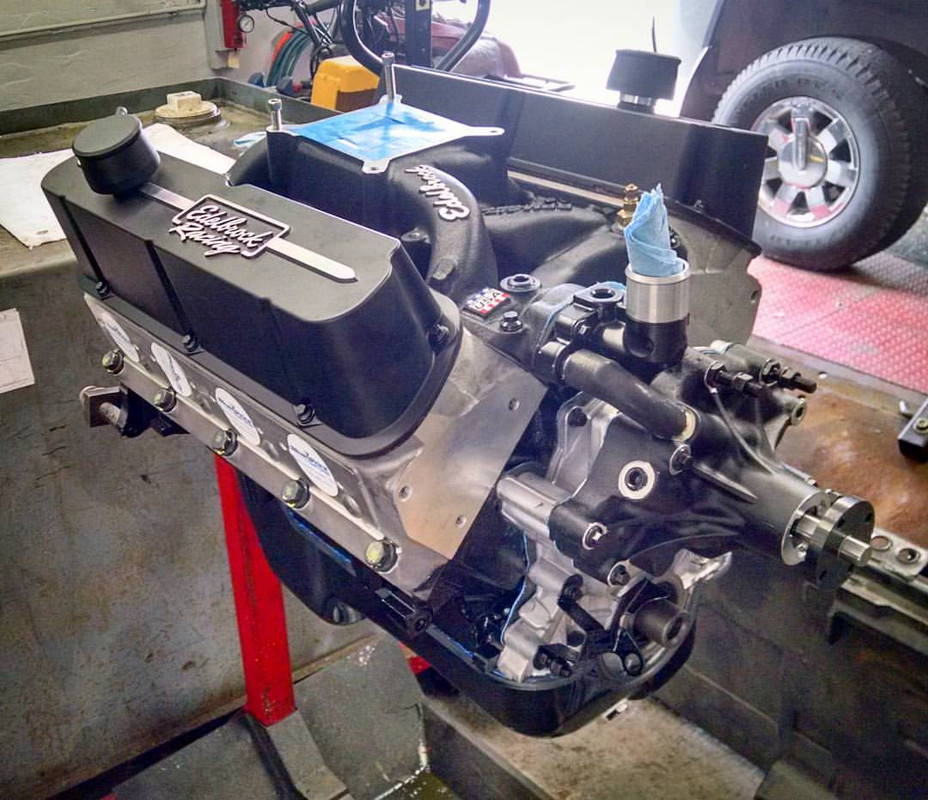

Engine is a .30 over 302 roller block, all new forged internals, with an aggressive cam. and 190cc aluminum heads. our engine dyoned at 390HP and 380ftlbs to the crank.
here it is as it arrived to us

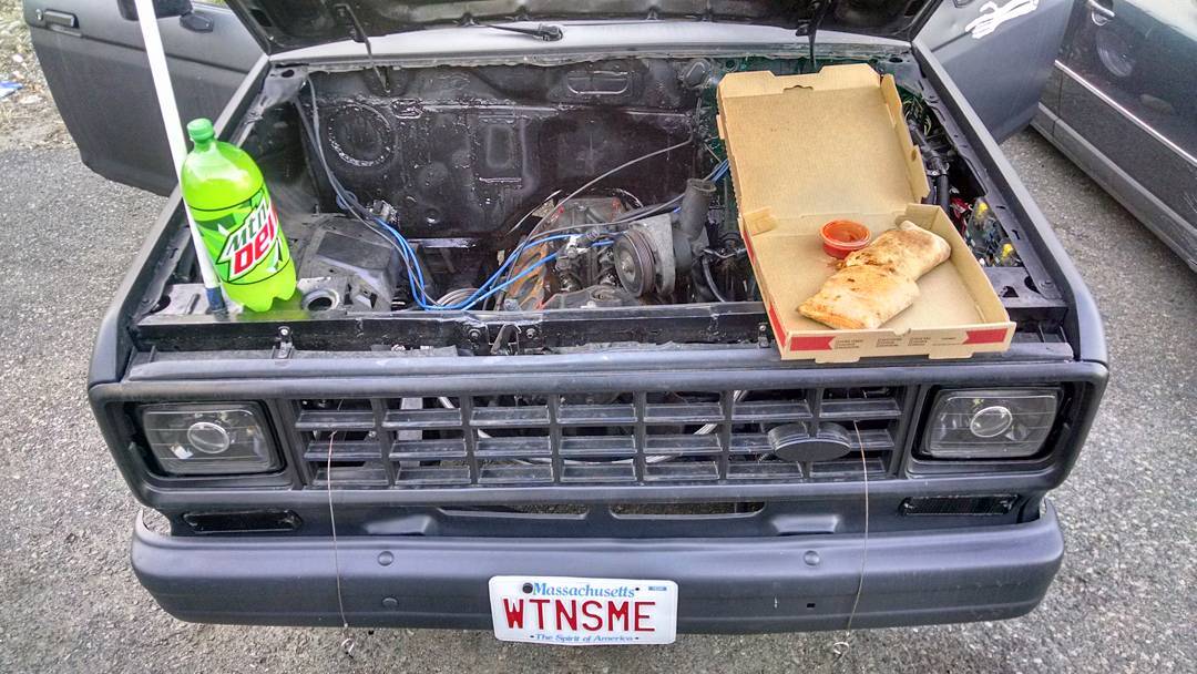

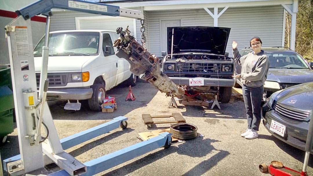

first we had to pull the old block.
we disconnected the tranny cross member, and left the tranny on for the pull
stay tuned for more fun pictures of assembling all the new goodies on the new engine and squeezing it back in there.

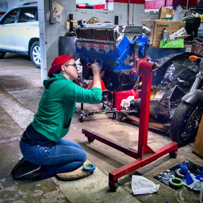

so first thing was first,
Blueprint ships these engines in Blue, as pictured above, but the ranger is black on black on black (with aluminum wheels) , so of course we we had the engine out of the truck, might as well paint it.
so we taped everything off, and went at it applying a high temp VHT Engine paint. i talked to blueprint first and this is exactly what they recomended and say its done all the time with their blocks.

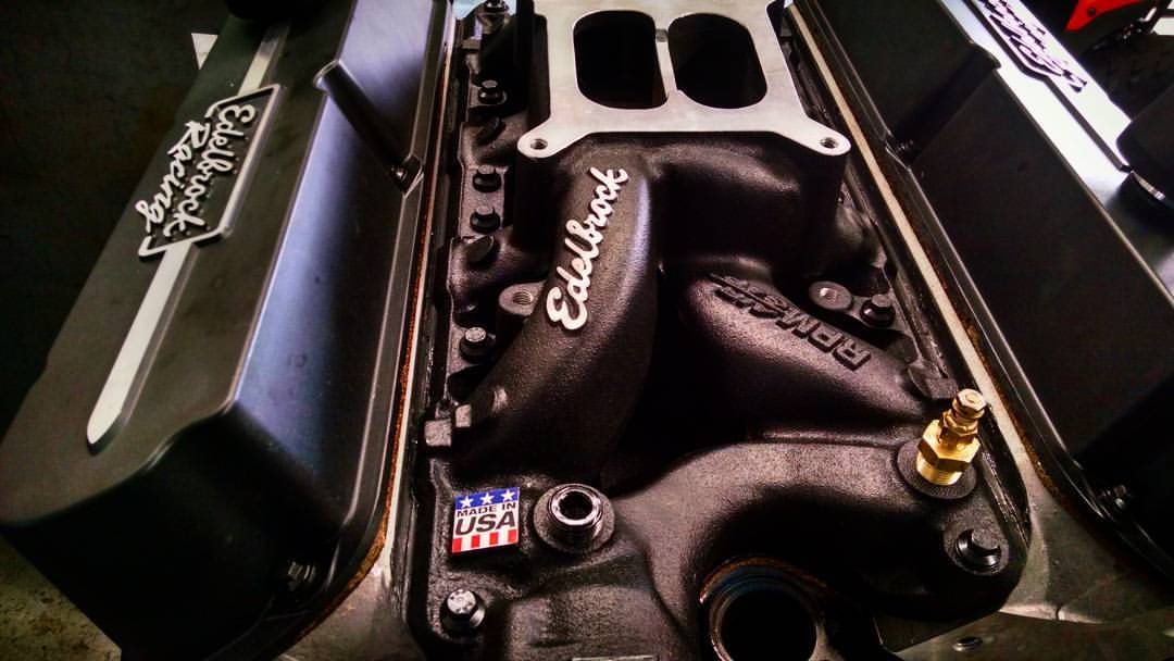

slapped on a pair of edlebrock tall cast aluminum covers. similar seal style as the stock 5.0s , so chances are they won't bend and leak like every cheap pair of thin sheet metal covers ive ever owned.
up next we had to swap out the timing cover.
blueprint ships these with a timing cover for a standard rotation water pump and mechanical fuel pump.
i'm reusing the electric fuel pump in the bed by the fuel cell that i ahd setup for the efi, AND i wanted to keep this a serpentine belt setup, which, you need to run a reverse rotation water pump, which means.... we needed to put a different timing cover on.
then came to find out that i also needed to drop the oil pan inorder to do the gaskets right and properly clean everything.

then managed to slap our new airgap intake manifold on
followed by jr victor high flow water pump
i did a little powder coat sanding work on the water pump logo to make it match the intake

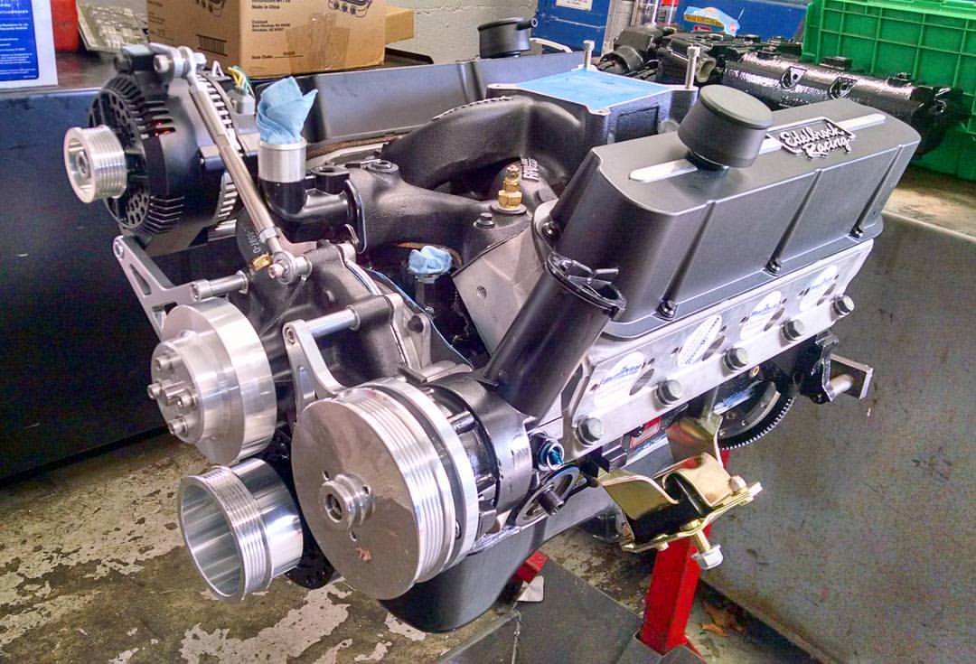

next was time to start throwing on accessories
bought alternator and power steering mounts from March Performance
put on a 130amp alternator from SVE bought through LMR mustangs, along with a mustang power steering pump, and under drive pulleys from BBK

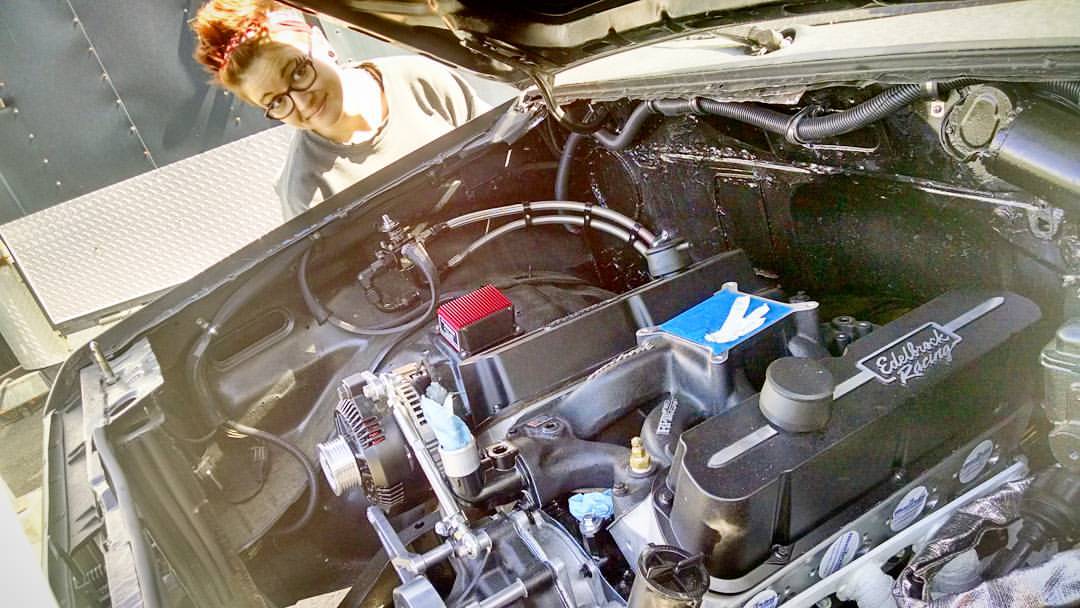

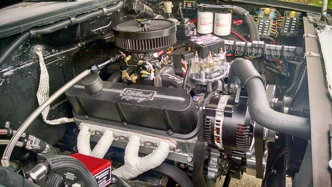

so hear the engine is sitting pretty in here
this is what i did to modify the fuel setup.
when i was planning on keeping the efi system, i installed a fuel cell and a bocsh 044 fuel pump setup in the bed, along with a -10AN send line and a -10AN return line, straight into and out of the stock HO fuel rails.
i used PTFE line with a stainless braided cover. as apposed to rub line, ptfe is supposed to last forever without needed to be replaced.
anyway, i cut the send and return lines back and mounted an Edelbrock fuel regulator on the fender. i then ran a 3rd line from the regulator to the to the carb. set the regulator to 5psi, and good to go. also installed a fuel pressure gauge sender.
the red box underneath is the Rev limiter by Performance Distributors (same guys i had setup the HEI distributor). its a pill style soft rev limiter, so i can set it up for 4500 rpm while i break the engine in, and then give it the full 6,000 rpm redline after 500 miles.

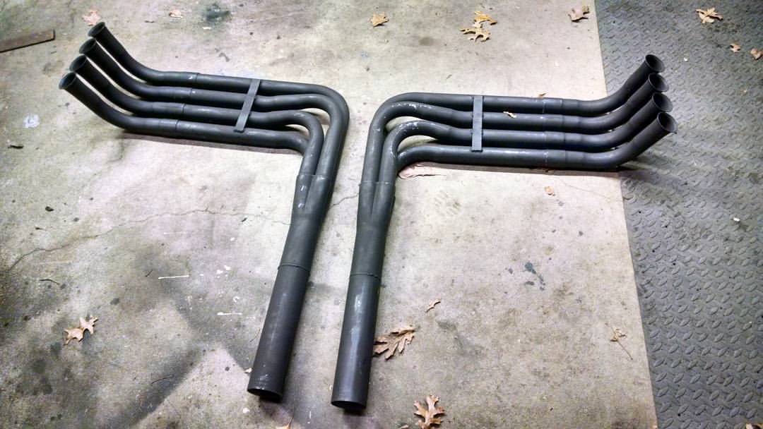

next on went some headers. this drivers side one was pretty miserable. especially with header wrap on it.
i ended up buying a tap and die set and chased every bolt hole on the aluminum heads and ran every header bolt through the die just to make sure they were all perfectly threaded and would go in smooth. this made a HUGE difference and helped a ton.
i used Stage 8 Locking header bolts, so i dont have any fear of them loosening up
the header on the other side wasn't much better.

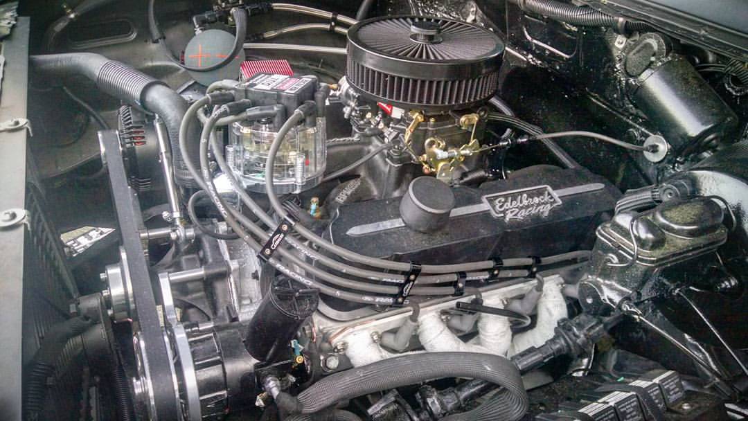

got the carb on and hooked up, found top dead center and got the distributor in, wedged the triple core mustang radiator back in there, got hoses hooked up, and measured for the new serpentine belt and got that in there. fit mint. these March Performance adjustable alternator brackets rule.
then we installed the plugs, wires, and the new throttle cable from Lokar. the bracket setup from Lokar is sooooo clean for these edelbrock carbs i had to do it. im used to some haggard frankenstein thing that flexes like i have on my 4x4 van, but this is perfect.
oh, also forgot to put the dip stick tube in so had to take that driver's side header back off.

this is what the Driver's side header looks like, before i sanded it, painted it, and header wraped it.
some serious FrankenHeader stuff going on there right?
its strange, its ugly, but it fits, so im not complaining.

got the truck running, first try
took a few minutes to tune, and good to go.
