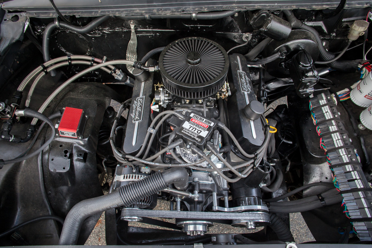

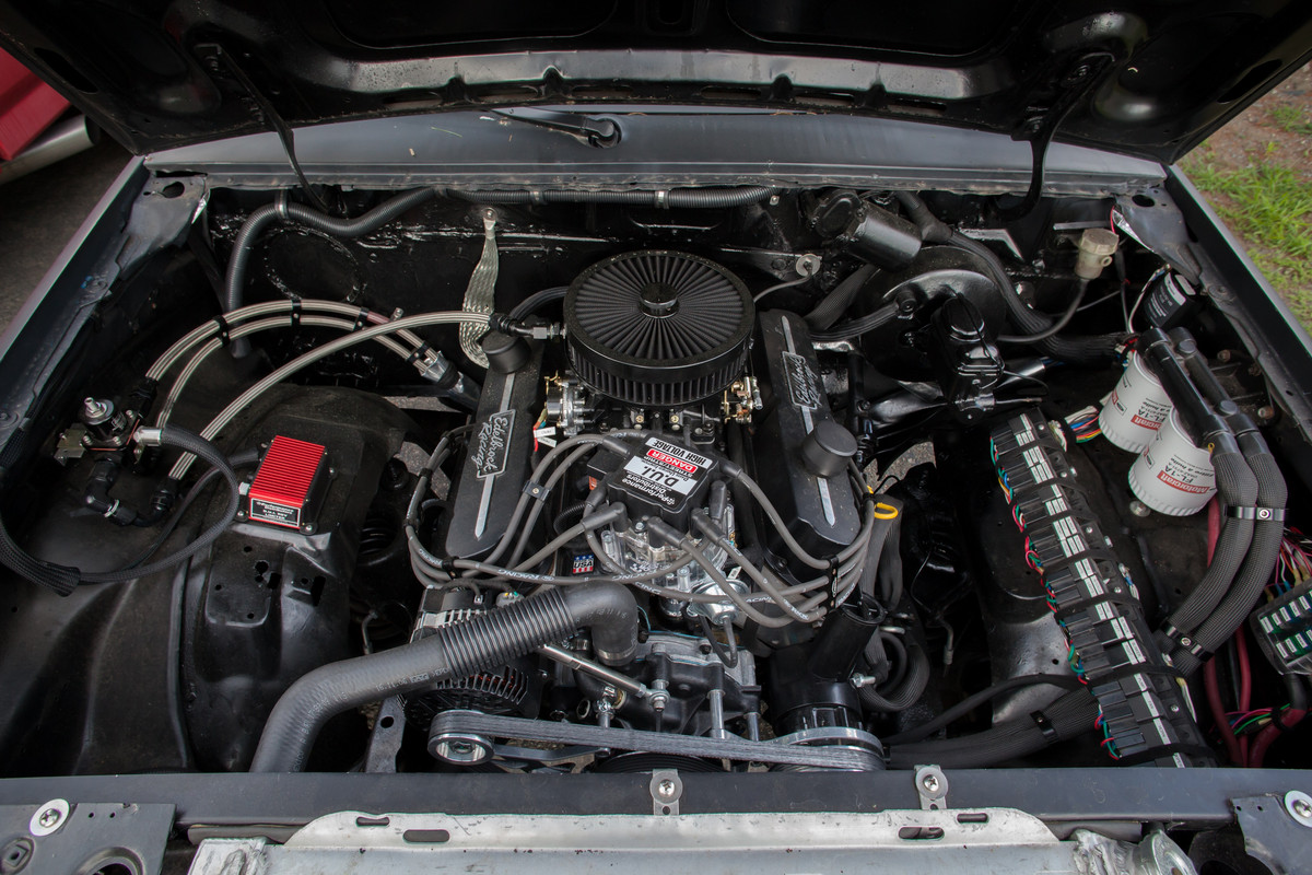

here's some slightly larger pictures of the engine all done in there

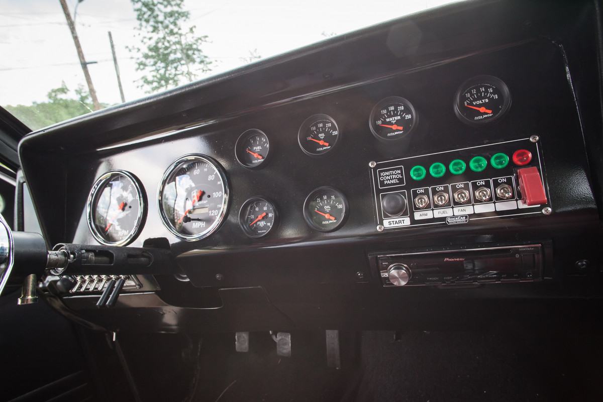

here the interior as it currently sits. still need to put in the new carpet and swap out the ranger 60/40 for the MustangII buckets i have

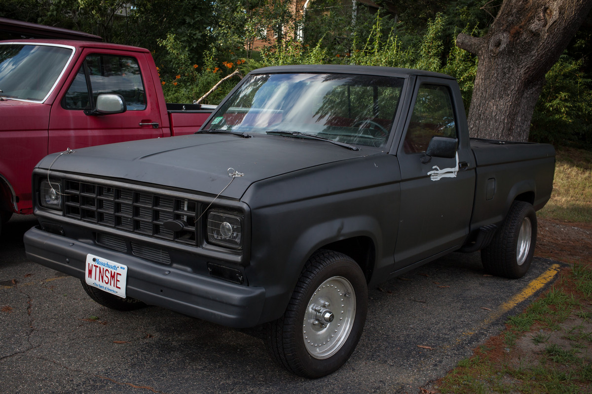

and here it is sitting rather majestically

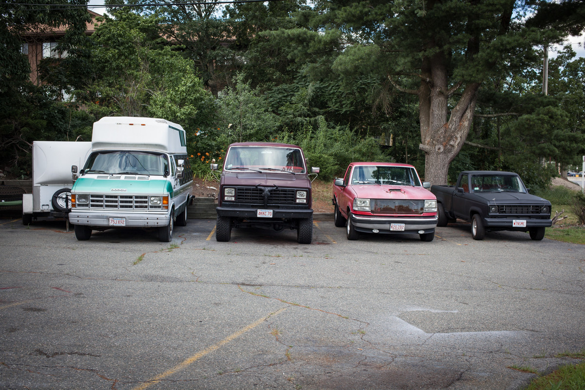

this is it with the rest of our fleet
1985 Fruehauf enclosed trailer, 1992 Dodge Ram B350 with bus conversion, 1982 Ford ClubWagon with 4x4 conversion, 1993 f150, and the little 83 ranger
not that i dislike the way this thing looks from the front, but it definitely has a sweet looking back end as well

Damn guys, I don't know how I missed all your updates, I guess my app doesn't work well but holy hell, ur progress on getting this swap done is insane! Truck looks n sounds meeeaaannnn. I really dig it. Alot of the pics are not showing up but the vids work and [emoji106] [emoji106] [emoji106] [emoji469] [emoji469] [emoji469] [emoji482]. The zoomie exhaust out the back looks cool as all hell. Next up is a burnout vid please :)
thanks man.
and hmmm, weird. it looks like they are all showing up and the links are all good. hmmm. oh well i guess.
and thank you. it was a, - always wanted to put zoomie style side pipes on something - , might as well be on the most impractical vehicle we own.

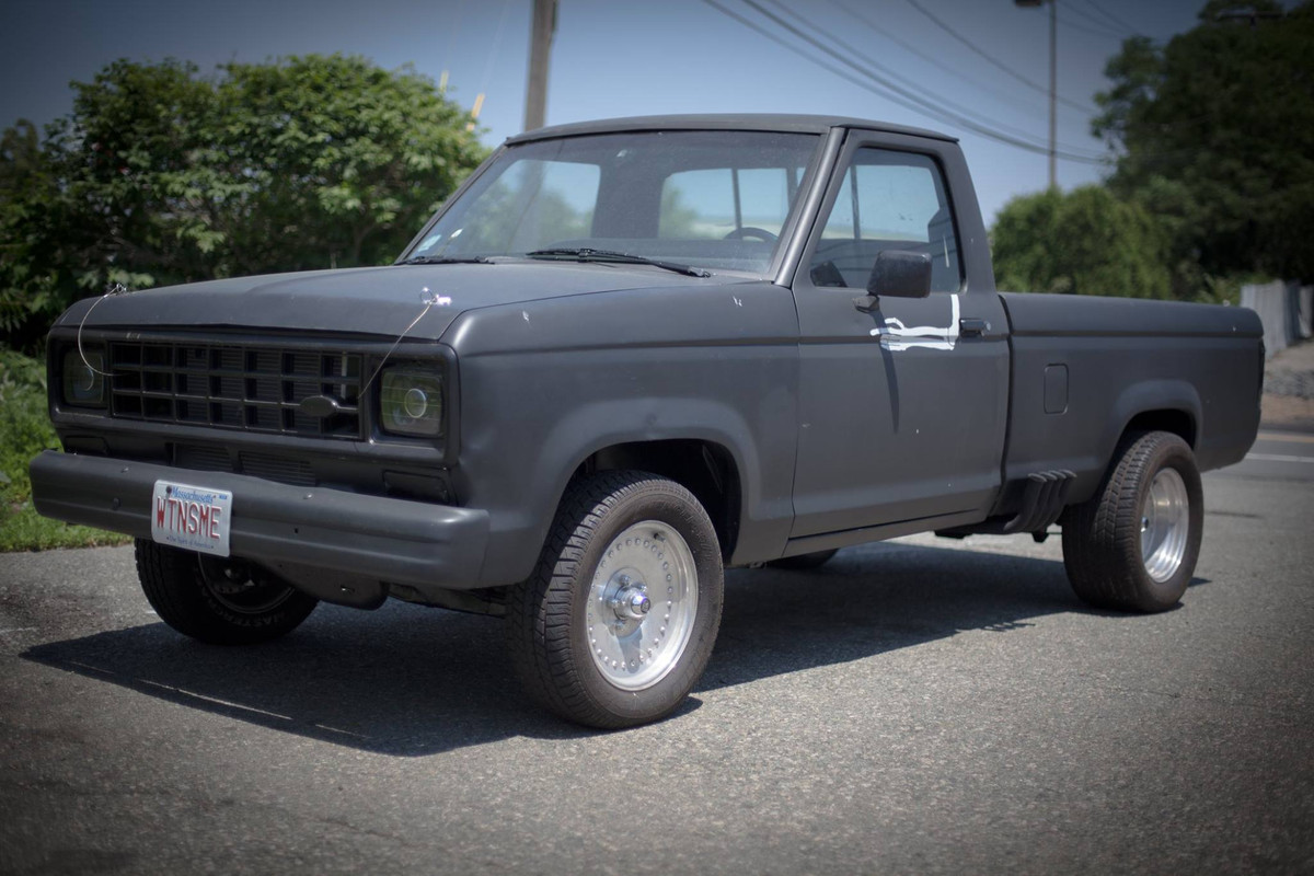

And some good photos for us to admire it where the whole truck is in the photo and not a lot of stuff in the background.
yesss!!!
yeah the whole thing has been very mad max inspired overall. i have a few things referencing the newer fury road movie like the skeleton arm and the license plates and i recently acquired this little bobble head for the dash.

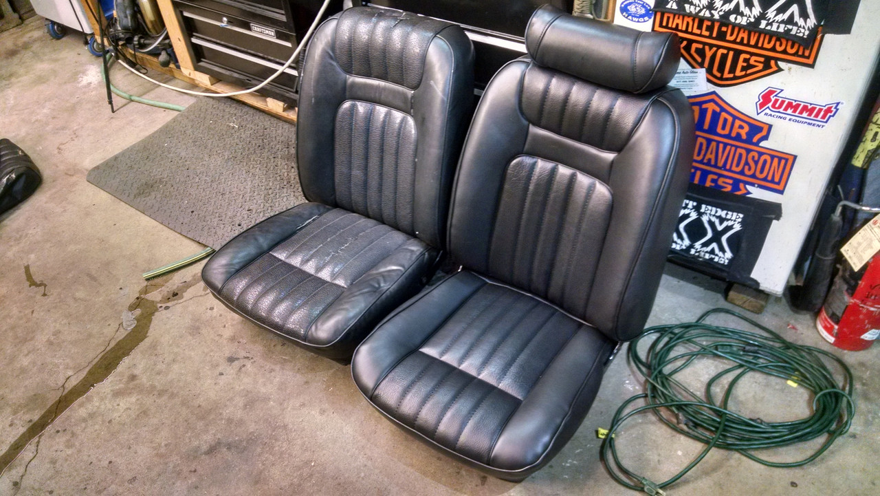

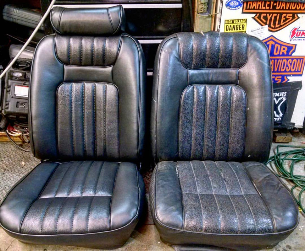

I've been working on reupholstering the 70s Mustangii Ghia seats that i have.
i ordered new vinyl TMI kits through CJPony Parts, and it was not quite as easy of a project as i thought it was going to be.
spent a good amount of time watching Richard Attenborough's GHANDI while trying to stretch fresh vinyl.
new vs old
