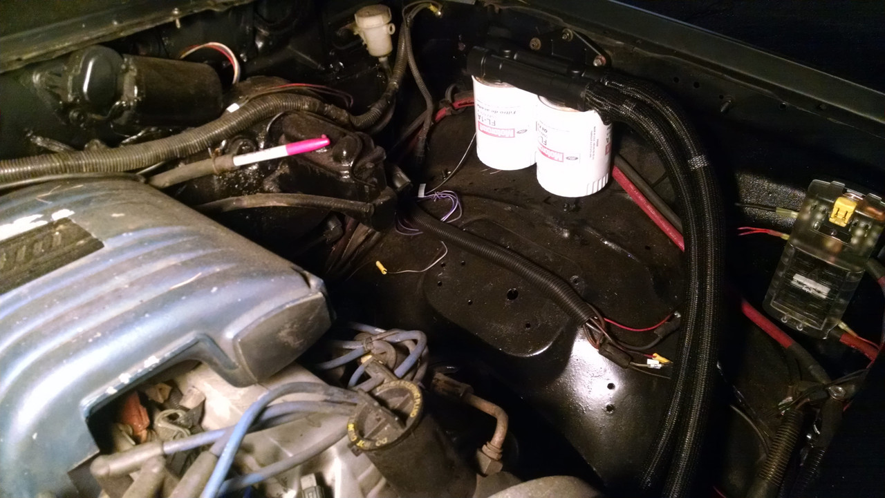

i also re-routed and changed the configuration a little bit on the remote oil filter setup.
now both send and return come out the same side, got rid of some hose length, cleaned it up a bit. (you can also see in this picture of much of the stock wiring harness has been cut out.

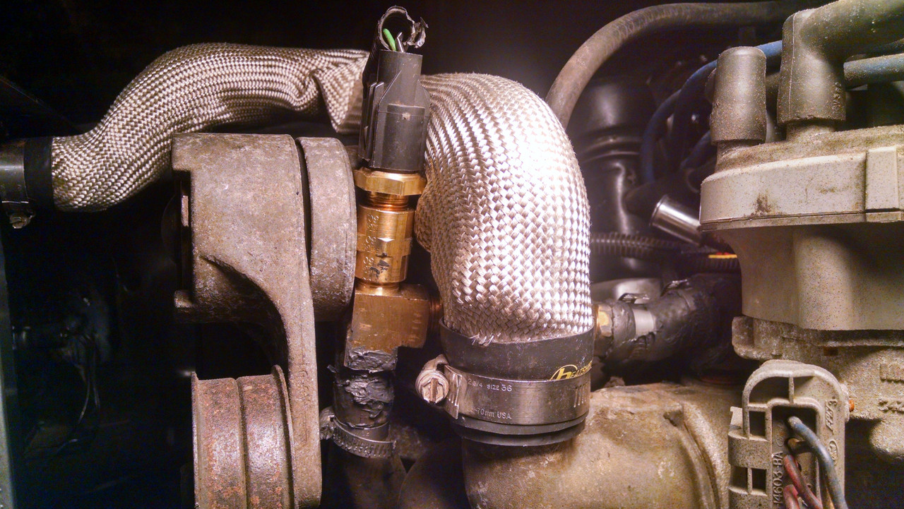

i also made/installed this crazy contraption to deal with the heater hose problem. hard to get a good picture of it
so the metal bent heater hose return in the top of the intake manifold, i cut down to just enough to put a 5/8" hose on, and i turned the fitting so it aims towards the front of the engine. i then trimmed the send from the water pump down pretty low.
what i have here that i put in then, is 2 nrass T's joined together.
its 5/8" hose bottom going in, with an extension on the top of that T to allow me to thread in the Water temp Sensor for the ECU (this normally was in the metal bent heater hose return) . this then goes into another T that has a 1/8" spur ontop for the hose going to the EGR/throttle body. then it ouputs again in a 5/8" spur going into the metal - now cut - return ontop of the intake manifold. i gunked up the ends of all these afterwords with permatex ultra black just to quadruple check that i dont spring any leaks. that stuff is like magic.

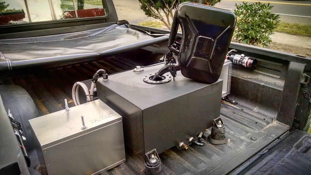

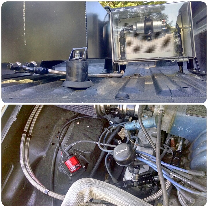

finally got around to running all the fuel lines and doing all the connectors on them.
they are -10AN PTFE lines with stainless steel braiding. fittings are mostly Earls and Fragola. had to do some ugly adapters getting back onto the stock Ford fuel rails.

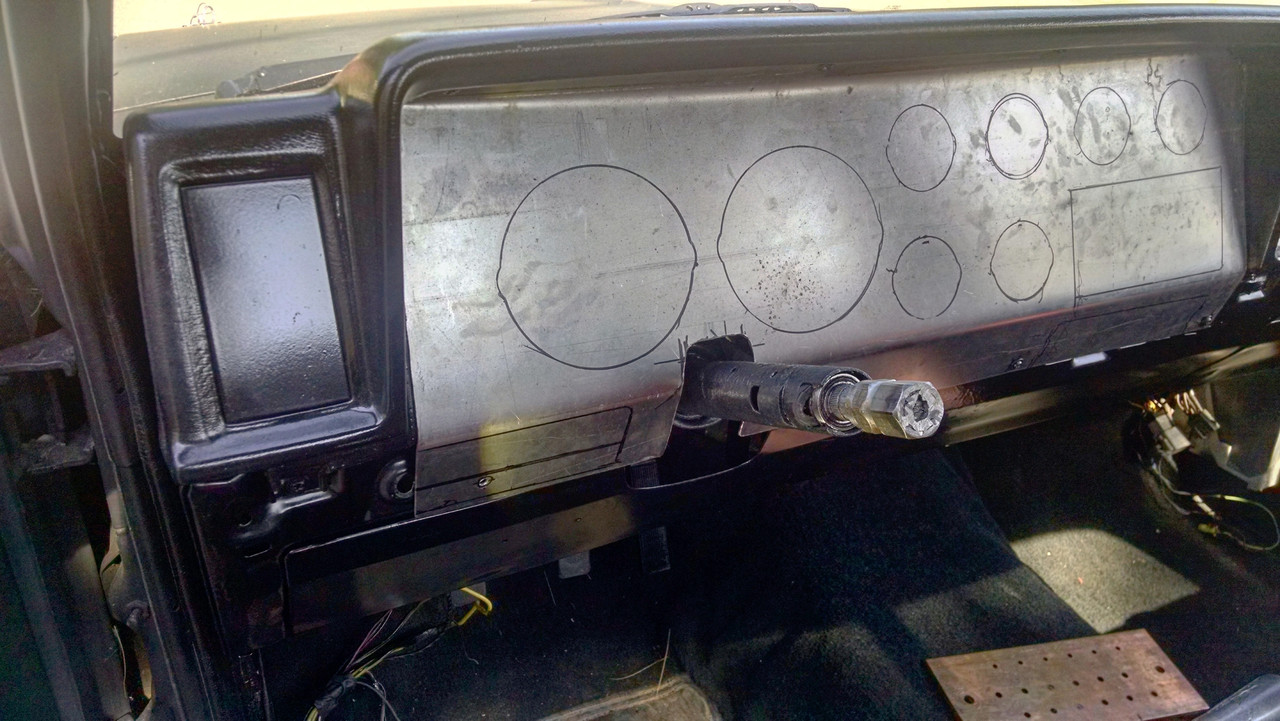

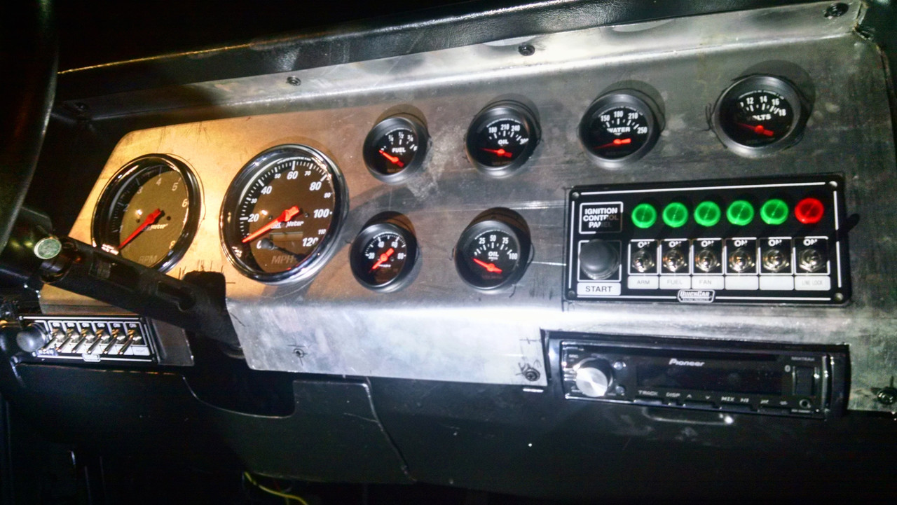

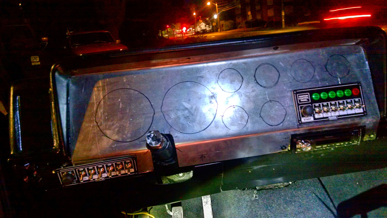

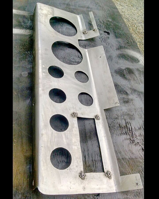

then the other night i finally layed out everything on the custom dash face i made, and crossed my fingers and made some holes.
using 1 QuickCar ignition panel for all the usual ignition stuff, then using the other for Headlights, blinkers, wipers, horn, interior lights, ect. using all autometer gauges.
the layout isnt Perfect. some holes arnt quite the right height and spacing and stuff, but im pretty pleased. got the cd player in there too.

Looking goood man, like that dash n cluster set up. What gauges did u go with?
Thanks guys.
So with the gauges I went with AutoMeter Z series for the 2 5/8" gauges. They are some of autometer's more affordable gauges, have possibly the largest selection of gauges out of all of AutoMeter's series, and have a nice kind of old school look to them.
I have - a voltage gauge, oil pressure, oil temp, water temp, fuel pressure, and fuel level.
Sadly the Z Series don't have any 5" gauges, and I really wanted a big tach and speedo. So for those 2 I bought a pair of AutoMeter's Designer Black series. They match almost identical to the Z Series in my eyes, except they have a chrome bezel instead of black. But the fonts, dial color, and feel I think look very similar to the Z gauges.
The speedometer is 0-120 and is digital driven. I'll be running it off an AutoMeter GPS Speedometer interface. The original cable drive in the truck was broken off at the transmission, and with the new transmission, rear gearing that I'm unsure of, and big rear tires that I might swap around aLOT depending on what I'm doing, I figured going the gps route would be the most accurate.
I also have a Summit Racing adjustable shift light siting inside the dash back a ways on the steering column. Idea is it will flash through the steering column opening kind of nonchalantly at 5,000rpm.

since last post, i finished the instrument cluster.
Corey and Elise's 1983 V8 Ranger build  - aka - Project Interceptor
wired everything in, and made sure the whole setup was accessible and serviceable.

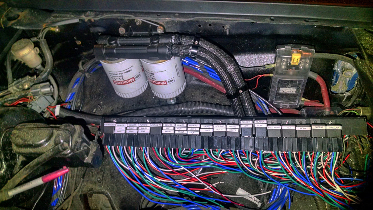

it was around this time that i got frustrated with the stock wiring, and decided to actually gut everything except for the EFI system leads and sensors.
so i pulled out the stock fuse panel and everything associated to it.
this pictures shows the relay system i finished wiring up, along with the 2 fuse panels. one is constant power, and one is keyed power (technically switch because there is no key)

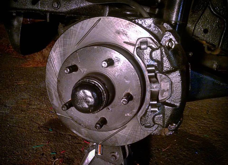

up next i had to make it roll and stop. as the brakes were seized, i did all new drums, pads, springs, just about everything imaginable in the back, then rotors, calipers, pads, all new wheel bearings and seals in front
then i discovered i had to do all new brake lines,
then discovered the brake booster and master cylinder were essentially rusted blocks of non-functioning trash

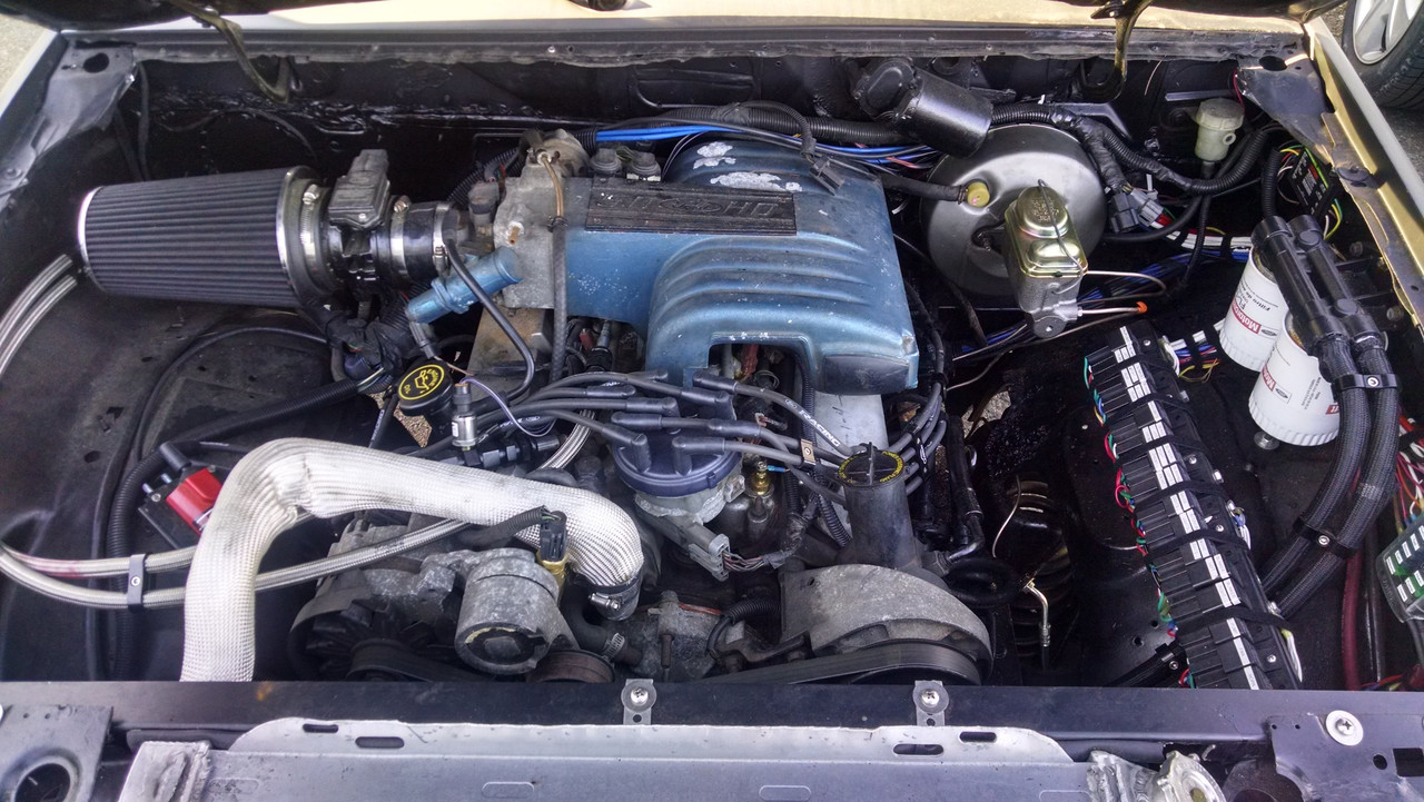

speaking of things i planned on doing eventually, and am just going to do now, hahahaha.
i'm swapping the whole fuel injected setup over to Carb.
so it currently starts, runs. drives forward and backward. spins the tires and all that jazz.
but it also has, what appears to be a small crack in the bottom of the intake manifold water neck portion. has some vacuum leaks in other spots. i think the gasket between the egr plate/heating plate and the upper manifold, or throttle body, or something is leaking. so instead of trying to chase weird EFI problems around, or spending money to dismantle the whole EFI system and reinstall with all new gaskets and hoses and fix the crack (not positive its a crack, it might actually be a another gasket leak under there at the water neck or the front cork manifold gasket itself) I'm just swapping the whole thing over to Carb. because i kind of wanted to do that anyway eventually.
i'll get rid of allot of wiring, cleanup the whole engine bay, simplify everything a bit, and maybe even shave a few pounds off (i know it won't be much, but a guy can dream)
so what i'm putting in is an Edelbrock Airgap intake manifold. Edelbrock Performer Carb,
valve covers for looks and proper breather and pcv valve setup, had Performance Distributors set me up an HEI style DavisUnifiedIgnition distributor (the did one for my 4x4 Van when i did the top end work to that and i Love it) and an Edelbrock fuel Regulator to step the 51psi coming from the Bosch 044 pump down to 5 or 6 psi for the carb. i had already designed the fuel system as -10AN ptfe send and -10AN ptfe return, so i just need to cut the send and return lines back to a spot on the fender and put fittings back on, then run another short piece over to the carb.
