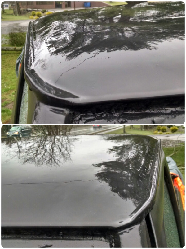

did a little body filler work and primer on my patch welds on the roof corners and gutters, started raining today so pardon the wet pictures. the paint does NOT look that smooth dry hahahaha.

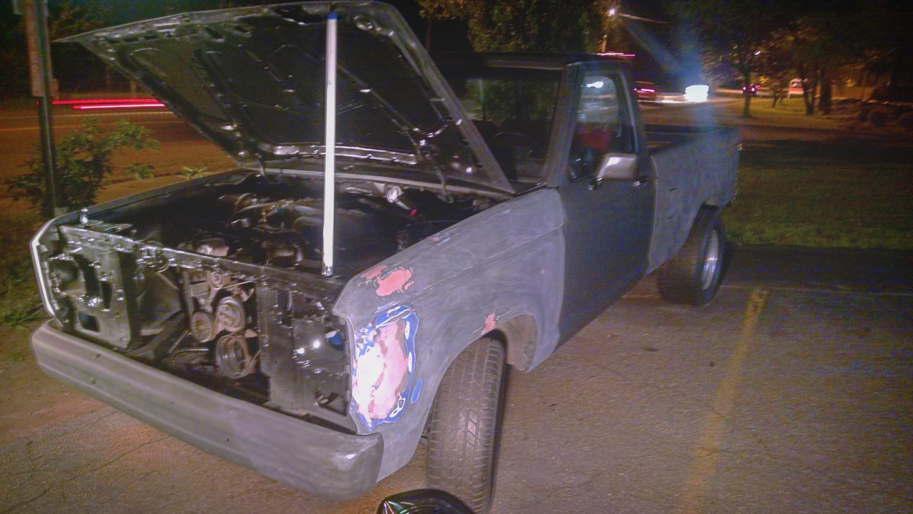

while waiting for stuff to dry i filled in the badge holes on the fenders, and then as a Rash Impulse decision decided i wanted to sand down and fill in the Side Marker Lights on the fender too.
these fenders are beat bad, so i'll probably replace them at some point down the road (looks like i can buy replacement fenders for around $80-$110 each), but i wanted to see how this looked and how long they hold up like this without cracking. kind of dig the clean fender look. again, it was raining when i took these photos. sorry

Your roof patch looks good, it looks like you might need to redo the epoxy in your door gutters. They are a common area to leak and take out floor pans with water.
Thanks! I bought a cheap Fluxcore welder last summer, and have been doing the odd exhaust system and fender patch on my 4x4 here and there. I've told it's really not the right tool for this route of work, but I'm making due.
Anyway, what are the four gutters exactly? The channels on the roof above each window?
Are they supposed to be filled with epoxy?
ALOT of the channel trim had rotted away, so I sculpted the missing ends out of weld and a grinder. Then I used bondo Gold to fill in my flubs.
I've already done some serious floor repairs in this thing. Looked like most the water was coming in those holes in the wiper cowl Chanel. Sealed those all up. I THINK this thing should be pretty water tight. We will see.

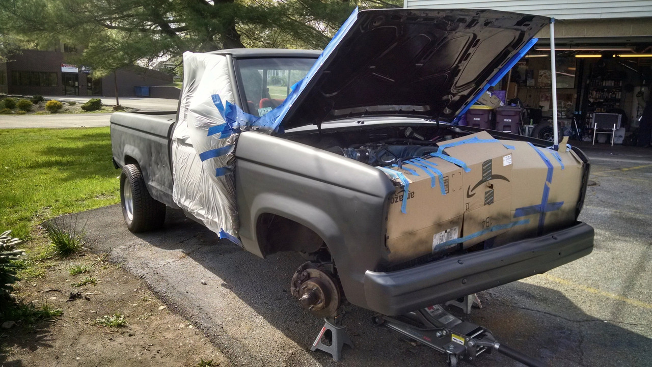

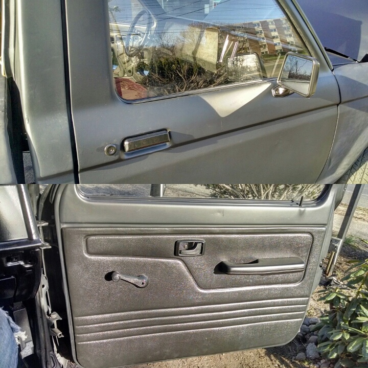

ended up giving the cab, doors, and hood a rough backyard paint job. ive been looking to replace a bunch of the door hardware (drivers window didnt roll up, drivers inside door handle didnt work, only 1 mirror had glass, i didnt have keys to either locks) and i figured if i was going to have them apart, might as well paint them.
used Duplicolor Perfect Match Flat Black.
looks good, great from 20ft back, which is all im going for. im simply sanding the primer that is on there down with 600 grit. not taking it down to bare metal. not going crazy trying to fix blemishes. just trying to get it looking ok.
ordered door hardware from LMC truck and a few misc parts off ebay.
mirrors, interior ad exterior door handles, interior door panel, handle bezel, window crank, locks, arms rests, lock pins, window seals and runners.

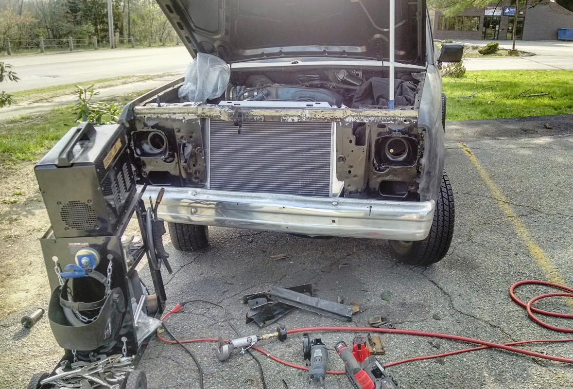

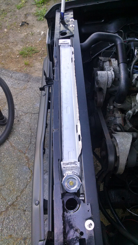

started swapping out the radiator.

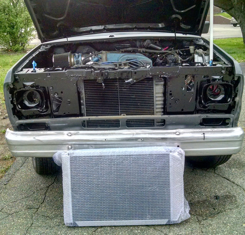

i thought i had read on here somewhere people say you can drop the 87-93 mustang radiator in these trucks.
and looking at pictures of mustang 5.0 radiators, it looked like what was in here when i got it. (it definitely wasnt a stock ranger radiator)
well, it also wasnt a foxbody mustang radiator.
i bought a tripple core aluminum foxbody 5.0 radiator, and it doesnt even come close to fitting without doing some SERIOUS hackery.
so ive started the Hack process, and pretty much have it in there i think.
the previous owner had hacked up and re-welded angle iron onto alot of the radiator supports and cross members, moved the hood latch, bondoed junk, all kinds of stuff, so i really didnt feel bad about cutting and welding even more.
as you can see in the pictures, i cut aLOT of metal out. the top radiator support is pretty much just a piece of angle iron welded in, with a few jogs and chunks taken out and added. the radiator sits pretty much on the frame. the radiator is 29" wide, inorder to fit between the frame it would have to be 24". which wasnt going to happen.
so, here it is.

so like i said in the last post, the tripple core aluminum radiator for an 89 mustang gt was not even close to fitting. it was hitting EVERYWHERE. i spent pretty much an entire saturday with a cutoff wheel, welder, grinder, and some angle iron just having at it, and having at all the mounting tabs on the radiator. but, god damn it its in. and now that its all painted, it actually looks ok.
you kinda have to lean on the hood now to get the hood pins in, but i think its more secure than the one that was in there previously.
the radiator essentially slides into a channel that i made, then a piece of angle aluminum i cut to just shy of the width of the grill, gets bolted in behind the radiator and sandwiches it in place.
like so
i used automotive weather stripping on the bottom, front, and sides of the channel, and on the angle aluminum where it sandwiches the radiator.
no metal on metal anywhere, doesn't wiggle or move at all. i'm pretty please.

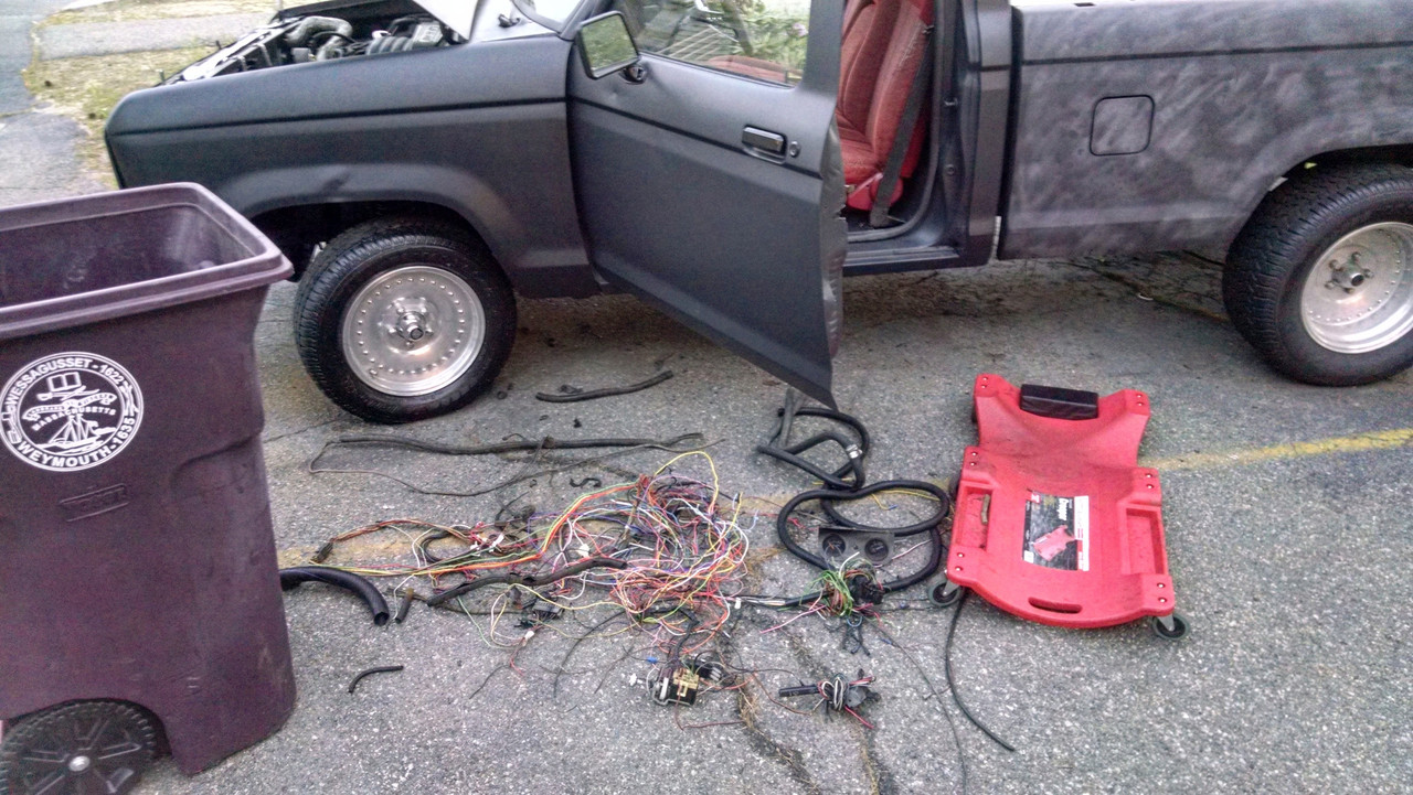

and i took this past saturday, and started tracing out ALL of the nolonger connected wiring, IDing it, cutting it, and yanking it.
previous owner did some crazy hackery between the 2 different wiring harnesses, and some crazy other jerry rigged stuff.
i cant stand crazy messy dead ended wiring, so i Really went to town.
im going to be rewiring all the lights and switches and gauges and stuff myself, so i know everything is, where everything is, and that it doesnt have 8 different splices over to 5 different colors.

i'll be posting pictures of this soon for those of you who make the mistake out there that i did, but some people on this forum i thought had told me the electric fan units out of the Sables and Tauruses would fit in here, so i bought a nice expensive brand new OEM electric fan out for a 90s Turbo SHO.
i have about 3.6 maybe 3.7 inches of clearance before hitting my water pump pulley, and the shroud alone on this thing was about 4.5 inches deep, 5.5 inches where the back of the fan actually sits.
kind of a bummer.
so i ordered a new 16" Flexalite LOblow electric fan for it. supposed to be 3.25 inches deep.
fingers crossed.
