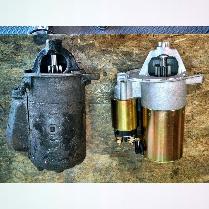

Hey guys, small victory on the ranger this week.
I put in the new mini-High Torque starter with the built in solenoid, bought a new optima yellow top, and with the help of a can of Ether, we got the beast to run for a few seconds!
so stoked.
the starter was not easy on this. I have long tube headers on my f150, and this made that seem like a walk in the park.
previous owner put a VERY customized Tri Y style header on the passenger side, and had to make a small notch in the frame still to get it to clear.
that top bolt did Not want to be gotten to.
anyway, got the new starter in, had to do some adjusting of the power cable to get it to stretch the extra 3 inches to its new location on both sides, and ran a new ignition wire to it.
this is the first time we've actually heard it Pur, so we're both pretty fired up. hahaha.

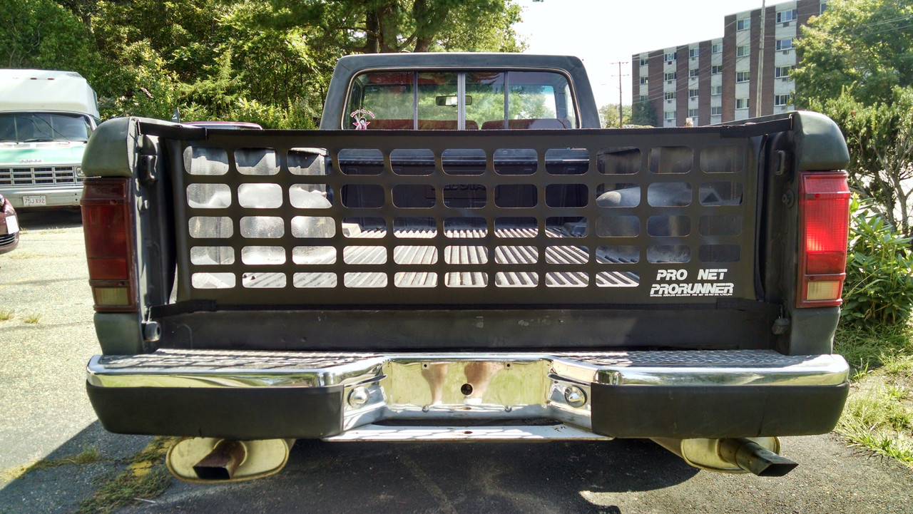

also took a few moments to throw on a temporary fabric tailgate (till I can find a real one at a reasonable price), and swapped out the hurst shifter stick that was on the truck (I think its they style that would have been on the fox body mustang) and put on a new short straight hurst stick and new boot (not screwed down to the floor yet)
the original stick had the wonkiest bends, back, then over, then angled to the left, which put the handle at a weird angle, and had it right IN the seat cushion in 2nd and 4th gears.
the new one gives me about 3 inches between 4th and the seat, and feels REAL nice in the hand (very skinny thin stick so your fingers wrap around nice). I had the seat pulled forward in the picture though, so it looks a whole lot closer than it is. I also maimed and mauled the old T handle something bad in my vice trying to get the old shitty thread adapter out and welding a new one in, but I kind of like the way the gouges in it look and feel in the palm.
