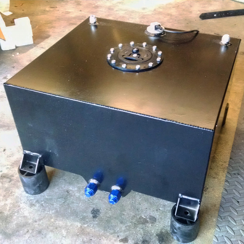

the 15 gallon fuel cell has shown up in the mail
Corey and Elise's 1983 V8 Ranger build  - aka - Project Interceptor
and i began laying out the filter. - pump - filter setup. xrp 100micron pre, bosch 044 pump, xrp 40micron post. all with -10AN fittings. im putting these in a NEMA 4x rated outdoor electrical box with a clear cover.
i need to figure out how exactly im going to mount it up in the bed.
moving forward im going to pull out the old fuel pump wiring and plumbing and try to make sense of everything, then start running new fuel lines down the passenger side frame.

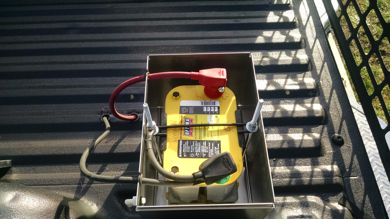

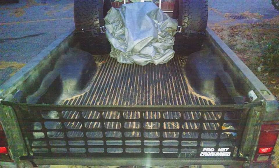

figured before we started mounting the fuel system and battery in the bed we'd take the old plastic liner out and do a 2-part paint in liner.
we put rubber grommets in the bed where the new battery cables and PTFE fuel line will be passing through.

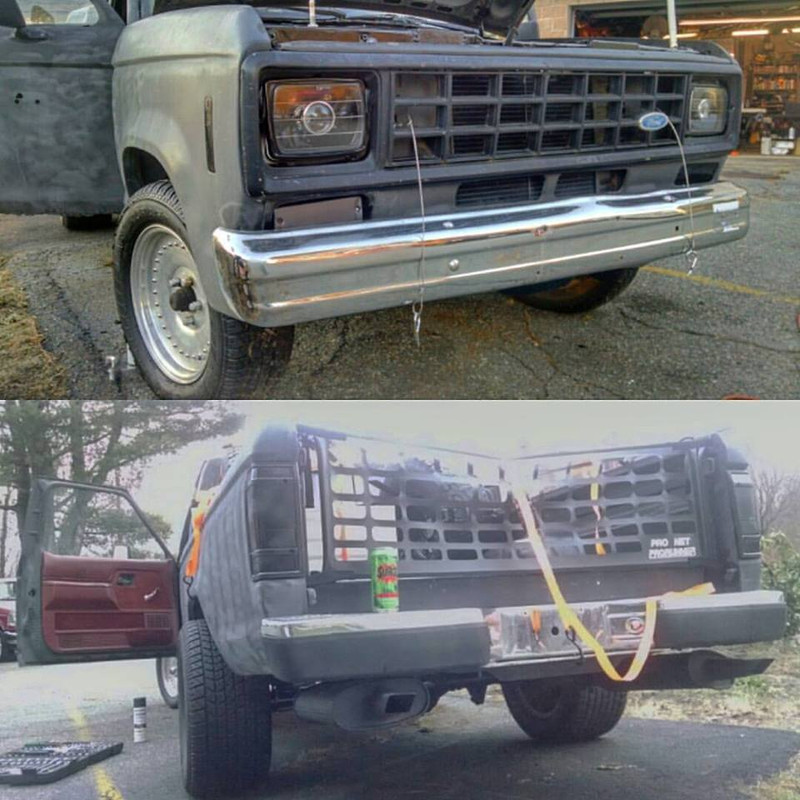

after that we ended up swapping out the headlights for a pair of black ones, and blacked out the other lights on the truck.

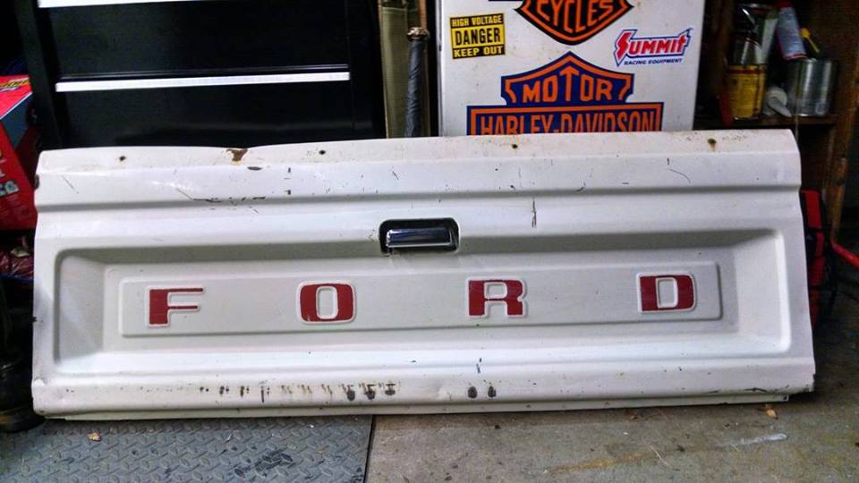

then we found a really cheap tailgate, that we primed to match the rest of the truck, and bed linnered the interior.

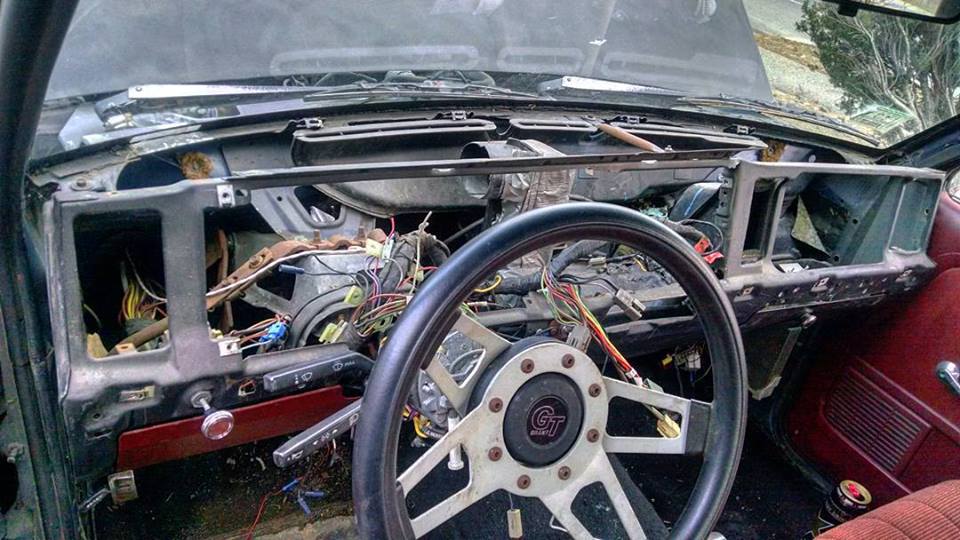

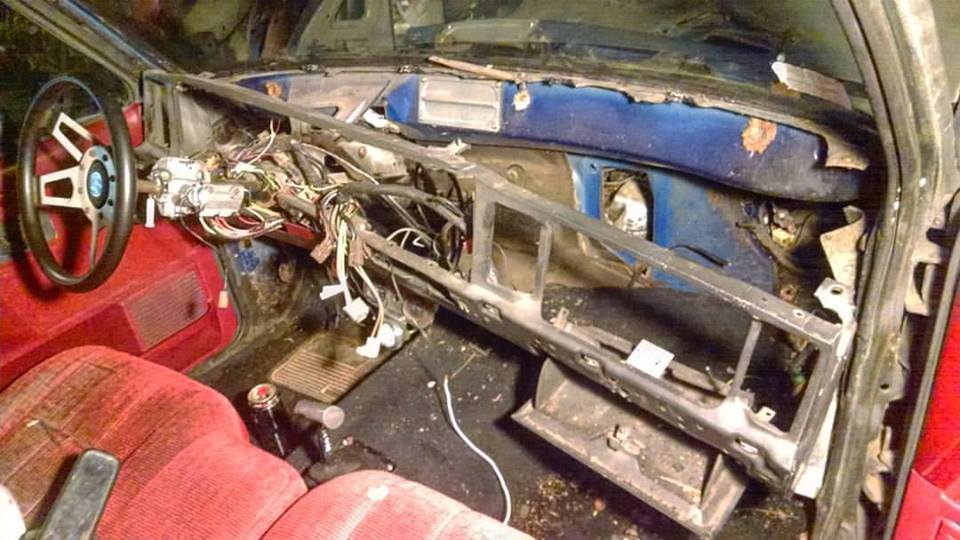

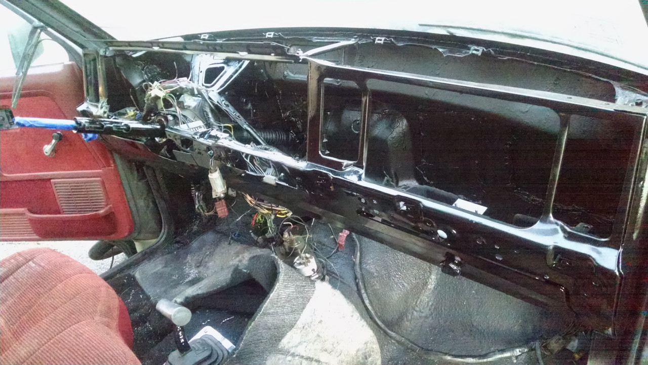

at this point we got sick of looking at the heating system that wasn't hooked up, was adding weight, and was going to just get in our way once we started running fuel lines and trying to trouble shoot things. se we yanked out the dash, and started tearing apart the heating system.

the we took some black rustoleum enamel to the dash frame, and decided to go at it under the hood as well with some fresh paint in the engine bay.

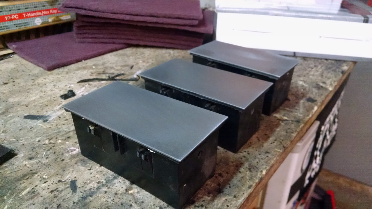

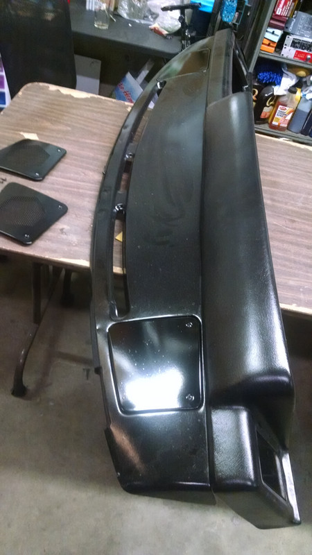

With the dash out, and the heating vents rendered useless, we came up with a solution to fill the holes. we cut some pieces of sheet metal and fit them to the old vent frames (took the actual vents out so we could possibly use these for toggle switches or something if we find we need to)
think they came out looking pretty sharp.

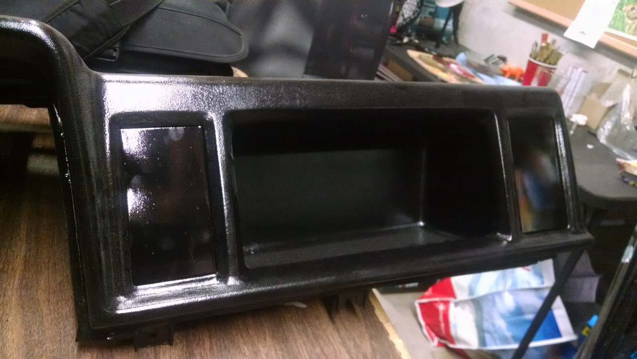

also found some speaker fillers off ebay for the dash.

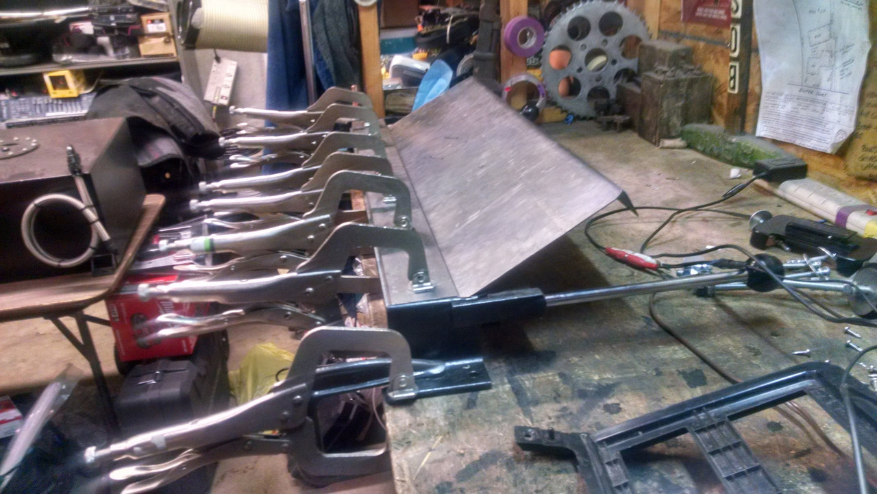

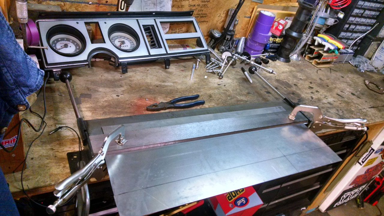

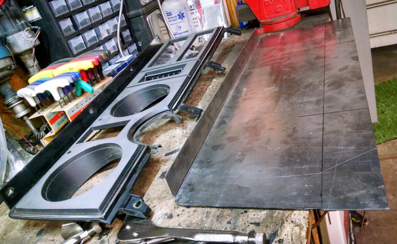

so I got a good piece of 16 gauge steel, attempted to measure out the dash face 20 times, transferred shapes over to the steel, and did some cuts.
then I bought one of those cheap $60 sheet metal brakes, and very gradually attempted to match the 2 bends (one just shy of 90 degrees up top, and the bottom is more like 50 degrees)
the hardest part I had was trying to line up the screw holes and get them to fit, but it ended up working.

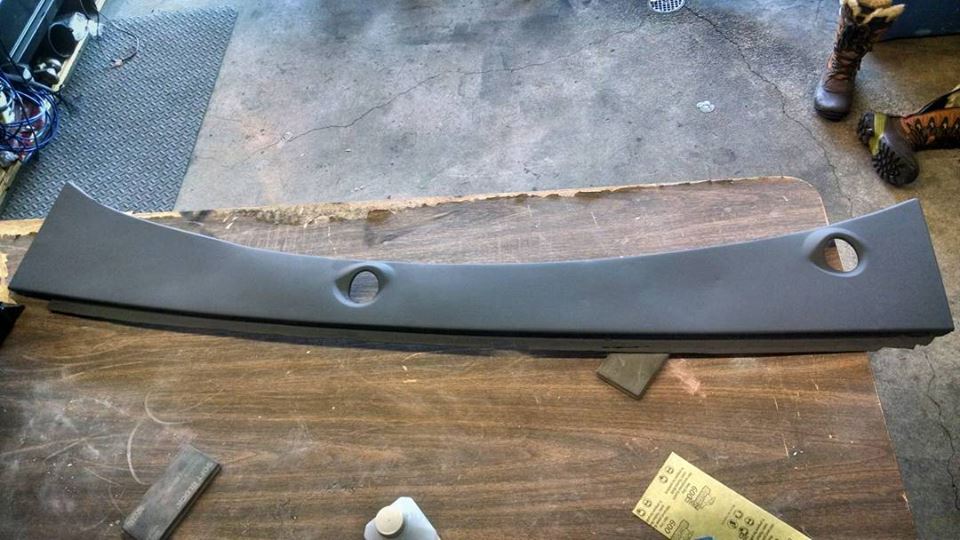

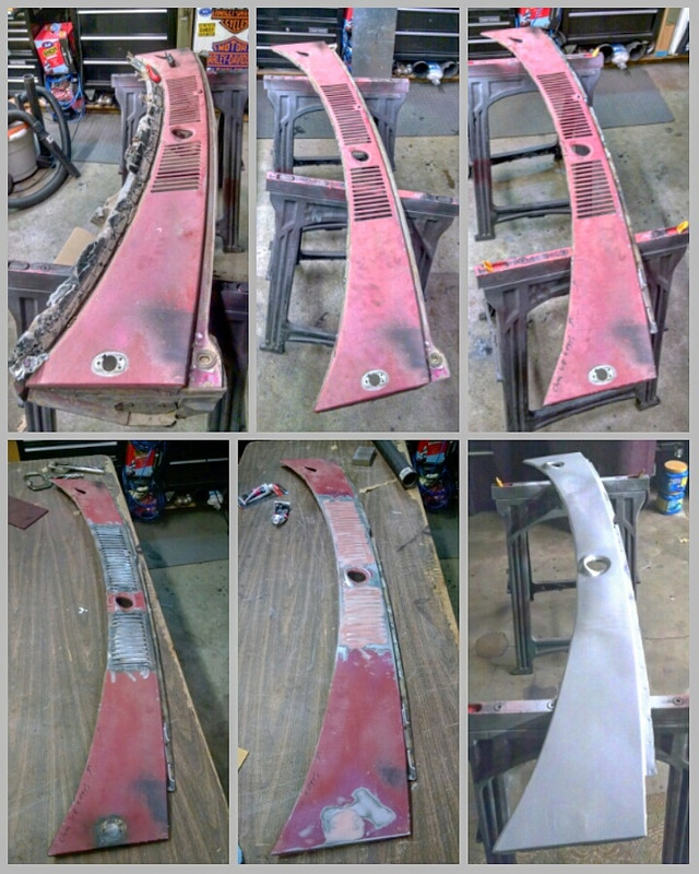

also, I had a junkyard cut off the welded-on wiper cowl off another older ranger for me (and a good portion of the windshield it looks like) and I finally started stripping alllll the extra unwanted layers of sheetmetal off of that so it is Just the final top skin, that im then going to screw on, similar to how they attach on the econolines and f150s of similar years (atleast my econoline and f150 the cowl just unscrews and comes right off)
probably went through 8 cutoff wheels and 4 grinding disks.
but got it down to just beyond where the previous owner had cut the old one off. this slips right over it, and should look nice with a couple of sheetmetal screws and the windshield trim/molding on.
I also decided while I was grinding and cutting, I was going to weld the cowl vents shut, throw a little body filler over it, and sand it down smooth. again, the entire heating and air system has been completely removed and the firewall has been sealed shut. so the vents in the cowl really we're going to serve any purpose anymore.

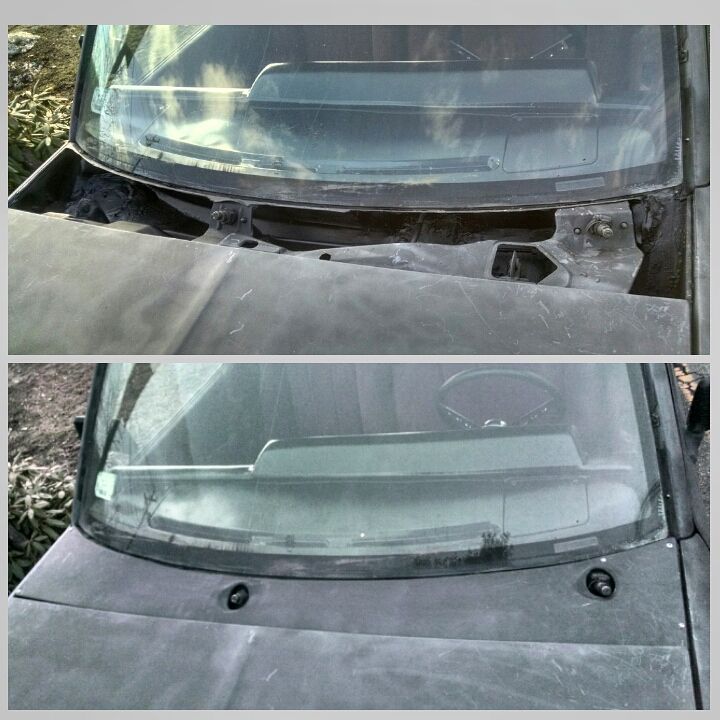

got the cowl on.
have to do some serious adjusting. like i said in a previous post, im pretty sure this thing was in an accident, most of the body panels on the passenger side are knocked back out of wack, front bumper is all bent in and up on that side, rear quarter panel is all crumpled and pulled out, and i just realized that the passenger side door isnt the original.
anyway, gotta do some adjusting to get the cowl to sit right and still open the hood, but here it is for now.

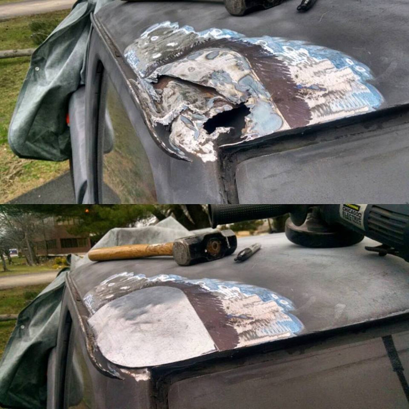

i also started fixing the roof corners up by the windshield molding.
i used an angle grinder to take the corners down to practically nothing, then cut some scrap 16 gauge steel to shape, and used a hammer and some vices to slowly bang it into the rough shape i was looking for, then traced that shape onto the roof, and used the angle grinder to take the negative space down really far so the patch sits a little more flat.
i'm not confident in my but welds with really thin sheetmetal like this. i only have a cheap flux Core welder. so im overlapping everything and grinding it down smooth.
so this is what ive got. going to go over with a little bondo gold to smooth out the holes and rough spots, but im pretty happy. welds are strong, and no more holes.

i think ive decided im going to rewire everything with the exception of the computer itself (for now).
might be biting off too much.
