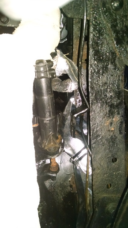

i replaced both last season after the slave started leaking and the ranger master cracked at the seems on me, but this is what the chevy slave looked like, its a push style. so it sits on a bracket at the front of the tranny, and pushes the clutch fork towards the back of the truck.

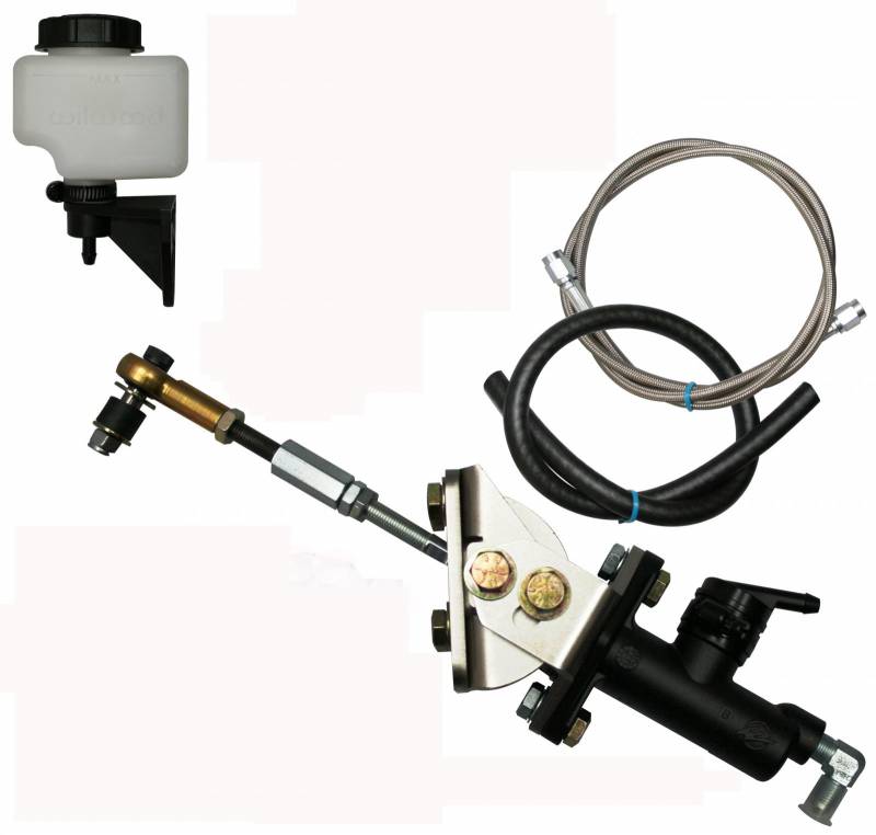

the ranger master cylinders have a wonky angle to them because of the firewall/pedal geometry, so if i go with a standard aftermarket Wilwood, or Tilton, or Mcleod, or something, im going to have to buy an adapter bracket like this,
https://americanpowertrain.com/i-11...utch-firewall-bracket-and-clutch-rod-kit.html
that bolts up like this
so if anyone knows what the stock master bore size is, that'd be awesome. i need to figure out that so i can go up a size or two, and hopefully a slightly larger bore master, will allow me to back off the preload on the slave side so im not slipping at all, AND get more travel out of the slave side to get me FULL disengagement.
