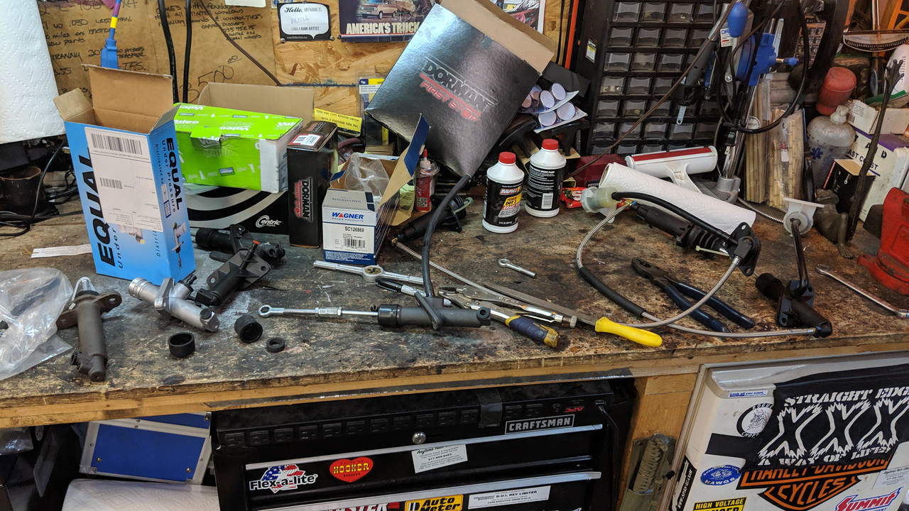

what i discovered was going on was this.
i was running a 3/4" bore stock ford ranger master cylinder, and a 1" bore chevy camaro slave cylinder.
in order to disengage the clutch enough to shift, i had so much preload on clutch fork, that the clutch was actually slipping under heavy load.
it looks like this was because of the smaller master cylinder to larger slave cylinder ratio.

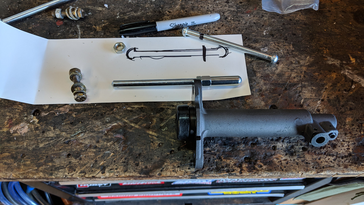

what i did was order a dorman 7/8" bore ranger master cylinder, and a dorman 7/8" bore ranger slave cylinder.
they showed up and to my surprise were heavy duty metal castings. unlike the plastic ranger ones i have seen and used in the past.

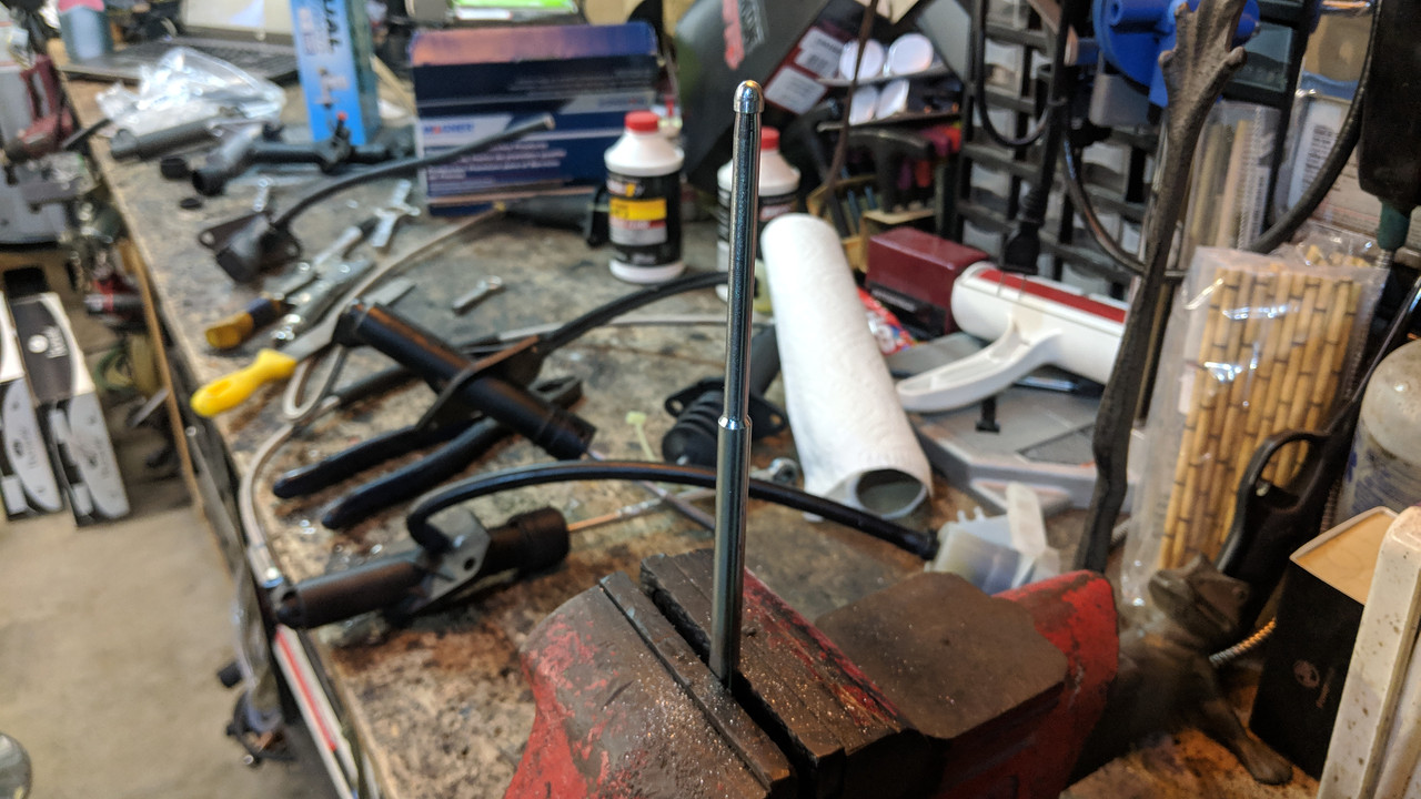

i then custom threaded the rods for both the slave and master, so as to make them adjustable.
i used chevy camaro braided stainless lines and fittings, as those are the right length for my application, and seem to work well, and i bench bled the system.
i've done this like.... 5 times now, and have gotten really pretty damn good at bench bleading these things.

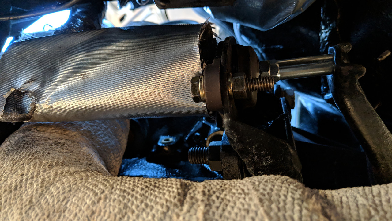

i've had a few people ask me how im running a push type slave in this direction.
its a custom heavy steel bracket for the slave that bolts to the front of the bell housing. its using an 83 ranger style clutch fork. or a chevy clutch fork? i think its a ranger clutch fork. im not really sure. anyway, the pivot ball is on the drivers side.
this is what it looks like without the slave in there.
and then this is what it looks like with the slave re-installed

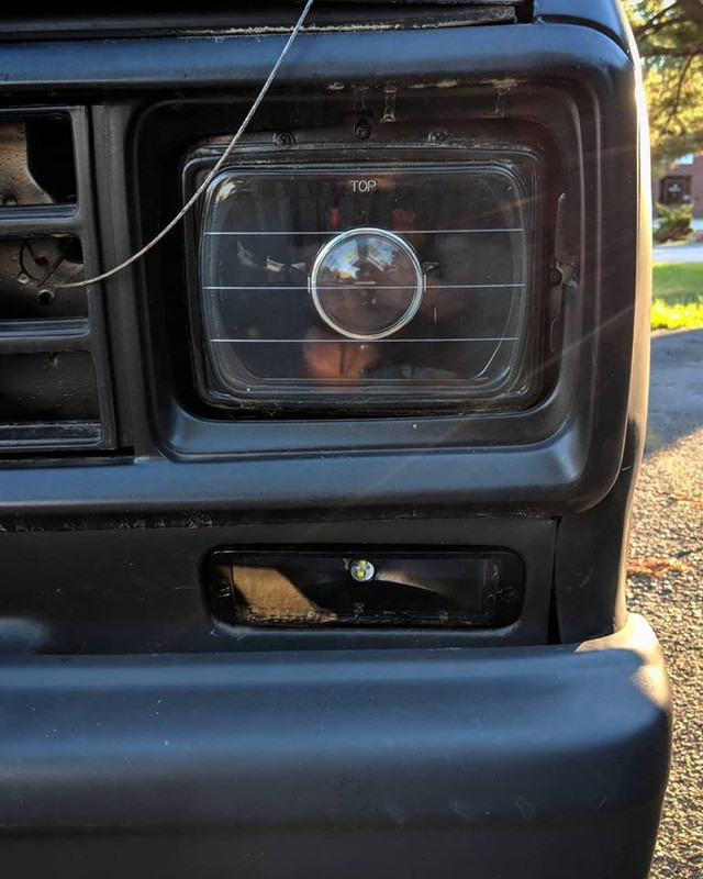

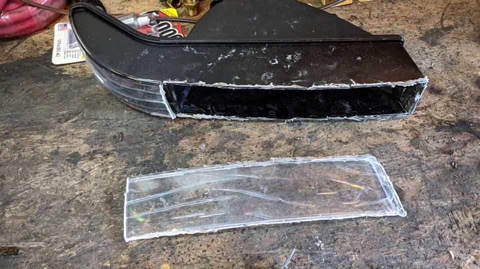

before it went away for the winter i finished making a new set of directionals for the truck.
i'm yet to be able to find a pair of Clear front directionals, and have kind of given up hope at this point, so i made my own.
i took a pair of stock ranger directionals, cut the faces off them, painted the body's black, then attached clear front faces off another set of lights, and painted the outer edges black.
they don't look horrible, and kind of look like they match the front headlights i have going

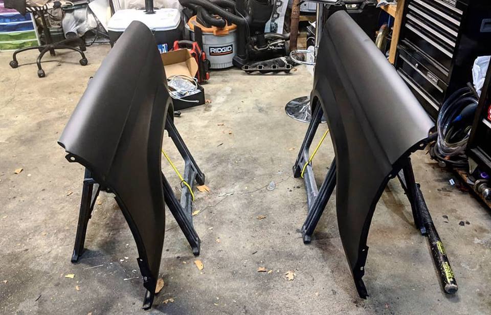

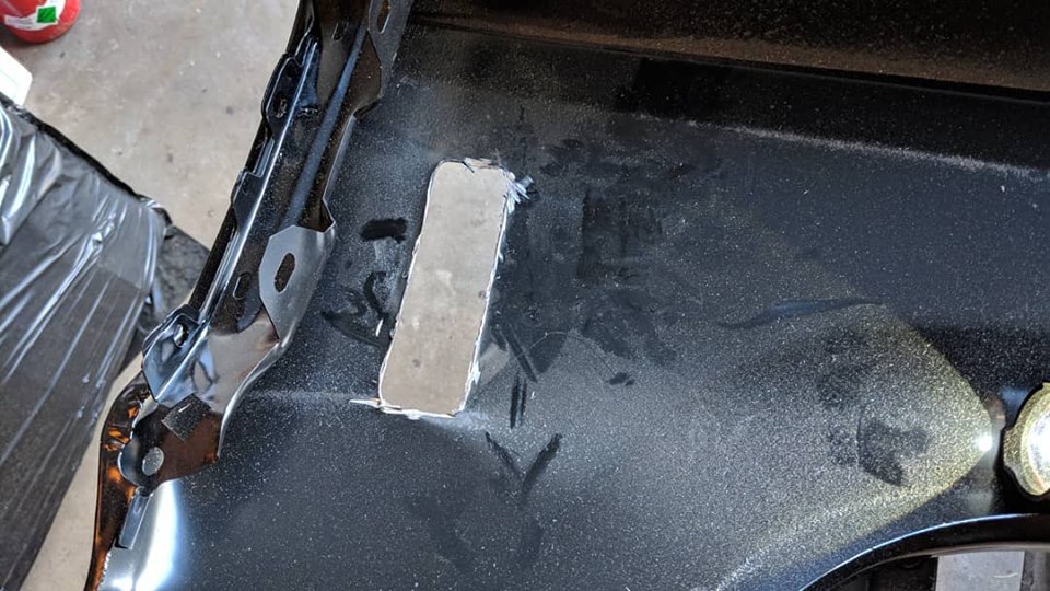

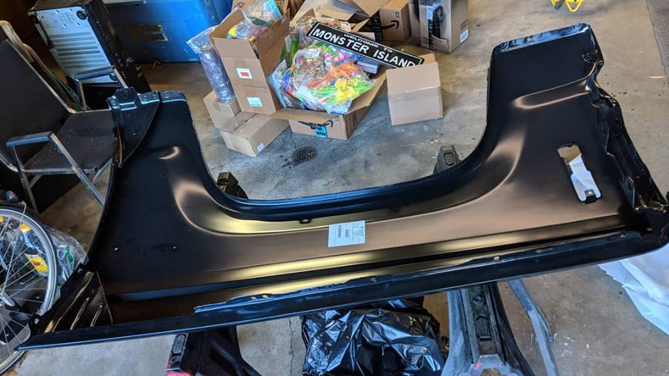

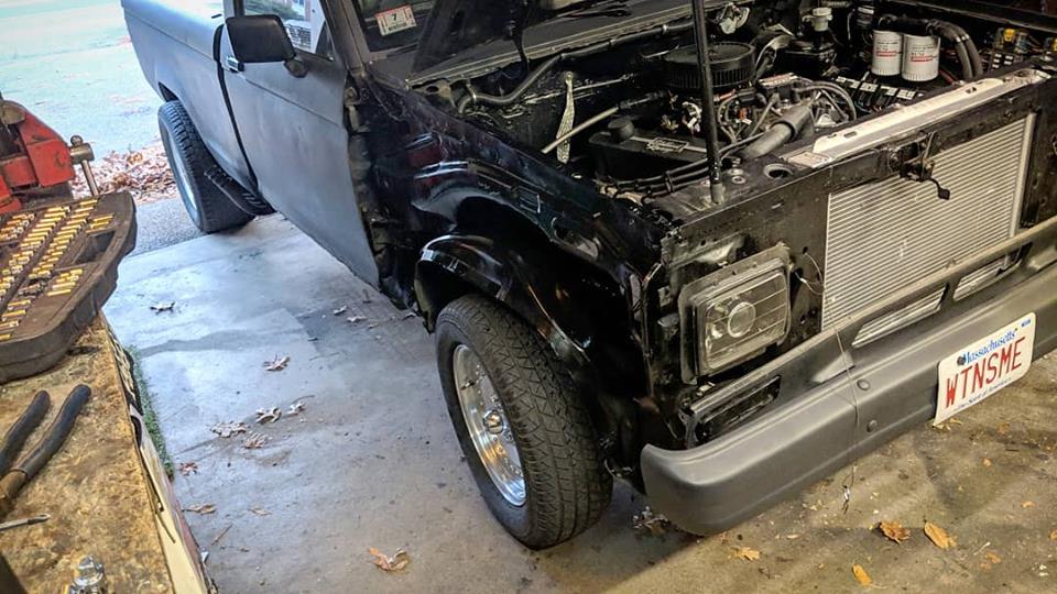

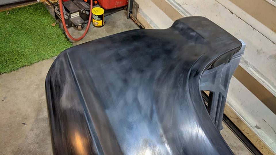

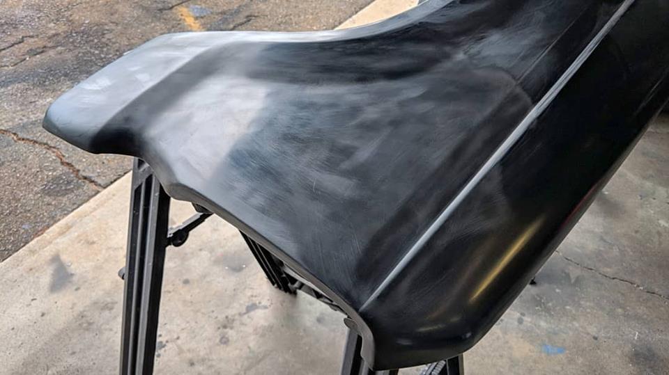

i also finished up the fenders i was working on.
i shaved the interior metal tabs for the lights and the emblems, then i filled them in with sheetmetal, used a little bit of body filler to smooth them out, primed sanded and painted. they came out pretty decent looking. would never know there is supposed to be a light there.

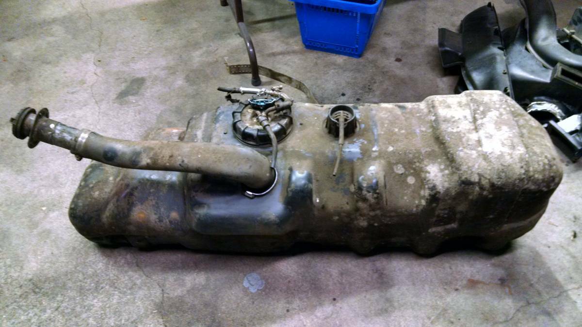

if anyone wants the gas tank that was in this ranger when i bought it, please, take it for free. i'm going to end up throwing it out.
it is a PLASTIC 17 gallon tank, with high pressure (about 45 psi) electric pump, fuel level sender, pig tails, and mounting straps.
it was in my 1983 ranger running a 1991 mustang gt 5.0 v8.
i know that the 83 ranger would have originally had a metal tank, and had a mechanical fuel pump.
my specific ranger originally had the 59hp diesel engine in it, so i don't know if the diesels may have originally had electric pumps and plastic tanks? or this could have technically been out of a latter model truck.
it fit up in there perfectly like it was stock... so.... i'm not sure.
regardless,
it doesnt leak, no gouges, just dirty. oh, and its FREE
located in weymouth.
come grab it before it ends up in a dumpster.
