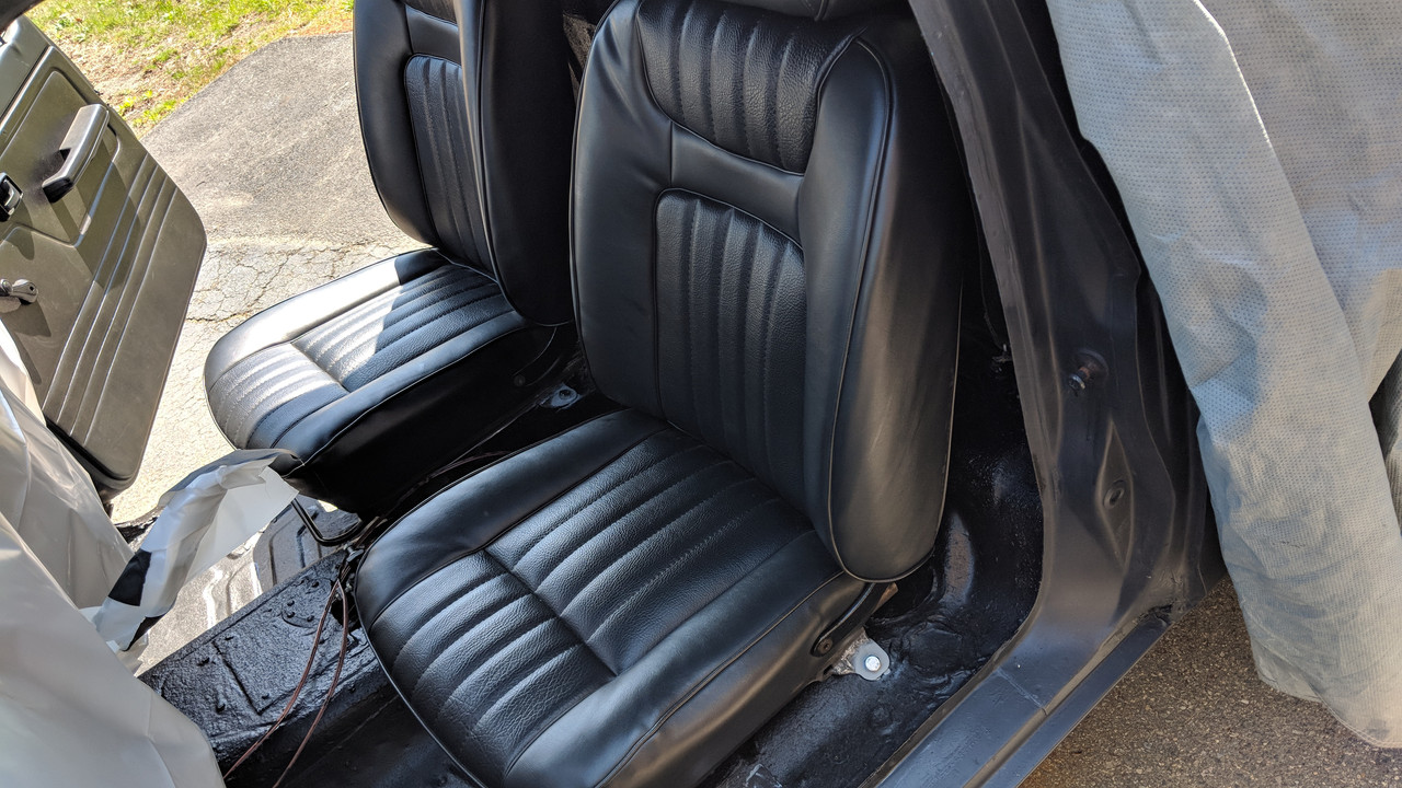

had some good weather, so i'm trying to get this floor and these seats finished up and everything back in the truck for spring cruising.
here's the floor, as finished as i'm gonna be with it.

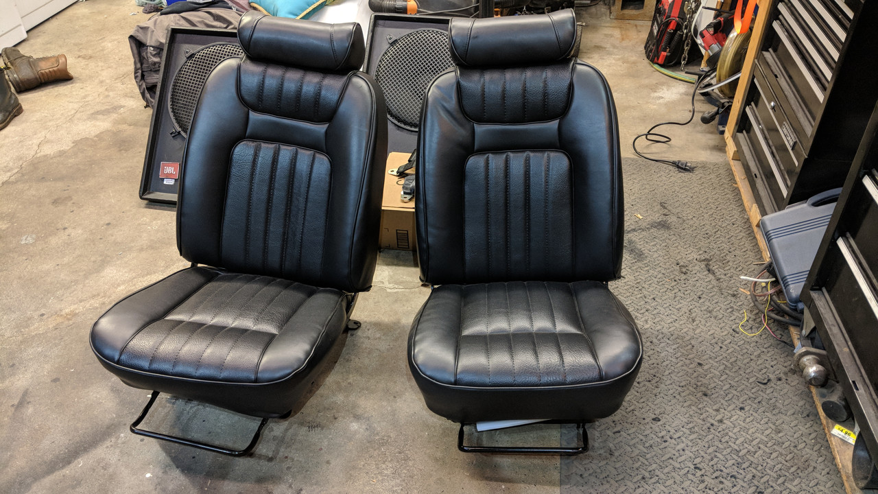

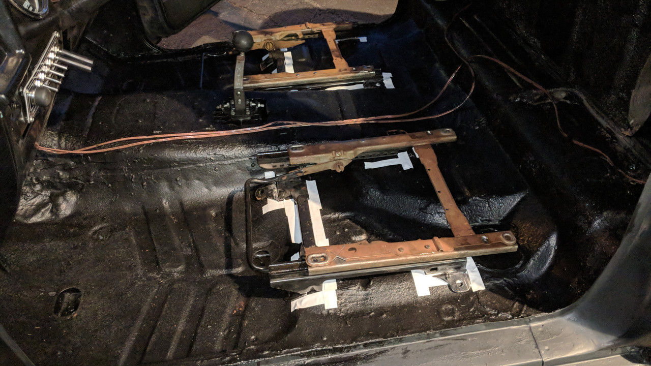

so what i ended up doing for seat tracks/mounts for these mustangii seats, is i found a pair of early 90s explorer front tracks. the frames were the correct width, i just had to drill 2 new holes in the back to to bolt the seats to.
i assumed the tabs wouldnt line up with the ranger floor and i'd have to do some modifications.
i didnt realize how much they wouldnt line up.
when i went to put the seats and tracks in the ranger cab, it was comically high.
i couldnt sit in the seat without my head cocked to the side.
i was up against the roof, bad.
so i trimmed some height off the bottoms, and some more, till my head wasnt touching, then i trimmed even more and more to try and get head clearance for any other friends who i might take out in it. (i'm 6ft and about 185 pounds. have a few friends who are in the 6-3" range)
finally i hacked them down to the point where the track slider JUST clears hitting the floor, and i had room up top for my head, and a helmet if i ever need one in here.
i then spent a ton of time laying out where they sit best on the floor, where i have the most range of motion forwards and back on the slider, and marked them all out with white tape.
then i started cutting and laying out the tabs for new mounting locations.

just waiting for another rain-less day to throw down the carpet,
poke some holes where the holes in the floor are, and throw these in with the new seat belts, and shifter boot
last night i had some time after work to lay down the carpet and start cutting holes, which is moderately stressful hahahaha.

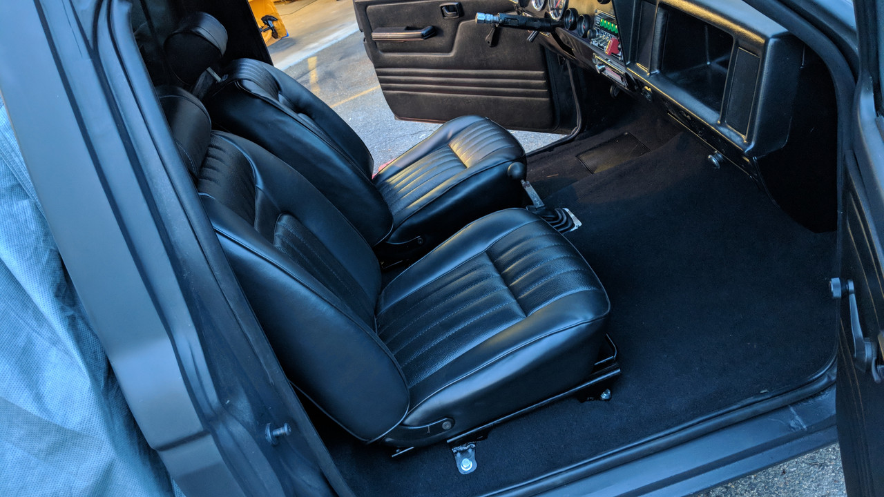

after that i took the razor knife to all the holes for the seats and seatbelts ( 12 in total) and cut holes in the carpet to line up.
lined up the seats, got the bolts through, which were a little tight going in, but i got them all in there. tightened them down.
and the seats are finally in.
gotta do the seatbelts next.
