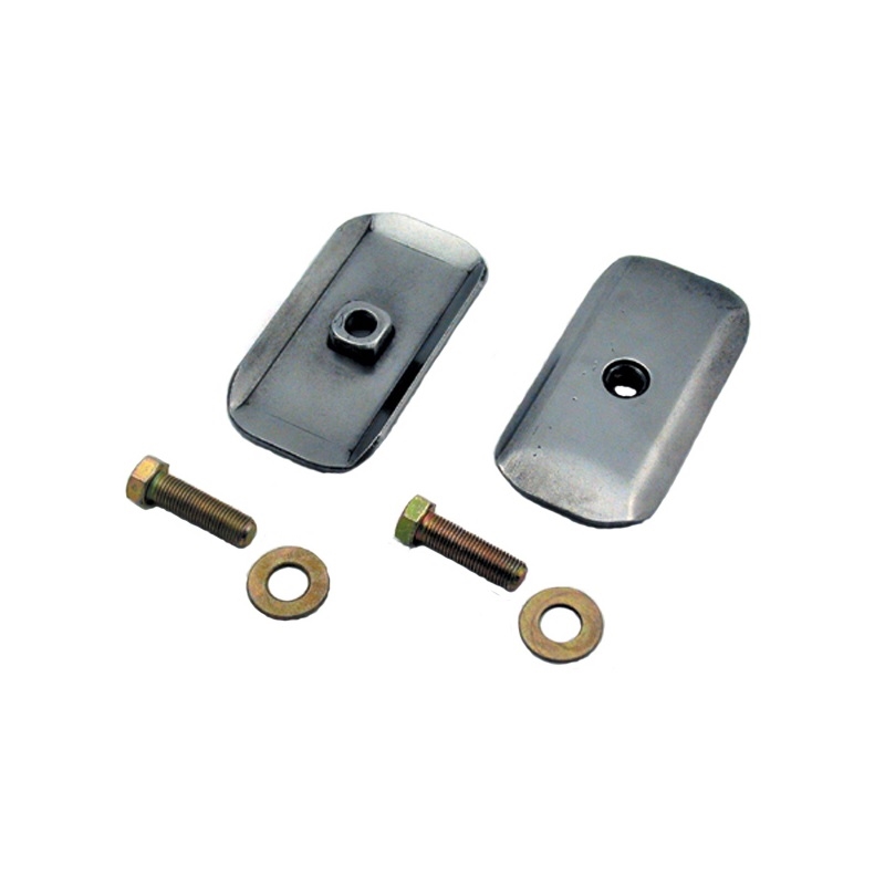

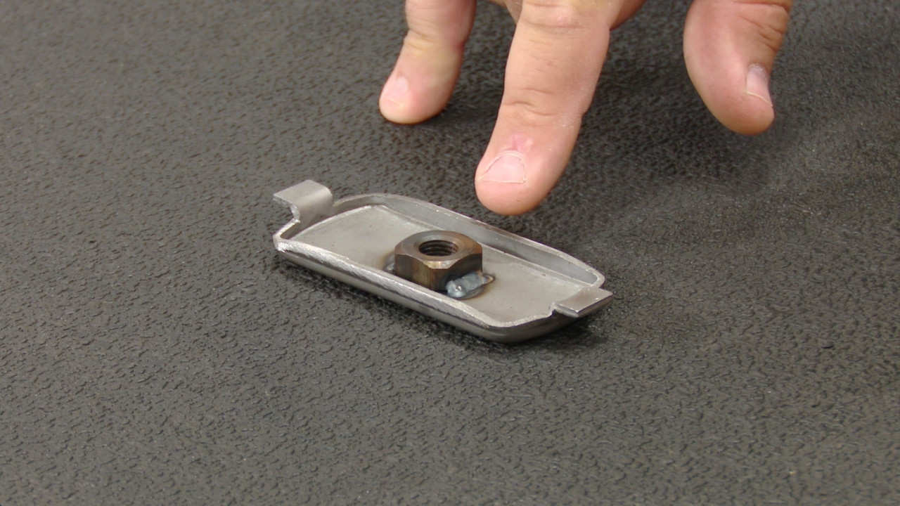

there weren't any reals structural bracing or supports of anything under any of the old seat mount locations before.
there were some small plates with bolts welded to them, seemed like a bolts welded to maybe 16 or 14 gauge sheet metal. nothing particularly structural. kinda looked like thinner versions of this
most of them were rusted/rotted out
i cut out all the old mounting stuff and hardware, filled all the old holes, and made all new mounting locations for these customized tracks.
i purchased 12 of these that i'm using for each of the 4 seat mounts and seatbelts
they're about 4 inches long, maybe 2 1/2 to 3 inches wide.
very thick steel. very heavy.

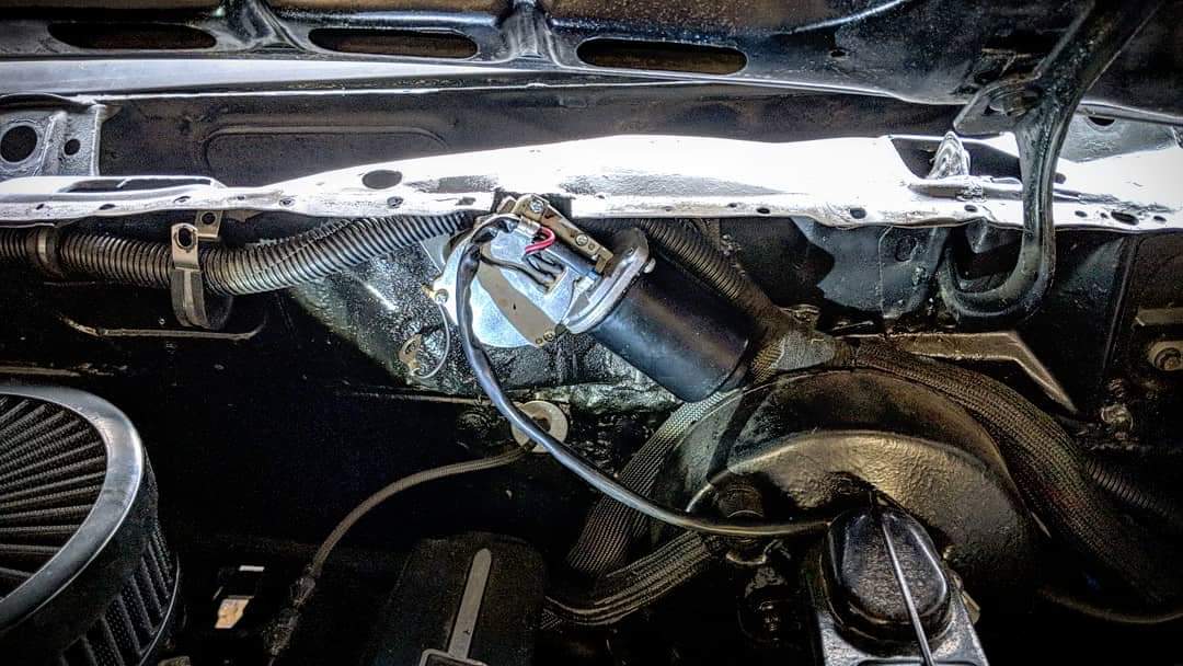

next was functioning windshield wipers
if you dig back to pictures from when we first got this truck, the wiper cowl had been cut off, there were a few holes cut into the cabin and into the engine bay, and the wiper arms were hooked up to the wiper motor via welded threaded rod.
i had a junk yard cut me off the cowl section from another ranger, ground it down, and made my own removable cowl for a 1st gen ranger, which is kinda cool. it doesnt look perfect, but its there. it comes off if i need to get in there.
but thats where i stopped. i never bothered getting the wipers working because, look at this truck. im not driving it around in the rain and snow. i lathered the windshield with rainex and said good day.
so now here i am, and i had to get the wipers working for the new much more thorough inspection.
so i bought a new motor, mounted it up where it KINDA looks like it should go? bought some used wiper "transmission" arms (thats what they're called apparently) and hooked it all up.
it works.
we are pleased.

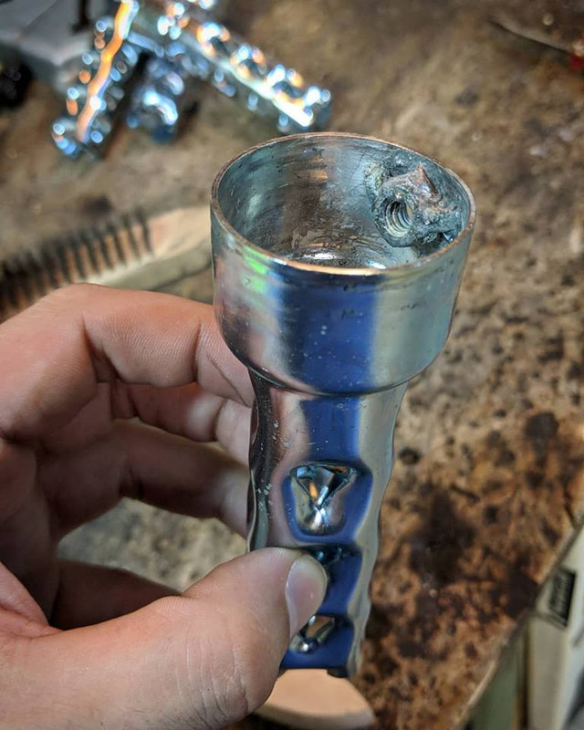

even after i put a pair of CarChemistry inserts in the header collectors, it still makes bystanders jump at startup, and sets off car alarms easily.
so i bought 8 motorcycle exhaust baffles
and welded nuts onto the inside
and put those in the tips, and tightened a bolt pushing out against the exhaust pipe.
they held. brought the volume down a good amount.

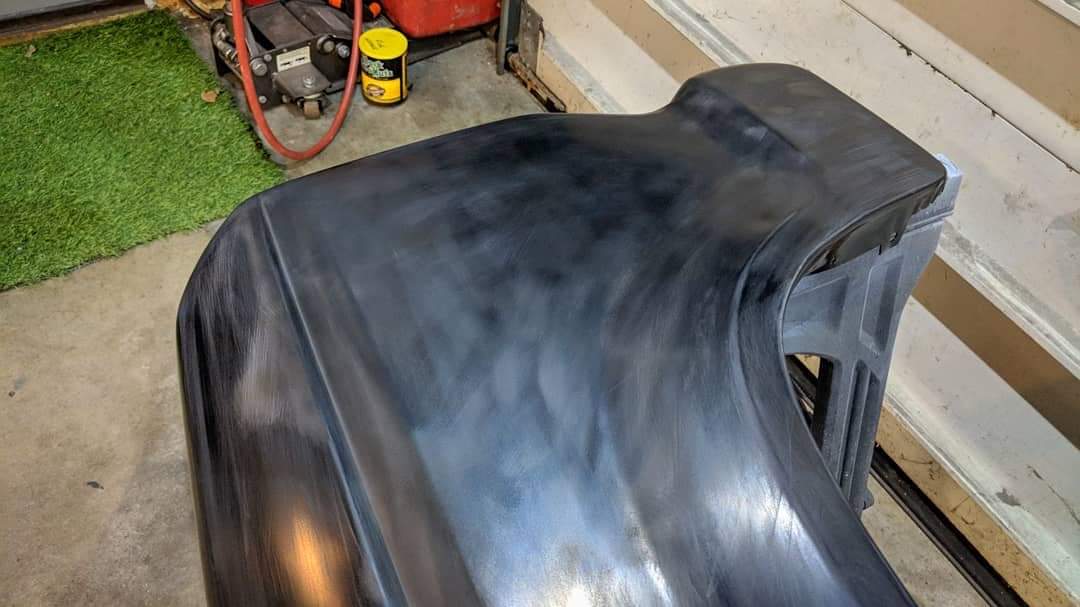

also, i did start work on new front fenders for this.
the fenders that are on there are BEAT. i literally just bondoed over the marker lights and repainted it, because they are so dented and mangled and bent up it wasnt worth my time to do right.
here is a picture of one of the New front fenders im working on. i cut a piece of sheet metal to fit in the marker hole. ground down the marker light mounting tabs on the back. welded it in. used some 3m body panel adhesive for filler. a VERY light skim coat of bondo to smooth it out. and allot of sanding and primer and sanding and primer.
it's as if the marker light was never supposed to be there to begin with.

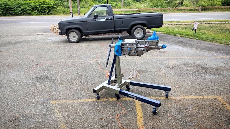

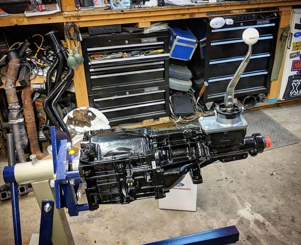

so on to the transmission.
i was weighing back and forth between whether we should buy a new z-spec t5, or a modified t-5 from G-force or Astro.
the truck makes just shy of 400hp at the flywheel. 395ish. and a little less tq. like, 390ftlbs.
stock t5 is supposedly good for about about 300ftlbs. maybe 315
the Z-Spec t5, which they put in 1 model year mustang cobra, and is a popular upgrade for foxbody guys, has mixed claims.
i've seen some sellers (LMR, CJPony Parts) say they are guaranteed for 330ftlbs
i've talked to some other places that say, no they're warranty'd at 330ftlbs, you can run 400ftlbs to 415ftlbs on them for years without any issues.
then theres the GForce and Astro t-5s. these are companies that take t5 casings, and all custom internals, and claim to back these transmissions behind 600hp with 500ftlbs running on slicks in a 3,300 pound car.
so,
with this ranger we are right on the brink of ... maybe its too much for a Z-Spec, but we really don't need the G-Force headroom.
also, the Z-Spec t5 is $1,800 brand new.
a G-Force t5 is $3,700
we talked to some guys. ended up talking to someone over at American Powertrain who basically said, there's guys running z-specs in the 10s, for seasons on end, with 450hp and drag slicks and 3,200 pound cars. we should be fine with 400hp in a light little ranger on street tires as a weekend joy cruiser.
so we bought the Z-Spec
painted it
put a new Hurst short throw shifter in it
and good to go
ended up going back to the ratty looking little stick and ball. the chromed out long hurst stick and white ball looked too nice for this thing
