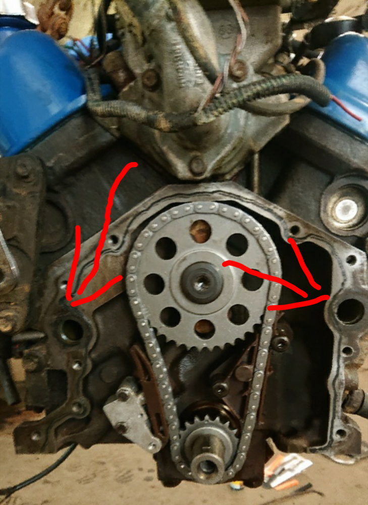

One possibility that gets overlooked:
Timing cover. There are two passages through the timing cover that have coolant "blow offs" that will push coolant out of the sides of the cover and onto the sides of the engine if they leak.
Those are the passages. The timing cover has vents cut in it to eject coolant to atmosphere in case of a failing gasket.
