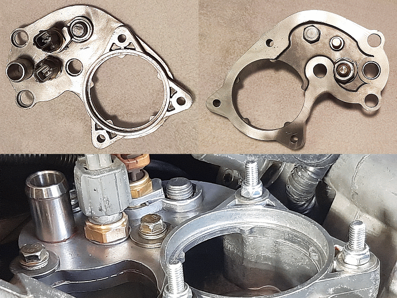

my application only uses 1 sensor. will this work?
Yes, just be sure to order the version of the Aluminum ThermoStat Housing
that has 1 TempSensor, pick either ClipMount or ThreadMount,
& appropriate RadiatorHose outlet routing, ForeHand or RightHand.
And worst case you can just put in a 2nd sender/sensor to seal the hole and not use it
...put in a 2nd sender/sensor to seal the hole and not use it
Or thread tap the soft aluminum & put a pipe plug or bolt in the extra hole,
as I did to move left TempSensor\ThermoCouple out of the way of left TimingTensioner.

got the old housing off. 2 of the 3 mounting bolts broke off 1/2 from base. cant find anything to grip the broken bolts. Been spraying with blaster and have been trying vicegrips with no luck. Thought about a propane torch but aluminum head is not a good idea. Any ideas?
...old housing off. 2 of the 3 mounting bolts broke off 1/2 from base.
...cant find anything to grip the broken bolts.
...spraying with blaster and have been trying vicegrips with no luck.
...ideas?
Cut away old plastic ThermoStat Housing with tin snips.
PenetratingOil soak broken bolts overnight, then try ViseGrips again.
If that dont work, cut bolt flush with engine block, small bit drill into broken bolt, use LeftHand remover.
If that dont work, drill out broken bolts & ThreadTap holes for slightly larger bolts.
AntiSieze for the next guy.
Patience + persistance needed.
