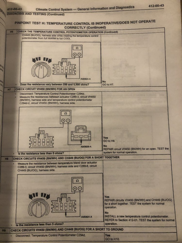

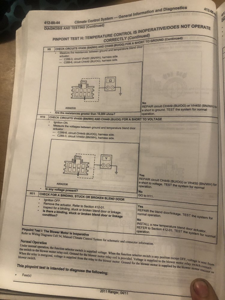

Here is the Diagnosis process for thermostat not working.

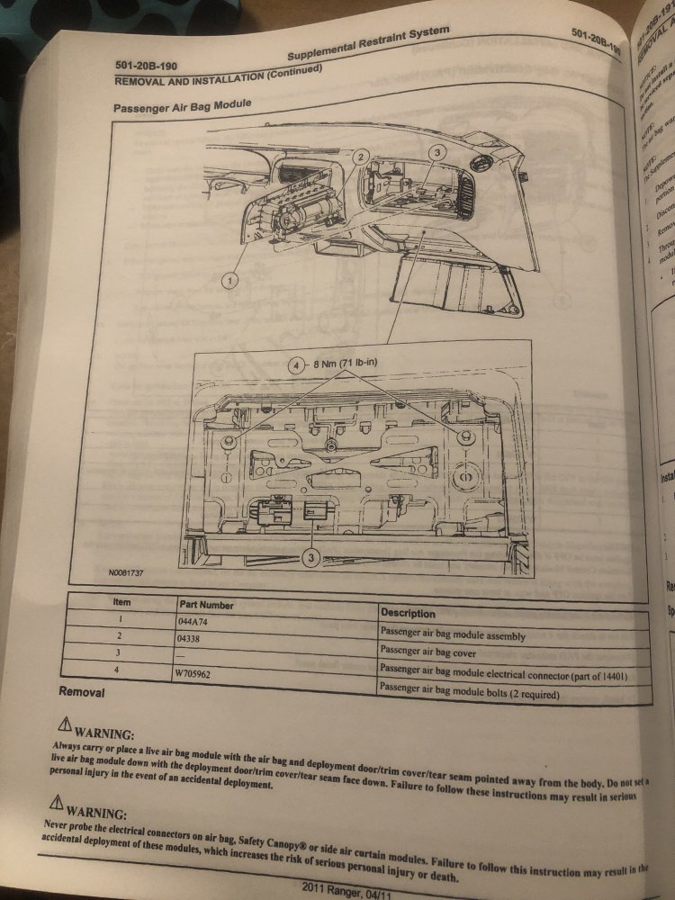

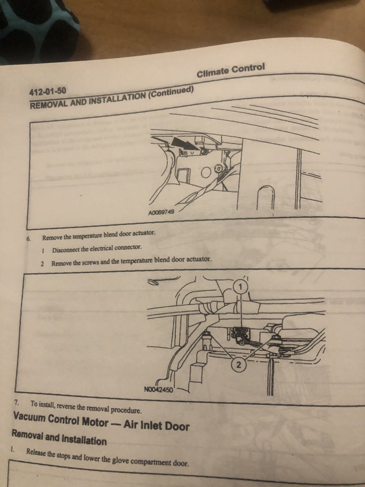

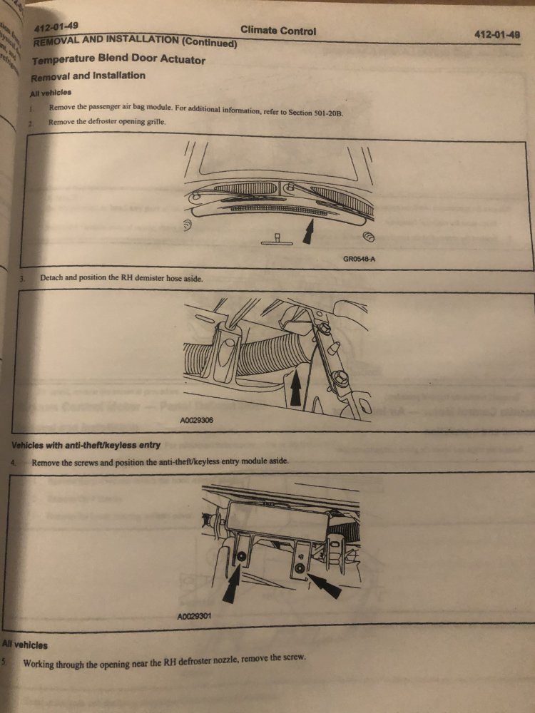

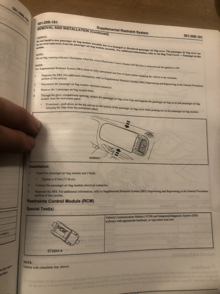

And here is the instructions for r+r of blend door actuator.
