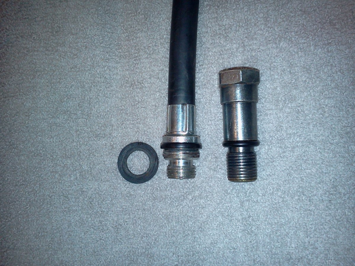

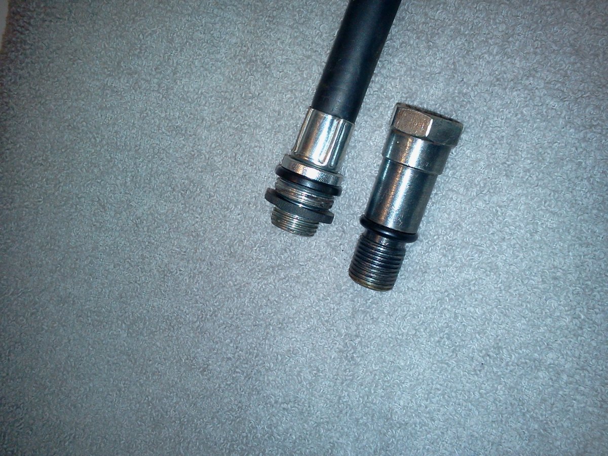

I have 4 Rangers. 02,03,04 and 11. All but the 11 have 3.0l in them. I need to run compression checks on all of the 3.0s but can’t seem to find the proper adapter to the spark plug holes for my test set. They set so deep in the head of these Vulcan engines they either don’t reach at all because of the hex head or are the wrong thread/pitch. Anyone know where I can get this thing? I even tried Ford Speciality tools with no luck. Any help greatly appreciated.
thread is 14mm x 1.25.
my hose has 2 sizes, the larger gets in the way on Vulcan heads.
both ends of the adapter are spark plug threads, M & F

mine is hte same as that and i got it at the local auto parts place /\
