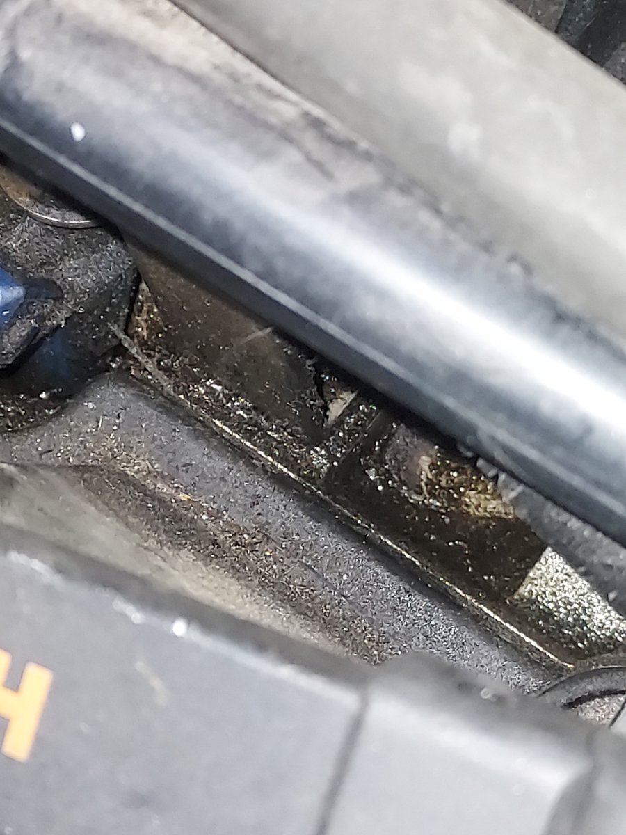

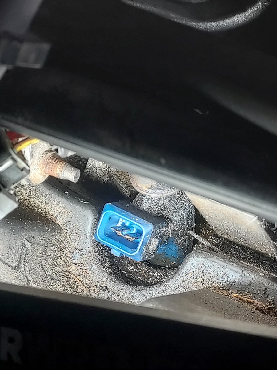

So update finally got around to putting a fuel pressure gauge on this. Key on, pressure almost 70psi, then drops to 65psi after fuel pump shuts off. As per PC/ED manual, it states 5psi drop after 1 minute is spec. After 1 minute, it dropped 4psi, but kept dropping after that. Think within 10 mins, it got to around 50psi. Went to next step to check fuel pulse dampener for fuel in the vacuum line. Well that is buried at the back of the fuel rail under the coil and a ton of wires and hoses. I can barely even feel it. So I checked where the hose goes into manifold and no fuel present. It then states to check injector flow rate/leakage. I was going to pull the intake manifold to check the runners for fuel. But I noticed the gauge stopped dropping and the condition appears to be not happening anymore (either I fired up the truck too many times and it warmed up a little or the heated garage I am in is affecting it) But I noticed alot of moisture around the passenger rear-most injector. I took a thin screwdriver and probed around down there and can smell fuel when I smell the screwdriver. And the body of the injector seems extremely dirty and wet. I will attach 2 pictures. Is it possible the rail to injector seal is leaking down the body of the injector, past the o-ring where it seals against the head, and down into the runner? Maybe an injector issue?

So that fluid was just from me hooking up the gauge and not an actual leak. But I removed the intake today and found a little bit of fuel pooled up on 4 of the 6 intake valves (the other 2 were opened) Thought it was odd but I cleaned out all the runners, put the pressure gauge on, key'd it on a few times and pushed it outside. 4 hours later come back out and it had dropped from 60psi to 10psi. I checked the runners and found none of them have fuel. Feel if I had leaking injector it would be be steadily dripping and the runner would be full. I went back to the pinpoint test for fuel pressure leak and it points to fuel pump module. The rough running did start after I put an OEM pump assembly in for an intermittent fuel pump issue. Now I've got multiple issues; rough running ONLY when it's cold soaked, fuel pressure dropping, smells like it's absolutely pouring fuel on startup, and the low idle. I did put a Ford IAC on but I have been unable to say if it has helped with it running rough. Pretty lost. Could fuel pressure be bleeding back to the tank? But I don't have an extended crank, and how could that cause it to run rough and smell extremely rich on startup? Just a reminder none of these concerns occur when the truck runs for a couple minutes. It will snap out of it. Any help is very much appreciated
