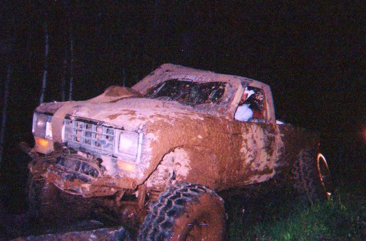

I've done a fullsize 44 swap years ago. Used stock buckets with 6" lift coils.
The mounts are only about 1 1/2" wider a side. With a tall spring it won't matter.
Can't really see much. But it's the only picture I have of the front end.
