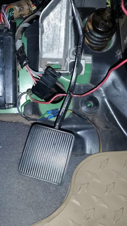

After looking at many pictures and videos of other pedal assemblies, I'm thinking now that I either have a very bent clutch pedal or the wrong one altogether.
You can see in the attached picture that the clutch pedal is angled sharply away from the brake pedal. Note that I've now removed the master cylinder. This did not affect lateral movement of the pedal. The pedal does not move side to side.

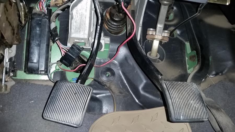

This is where it makes contact with the floor:

Ah, yes, the old bend the clutch pedal arm trick...
Well, they are not that hard to change...since you have it apart might as well try to pull it out...maybe you can straighten it with a bit of heat and hammering...reinforce with a short piece of metal and call it a day.
There is just a lock washer on the side near the accelerator...knock that off and slide it out toward the driver side...I had a bit of a time with mine because it was a transplant but yours should have enough room to pull it without any major teardown.
